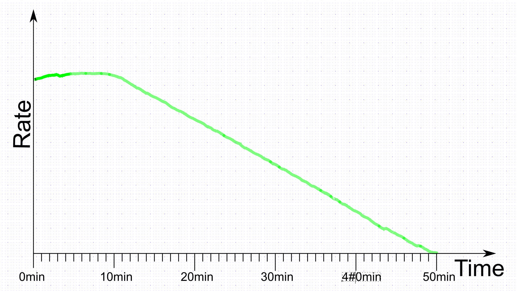

It is apparent that the 7S26C is experiencing periodically higher resistance to delivery of power.
If we knew some details about the frequency and duration of the period of higher resistance, we could combine this with knowledge of the movement's design to guess where it might be, because we know how many times per hour each wheel turns.
This is a shortcoming of the otherwise quite darling LCD timegrapher. Sometimes it is better to have a log over a long duration.

I've attached a PDF Page 9 titled 2.2.2 Display Mode Trace. Their demonstration pictures aren't the best but you get us started and I'll see if I can find a better image to make a point.You notice there showing initially a really short time span a lot of variation all watches will have variations like this. Gear train's gears have power fluctuations all gears do the watch will never typically show them including typically on a timing machine as they get averaged out. On the next page you can see the amplitude of the time fluctuation this is what gets averaged out you'll ever see. Notice this is a reasonably high grade watch because the fluctuations are really small if you run one of these on a Rolex watch still be really small or Hamilton 992B has a really tight timing like this other watches they can start to look much worse and yet it's not exactly an issue because it's just the quality of the watch
Other things useful in a really expensive timing machine is the oscilloscope mode they show it on page 11 although? The next page where it shows it like the 400 ms setting the timing machine that I use at work as this Senate 400 ms it's better because you can see the spacing between the escapement sounds. This is where if you had a hairspring rubbing issue providing it would actually make a noise of its gently pushing on the balance wheel it doesn't always show up. But just because you see a noise on the oscilloscope doesn't mean it's easy to figure out where that noise is coming from.
Then another example of what the time trace future looks like image attached. The amplitude probably isn't right because the lift angle wasn't 52°. But here you can see the effect of the center wheel meshing with the mainspring barrel that's what the longer issue is. The faster one is one of the other wheels. This is a situation where this would average out on a timing machine you would never normally see it.

Thans for the plot!

I took now a lot of schreenshots from timegraher - less than 15min. I know, thas not enough to see all but eaven in this data, I see maybe something like a pattern. I will put it together and than I will post it here in a view minutes...
I did a measurment up to 50min. The movement starts with a rate of ca. +20s/d and ends at -45s/d. The amplitude fluctuated between 169° and 191° - the mean time it was about 176° - less then yesterday . I started with a full loaded main spring today, too. On detail I saw a little pattern wich repeats ca. all 10s. It was visible in nearly all frames.
