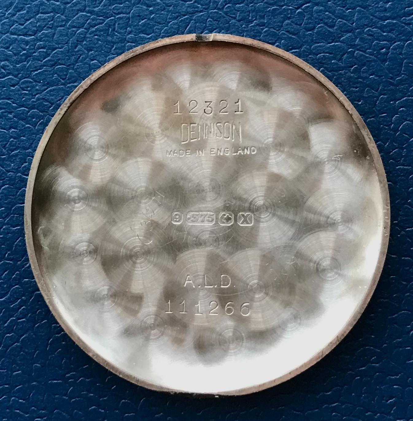

15 hours ago, Myron62 said:
Anybody know anything about Rone watches.
If you type that in Google, the 2nd or 3rd hit are (other) forum topics about these.
Anyone recognise the movement?
It's a FHF, which exact designation I can't say because they changed bridge layouts all the time and even custom marked as this one.
I recognise the movement, yes, but not able to recollect the precise calibre. I’d agree that it’s likely an FHF Swiss movement. Yours is in a quality 9ct gold Dennison case, hallmarked in Edinburgh I believe. I’ve restored about four Rone watches in the past couple of years and they’re very nice vintage watches, often with attractive dials like your one. Well worth servicing and keeping in memory of your father in my opinion.
Edited by AdamC
Great, i'll give that a go
Agreed, its a good looking watch. Now i know its an FHF movement, thanks.
The Rone fifteen above is a very distinctive and attractive looking model.
