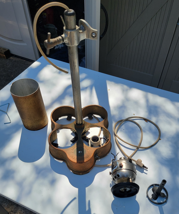

Here is one of the three machines I acquired.  It is labeled "L&R Special" which is not something I have seen.  The motor works!  I took it apart and cleaned it up. I have ordered a rheostat and knob (old school).  It appears to me that the heater is a light bulb retrofit as opposed to a 200 ohm resistor as in my working L&R.  Anybody seen a light bulb heater in one of these?
I have all of the jars and lids as well.
I found a 60W heater that fits an Edison socket.  I think it will work fine.  I am guessing that the tube on the left is some kind of aftermarket retrofit...does not look or feel factory.
Here is an update on this machine.  I have cleaned it and repainted it, cleaned up the motor and oiled it.
As you can see, there is an Edison socket for the heater.  Not sure what was done before, but I found a 60W ceramic heater that might work fine.
Next up...rheostat.  I ordered a 500 ohm 50W one and was not happy with the size nor quality.  Since I had a 125 ohm 25W (rated at max current of 0.447 A), I investigated whether that would work.  I measured the motor current driving it with 50 volts (that is all I have in my lab), but noted that the current is pretty much constant under no load conditions at around 30-50 volts.  Not sure if that holds at 110 V.
In testing, I found the motor just ran too fast with 125 ohms so I needed more resistance.  I looked around the lab and could not find any suitable power resistors (hey...I am an IC designer dealing in micro watts, why do I need power resistors), so I had this crazy (and perhaps dumb) idea, just run the whole circuit in series--motor, switch, rheostat, heater.  The heater gives me some IR drop and also provides heat (not the 60W that I wanted).
Anyway, for now, I am going to leave it at that because I am going to replace the switch with one having a smaller footprint.  In the mean time, I will look for a power resistor.

I just pulled the rheostat from the other L&R machine.  It appears to be a factory unit.  It is 750 ohms.
