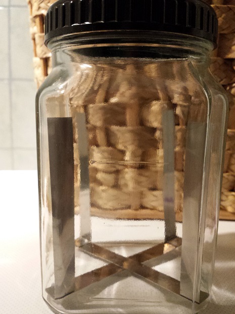

Drifting slightly but relevant I think. I have noticed in various photos and descriptions of machines inserts in the jars, called wave breakers by some. From what I've read they are there to disrupt the whirlpool effect created by the basket spinning, and also to help pull the dirt away from the centre. They sometimes look like mesh around the edge of the jar, or very similar to pastry cutter star shapes on the bottom or sometimes just pieces of metal inside the jar. Does anyone have any information about them? Any photos? Where to get them? How to make your own? Thanks.
Stephen
Jar belongs to Elma Super Automatic which I acuired recently, its in very good shape, all functions are working fine. Im looking for service manual in English, I received one from Elma but its in German which I dont speak...
