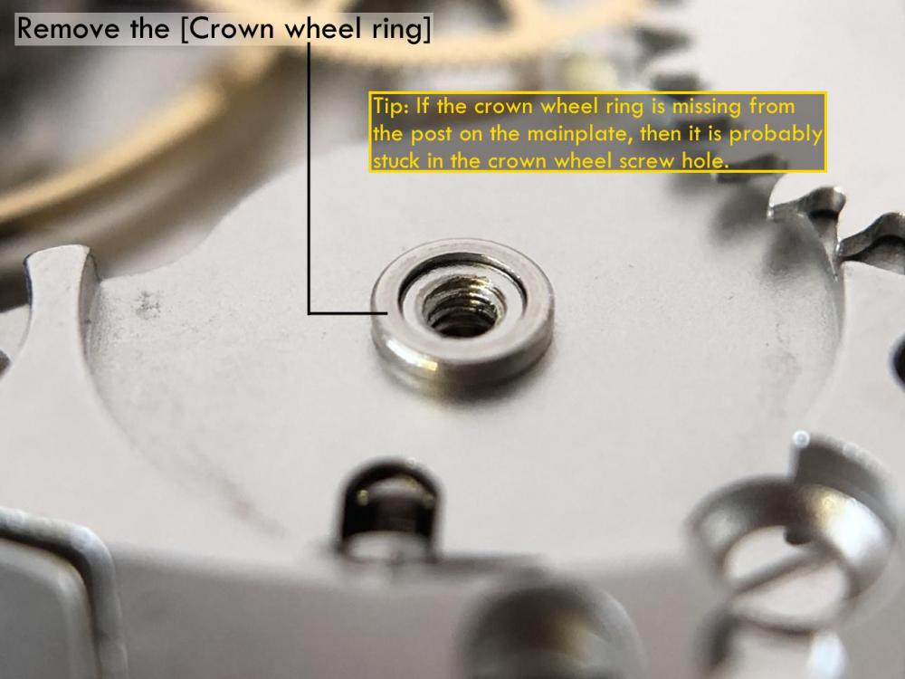

I always wanted a mechanical (wind-up) hi-beat watch for myself. Eventually I found a black dial military style Hamilton Khaki Mechanical on eBay housing an ETA 2804-2 for a reasonable price as it was in need of a service and some repair.
The ETA 2824-2 contains nothing surprising or difficult to handle. It’s an easy movement to service and doesn’t contain any tiny springs that can ping, not even the click spring. Overall, the ETA 2804-2 is a very solid and precise horologe.
This walkthrough isn’t a tutorial but is primarily meant to be a help for determining what parts goes where. That said, I have included ETA’s oiling suggestions and a few of my own suggestions and tips here and there. ETA’s technical communication for the 2804-2 contains a few contradictions and oversights (such as omitting oiling of the pallets), but hopefully not so this walkthrough. However, if you do see something funny or have any questions please get in touch.

That’s a great guide! I would only add that you should be very careful with the incabloc on the main plate, and place a small piece of rodico in the gap indicated by the arrow, when moving the shock spring. The incabloc shock spring can fly out of that gap when you move the shock spring.
Thanks! That's good advice and would make a nice contribution in a tutorial. Personally I support the anti-shock spring with a piece of peg wood.
