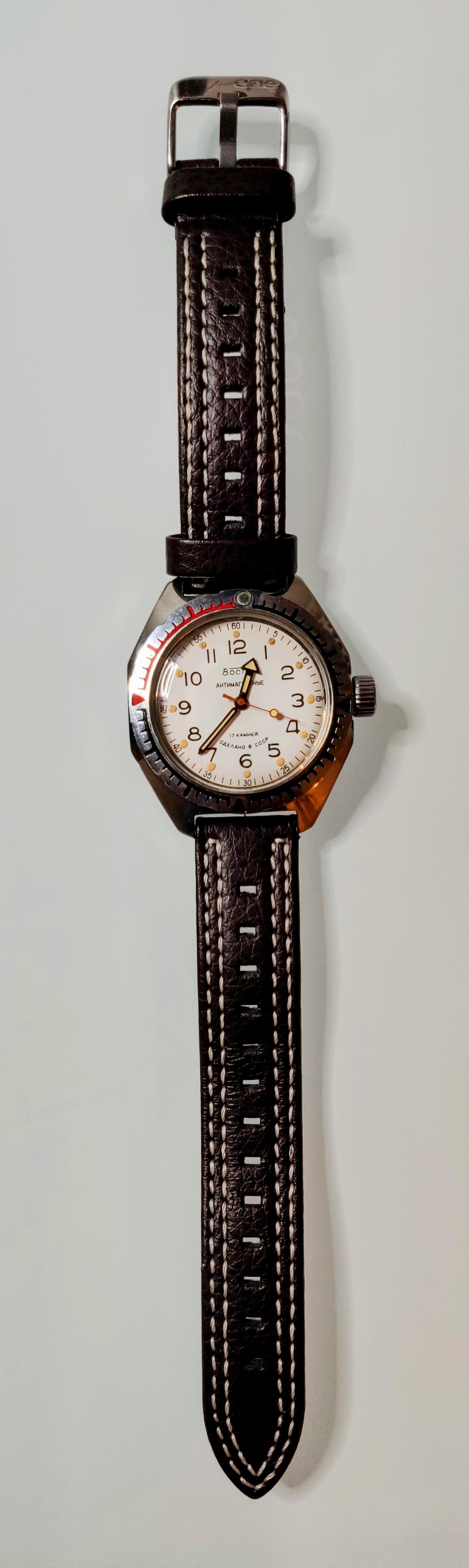

Vostok 2414 service
Hi
I've finished to service this nice watch,
when I've brought it the movement was stuck at all, The mainspring was fully winded but the watch wasn't running at all.
After service I got at timegrapher :
  • -15s lost
  • amplitude : 238
  • Beat error : 0.3
Not perfect but I'm happy of this result regarding that I'm a noob.
I join a LINk to show you the disassembling photos may be it can help someone else
Thanks
Edited by richiesgr
add photo
