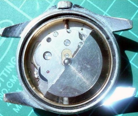

Right, here we go! And before anyone says so, yes, I should be ashamed of mistreating a watch this way. All I can say is I was young and careless!
Well, it worked!
I stuck the nut to the watch back and left the watch on a sunny window sill where it warmed up nicely.
After an hour I put it, nut side down, on some frozen sausages that were defrosting in the kitchen. Yes, I forgot to photograph the sausages! :rolleyes:
Anyhoo, with a slight temperature differential case to back, I applied the spanner (wrench for our colonial brethren) and good ol' Bob was my uncle! Thanks Bob!
The innards turned out to be a Brevets SIC39 movement and were remarkably clean given that the stem was bent, see the photos, and rusted internally and the seal in the crown was just black goo. (Anil, I swear I haven't had acetone anywhere near the watch!)
The main gasket was split into three or four sections through shrinkage but not too gooey so cleaning won't be too much of a problem.
There it is! Another watch for me to play with when I get a proper bench set up.
Thanks to all who contributed and encouraged.  huge-thumbs-up-smiley-emoticon.gif
NICE!! Congratulations on a job well done!! John that movement looks like a BFG 158 31/7 of which I have many many spare parts of every sort (including balances). You've already mentioned it was a SIC 39? I've never heard of that particular movement in a Sicura, but who knows? It sure does look like a Baumgartner 158 31/7 with 25 jewels which means they've included some jewel caps for the pivots and probably a jeweled rotor bearing for the auto-winder. If I could see the balance I could tell for sure--Does it have a KIF shock system? It is shaped like a little triangle. In any case, If you need any parts, just send me a picture of it and you can have it for free--just pay the shipping. I have entire movements so every little screw, spring, and lever is available!
