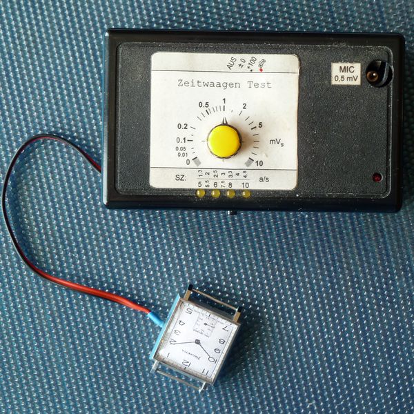

Already happened! I built such a device years ago, though not quite as chic as Witschi's. It not only is able to test every aspect of TMs, but can test a single microphone, too. Essential for repair and development of timing machines ?

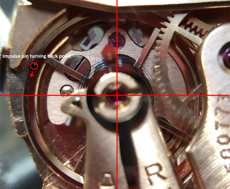

Today I made a small black mark on the balance wheel rim exactly where the impulse pin is located and recorded a slow-motion video of it. Unfortunately, it no longer seems possible to upload iPhone slow-motion videos to YouTube. So, I paused the video at the turning point where the balance wheel stops and took a screen shot of it (image above).
In the image the balance wheel has just rotated clockwise and has come to a full stop before beginning its anti-clockwise rotation. As evident, at this point the balance has travelled well over 270 degrees from its position dead centre between the banking pins. The amplitude may not be 300 degrees but not far from it. So, it appears that I made a good job servicing this beautiful movement after all. If you feel like it, you may now congratulate me! ?
