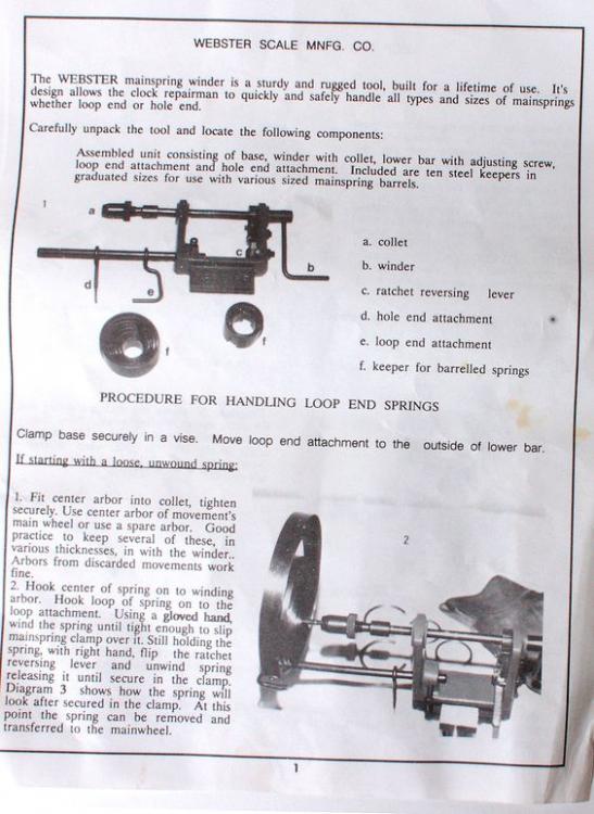

Hi, i am trying to buy a winder that does barrel and open springs why is it so hard to buy one in the UK ,cousins is having trouble getting hold of Ollie Baker Style winder and to get them from US are expensive i have tried searching the web with no luck , can anyone recommend a company in UK that does them.
Build your own as stated above, The Ollie Baker supply issues are a bit of a joke they have been continuously out of stock at Cousins for years they occasionally become available but if you dont spot them on the day they go on the site you wont get one they go that quick.
The Ollie Baker is a pain to use anyway with small barrels and very large barrels anything in between is o.k very large Fusee barrels are a real struggle and a feat of strength because you have to grip the barrel as you tighten the spring up to get the sleeve into the barrel and they are even worse when trying to get the spring back in the barrel , I have a Bergeon winder that I use for putting fusee springs back in.

They are good mainspring winders but there are some glaring faults in the design, you have to grip the barrel in your hand to tighten it, they supply a jubilee clip that you are supposed to put round the barrel and tighten there is a bar on the winder that you wedge onto the jubilee clip to hold the barrel as shown below:
This is a very bad idea you are putting strain on the clip in the very place it is not designed to be strained the strength in a large spring would cause the clip to fail. I have spent my working life in the chemical industry and Jubilee clips used to be a fairly industry wide way of connecting hoses we stopped using them in the early 90's because of high failure rates.
The hooks on the Ollie Baker for holding the hole end of the spring as supplied are too straight you have to be very careful they don't slip out the hole when tightening the spring up to remove a spring from the sleeves.
Some times the opening for the barrel is on the opposite side of the barrel to the one shown in the picture that leaves very limited room to get the sleeve in the barrel.
I would just say they are good but not perfect.

Can i ask your opinion on Bergeon 4126 are they any good they are a lot cheaper, i would prefer to buy one then make one put if thats the only solution i will have to go down that route
Hi Willow As wls1971 said holding the barrel in your hand using a jubilee clip on a stop is a dangerous. The Ollie Baker pattern is the same but no stop just your hand. The DIY uses a clamp to hold the barrel so no hands, and the attachments for loop ends and hooks are made to suit your own tastes. Of course there is also the webster mainspring winder see attached, but its get from America.
Hiya Willow
I'm currently(I should say we!)working on an anniversary clock and came up against the mainspring problem. Unless you're dismantling and repairing clocks exclusively, the winders are very very expensive and hard to find, but they are out there. The 'Bay has a few, and I actually found a Keystone, and a Bergeon out there when I looked a few minutes ago. But soooo expensive. So, when I get the time I'm going to build my own, as I don't see myself doing just clocks. They are fun tho.
IMHO.
good luck!
BTW Bergeon 4126 apparently would work. Hippie uses one.

Hi Mike That was designed for the 400day/anniversary clocks but with the right retainers will remove other clock springs, The DIY versions of which I have built two and moose has built one do the job admirably, Fusee clock springs need a beefier version
My bad. I thought he was looking for that specifically. I remembered you built some that were well done.
19 hours ago, watchweasol said:
Hi I forgot to mention there is a full set of plans on the site (supplied by Joe Collins) for you to make your own should you choose to do so.   If you cant find them I have then stored on the laptop.
Yup. I posted them and have them saved on my laptop as I plan to build one myself.
