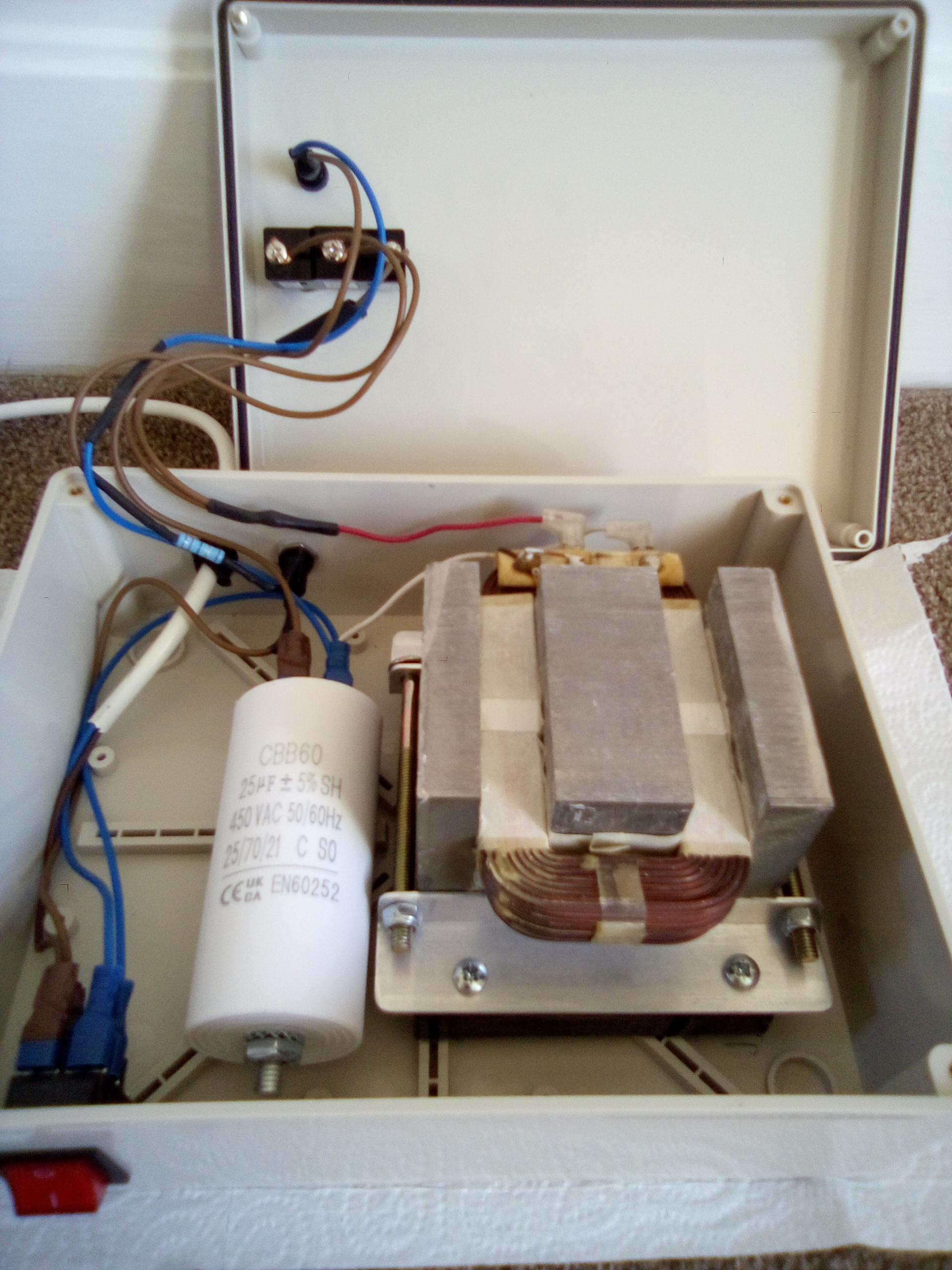

@Endeavor: -Yes, but your version takes a bit of "skill" to get to work! :)
The versions with coils work with distance attenuation - the field gets weaker as you move the part/movement away from the coil.
The automatic ones often use current attenuation, the field gets weaker around the part/movement  so the part can be still.
(picture from: https://www.j-ndk.co.jp/en/product/index_datsuji.html)
In my version a capacitor is charged (takes abt .3s) and is then then is used in a parallel LC-circuit that takes abt. 50ms for the field to go  from fully charged to zero. (depending on capacitor values, voltage and size of coil).
The biggest plus is that you do not need to lift/move the movement in the coil/field and the results are equal time and time again! :)

Thank you for the additional information :)
I now also understand again how the coil / capacitor circuitry works. Where I was initially a bit puzzled about was what kind of capacitor was used and therefor whether the AC was first converted to DC. Now knowing the L/C principle again, it may be wise to put up a schematic of your system with the details of the components. We don't want somebody to grab an electrolytic capacitor and "blows the place" or seriously harm himself....... The modern electrolytic capacitors do rupture, or have a relief-valve, but the old ones don't, and they take off like a rocket when connected to AC or hooked up wrongly to DC. (don't ask me how I know :biggrin:)
So if you have a simple schematic of your system with the components details, then at least that part is covered ;)
