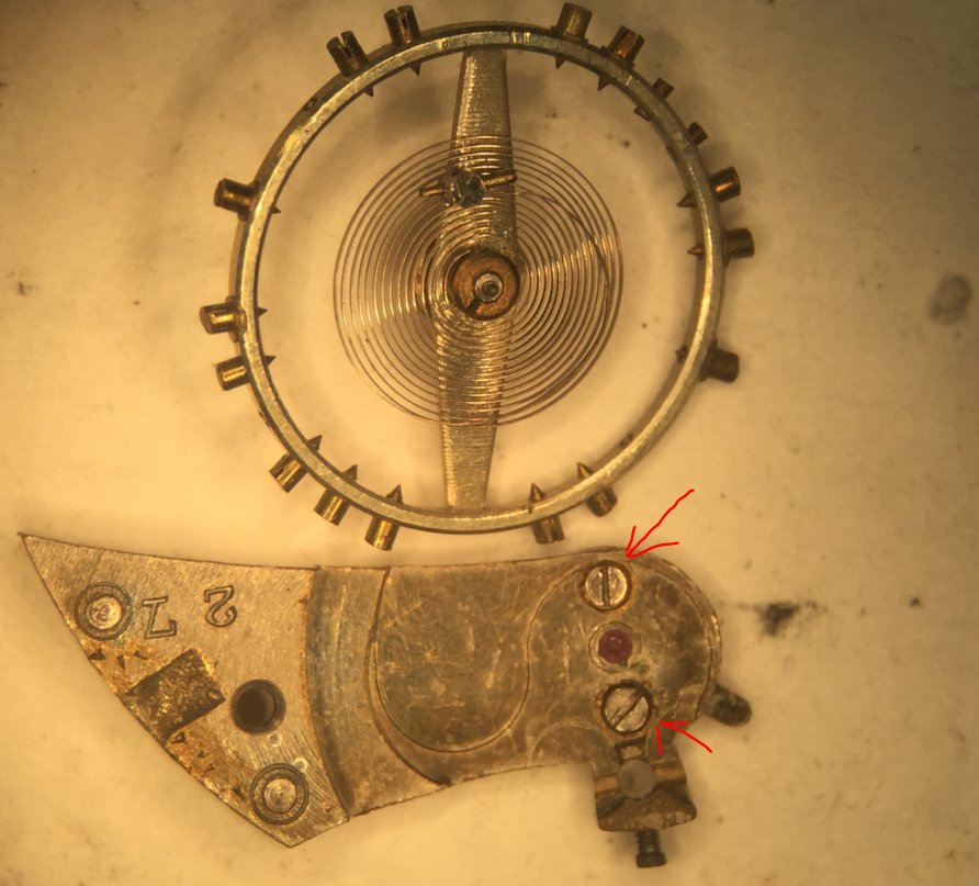

You did not remove Top balance cap jewel for cleaning and oiling? If that's so - this is the issue! Hole Jewel and Cap Jewel must be cleaned and oiled (top)
No.  I don't know how.
And that wouldn't explain why it would be working before and then not working after a second teardown.  ?
That's very easy. Stay on-line for a few minutes - i will search my photo library (not the same watch, but same idea). Will post some photos in a few moments.
2 minutes ago, Negot8or said:
Thank you!

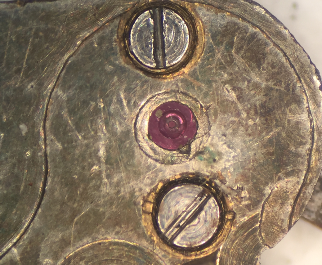

You will need 0.5mm screwdriver ? to remove two small screws to release top / cap jewel. Just make sure to remove the hairspring (one screw) to avoid any damages while removing these two tiny ones.
Clean both, hole and Cap jewels (peg-wood gently, soft brush, then place a tiny drop of light oil on back side of the cap screw, and install it. Flip the bridge, secure both small screws - you are done!

13 minutes ago, Negot8or said:
Makes me REALLY nervous about messing with the hairspring given my inexperience.  I suppose there's no time like the present to learn.
You are NOT going to mess with the hairspring at all!
Remove the balance and place it upside down
Loosen up Balance Cock screw (side) by a turn or two (do not remove it completely) and separate the balance from balance cock
Now you gained access to those two screws
Edited by Poljot
Loosen up Balance Cock screw (side) by a turn or two (do not remove it completely) and separate the mainspring from balance

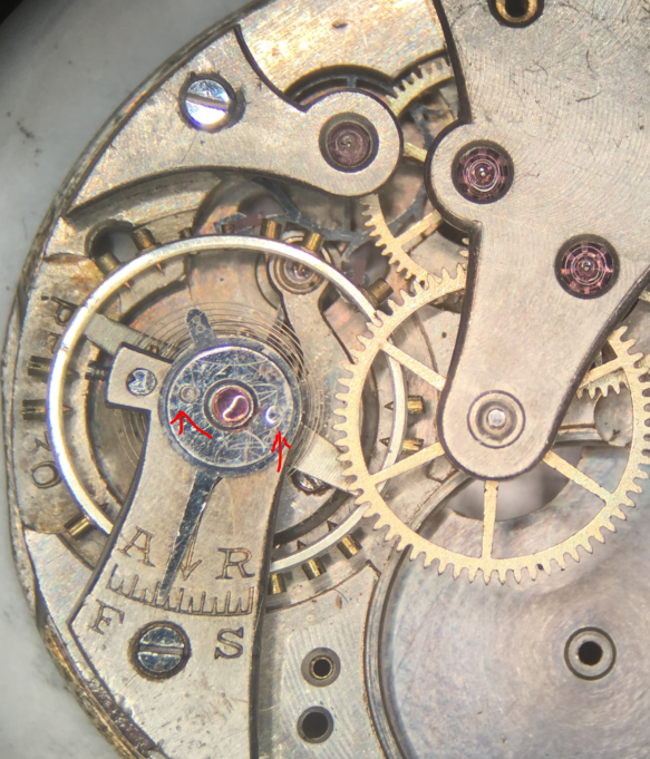

On 11/29/2020 at 9:40 PM, Negot8or said:
 The balance just stops after a few ticks.
I realize how nerve-wracking this troubleshooting saga can be for you, especially if you do not have a microscope. So many "little" details can prevent your watch from working. Even after proper cleaning and oiling of balance jewels, you will have to properly install balance (hairspring in relation to regulator pins as shown below, both pivots of the balance staff must be visually inspected to make sure they are not bent or broken, etc.
