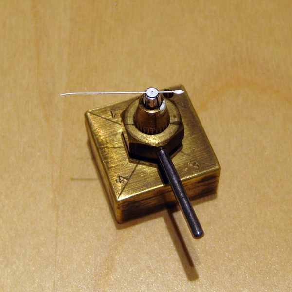

I use this for chronograph hands:
Made from a small pinvice, it works sensitive, fast, repeatable and takes least room in the drawer ?
With the Bergeon tool I am concerned if the procedure will be durable. It makes a small constriction on the tube and does not narrow the whole tube - what I learn from its description and drawing.
Frank
Frank

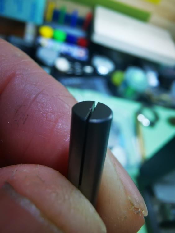

Hi there Praezis, that's a handy second hands tool you have, as you say doesn't take up much room. The bergeon tool is made for tightening the whole pipe of hands and you can also tighten crown pipes and case tubes. Here is a photo of inside the smallest collet 0.40mm. The tube section where the hand fits is about 4mm long

Hi Frank, looks like they have changes the design, this tool is the newest version and it will tighten the length of the pipe. Especially good for Seiko 6138 chronograph, to be able to use the same centre seconds hand. You need to round and tighten the tube to place back at zero. Also flyback chronograph, and any other hand. Cheers Frank
