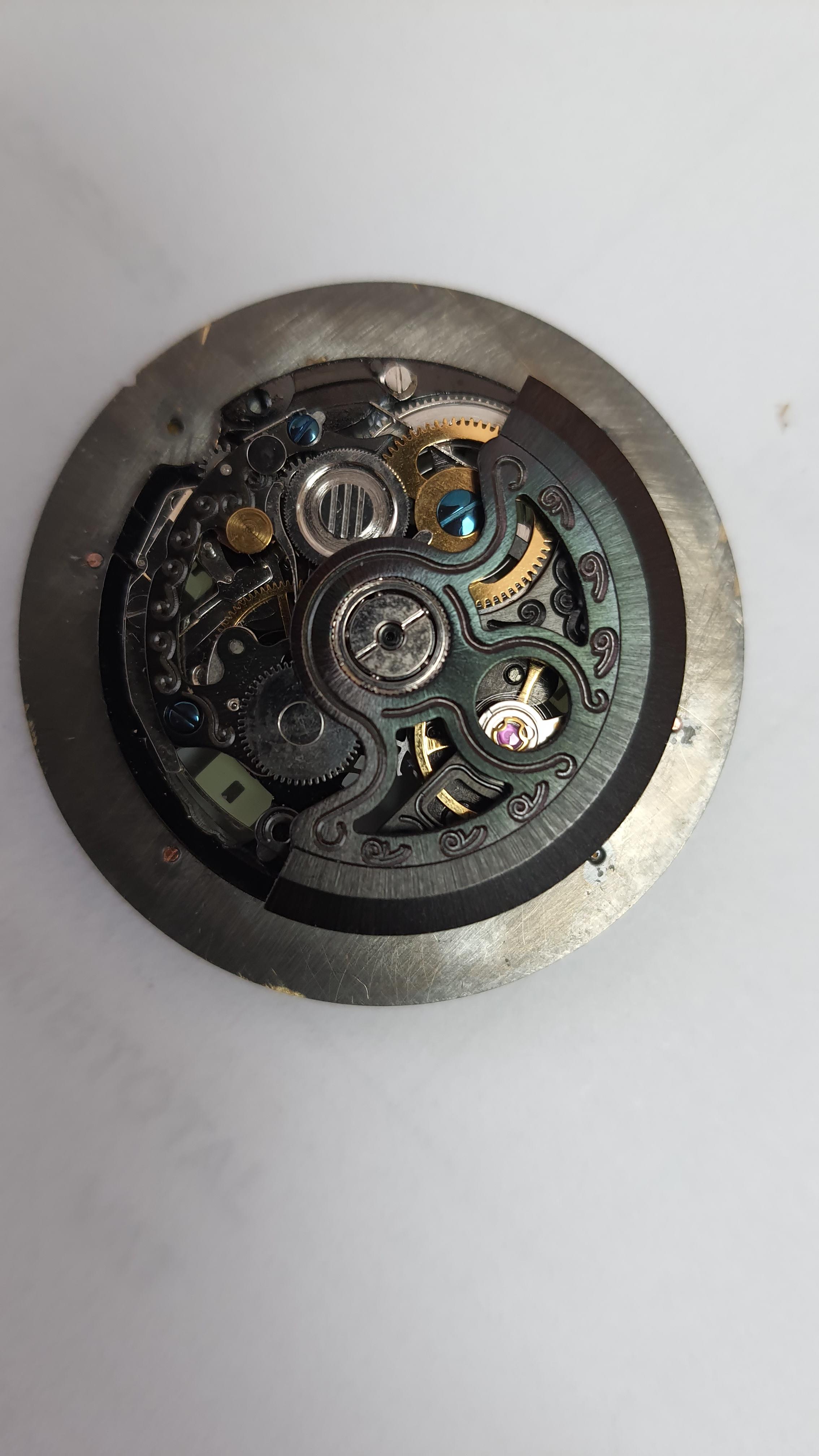

Amplitude still seems low, but I'm going to let it run in a bit and revisit. Meanwhile, got the first layer of the calendar works together and made sure the date ring snaps to both in quickset and regular setting. The mechanism is pretty cool, so I took a video. -
