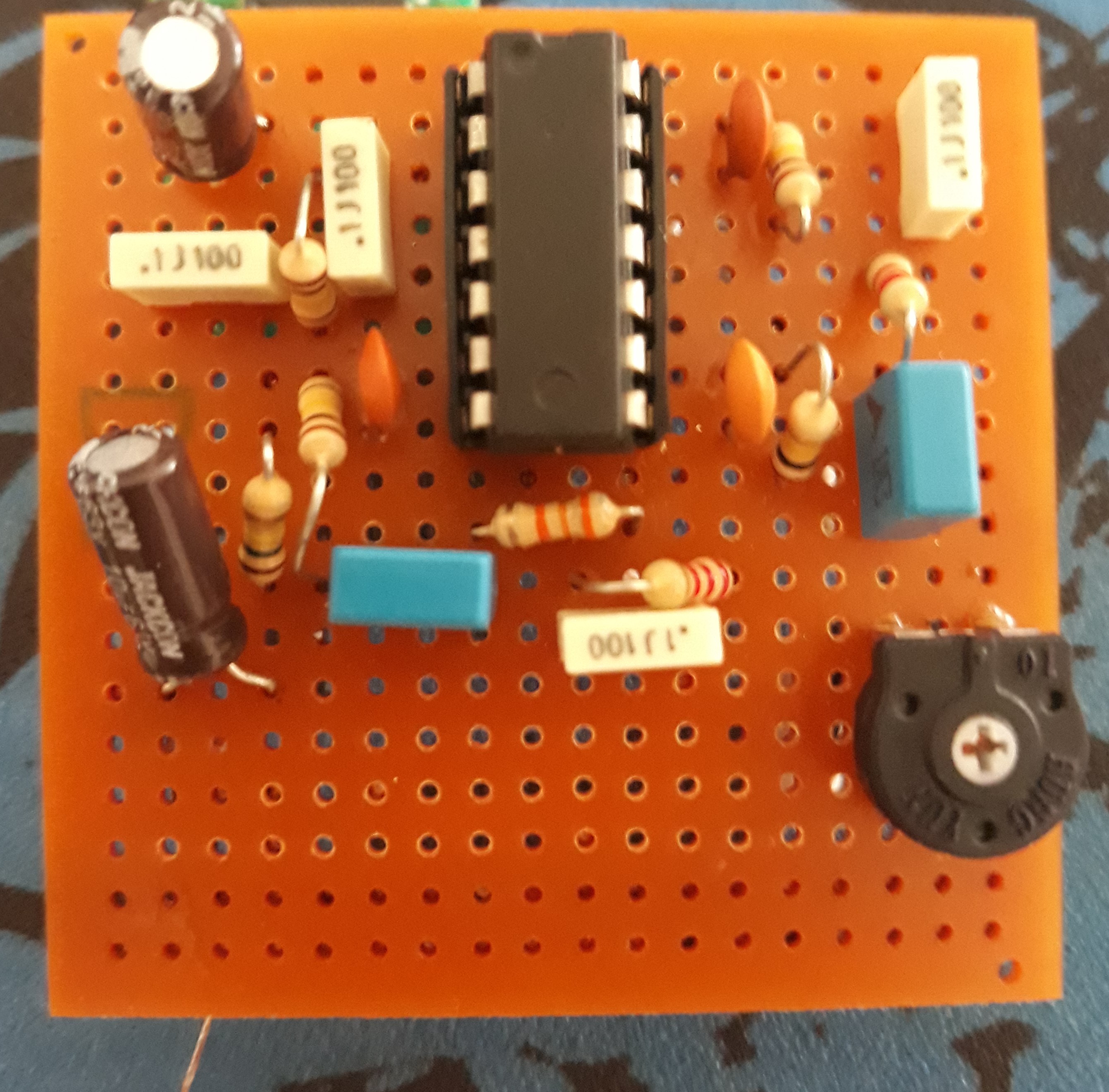

I got the components and sat down to make the circuit but the I realized I have no idea how to read schematics and make circuits so I had to watch some videos and read about it.
the first version  looked terrible and had a really really high noise so I thought to my self "I messed this up gotta start again"
so I made another one which to be honest looked better than the first one (to me at least) and I was a little bit proud of my self :woohoo-jumping-smiley-emoticon:but the thing is I didn't work either and had the same really loud noise I checked all the connections and everything seems to be fine I don't know what could be causing this and this is why I'm posting this long boring post.
I tried pulling the laptop charger off and even tried two more laptops but it made no difference.
can you guys tell me what I did wrong please?

That sounds like mainly hum to me - this is interference caused by EMI. The only way to shield against this is to put your circuit (especially the piezo transducer and the wires attached to it) inside a metal case which is attached to the circuit’s earth connection (likely the negative connection of the battery if it is battery-powered).

thank you much for you encouraging words, I tried putting the circuit in an aluminum case i had laying around and the noise decreased dramatically the back and front of the case are open I don't know if that makes a deference I'll get a proper one later  as to the power I' using a 9 V battery as shown in the tutorial to avoid the noise you mentioned, I'll go over the soldering tomorrow and clean it u p and see what happens thank again
I'll work on it tomorrow I tried something out today and it kinda worked thank you so much I have attached a new sample ain the previous comment if you want to check it out

Noise is always present in any analog circuit. Amplifiers amplify, so they amplify the signal and they amplify the noise. The trick is to keep the signal to noise ratio acceptable. Since we only have the noise here, it is a little difficult as @rodabod
pointed out, to tell if the amplifier is noisy, or if we are simply hearing very low level noise amplified.
A high end HiFi amplifier works in pretty much the same way as a cheap one, the only real difference (apart from the sales speak and the eye watering price tag) is that the high end HiFi amp has higher fidelity.
This means that it has a better signal to noise ratio, and produces less distortion than the cheap one.
In this case, the most likely cause of the noise is one of the following.
A nearby mobile phone.
Switching noise from the power supply powering the amplifier.
Switching noise from  nearby light fittings, wall warts, LED lighting power supplies or whatever.
It sounds too "dirty" to be simply mains hum, but it does appear to have a low frequency component, so mains hum may be a part of it. There is no big low frequency hump at the left of the spectrum though.
VLC's simple spectrum analyser is pretty crude, but it does show the noise is fairly broad spectrum.
I don't have anything more sophisticated to hand, but my gut feeling is that your amplifier is working just fine, but without a useful input signal it is amplifying all manner of the usual junk found in the local electrical environment.

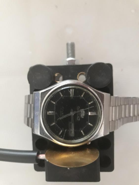

Guys I did it it's working I cleaned the ground soldering and soldered a new wire  then put it in an aluminum external hard drive case and stuffed the front and the back with aluminum foil and voilà it's working perfectly (well I don't know it it's perfect but who cars it's working).
I tried a citizen 8200a and a Seiko 7009 and an Orient 46941 on Watch-o-scope and the results weren't satisfying at all looks like I have to service them again the Citizen and the Seiko rates are all jumping all over the place so I'm not including them to save my self some embarrassment :hair:.
the Orient however was consistent not good but consistent but hey that's why I'm building this thing in the first place.
Now I need to put the circuit in a proper case and solder the jacks and do some organizing then build some sort of proper stand for the pick up the Piezo element I'm using is about 20 mm I tried a 35 mm one and a 10 mm one but the 20 mm one seems the be the best.

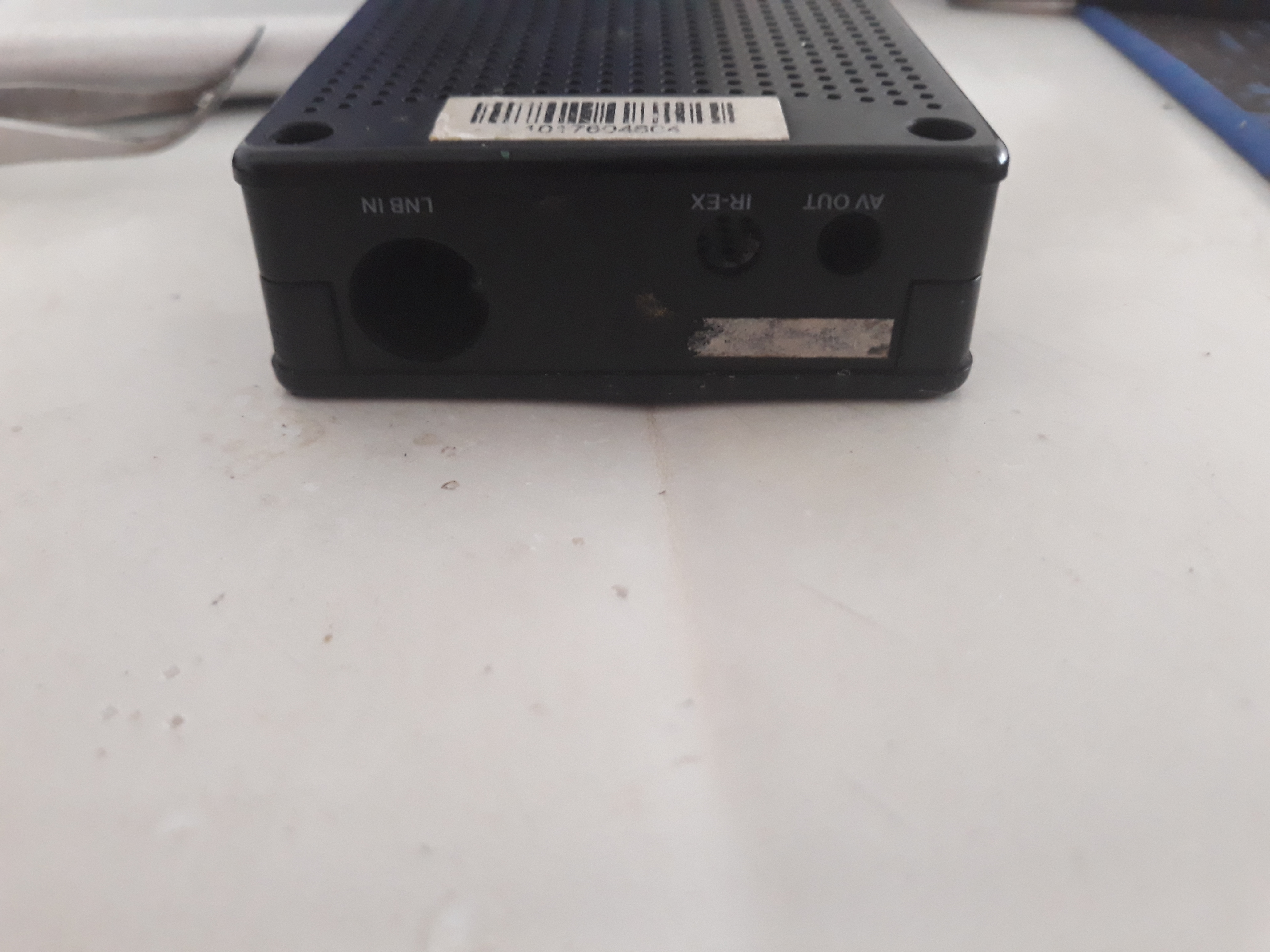

I have this DVB that I took it's guts out I think it would look neat but the problem is it's plastic I'm not sure if I line the inside  with aluminum foil what would happen I might  try that
