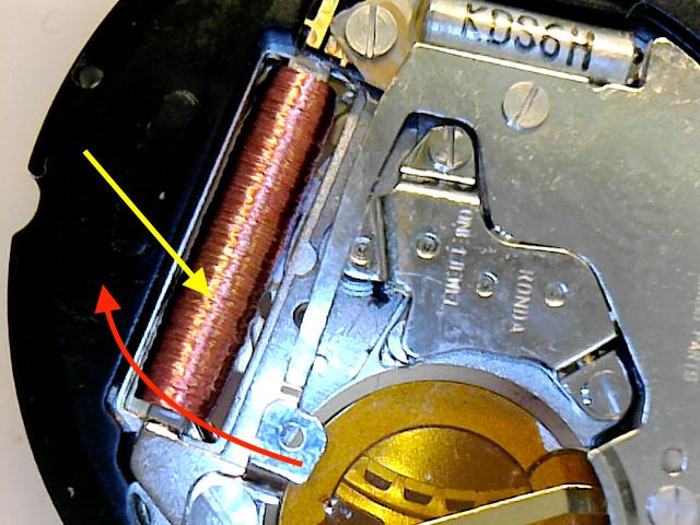

Okay, the exciting times are over 😞
Scratched => damaged coil. Resistance = ∞. Most likely scratched / damaged during battery change cause the spring loaded battery clamp has to be moved towards the coil in order to free the battery. The watch houses a 11-1/2''' Ronda 315(3) movement which is discontinued.
I either wait until one day I'll get a cheap Ronda 315 movement, or find a replacement. I read somewhere that the 11-1/2''' Ronda 715(3) can be used (?)

Hope so matey. So disappointing when this happens 😔, but its always a risk. Can we have a look inside and to see the damaged coil please
It might be worth taking a look at the coil under a magnifier. I have fixed a couple of damaged coils by applying a small dot of conductive silver paint (from the usual suspects on ebay) over the break in the coil. It doesn't always work, and depends on the damage to the coil.
Coils can also sometimes be repaired if the break is on the top layer of turns, by removing coils back to the break, and re-soldering the broken end to the solder tab. This will slightly lower the coil resistance/inductance, but not by enough to affect the performance of the coil significantly.
Its fiddly work, and arguably not worth the effort if the value of the watch is low, but if can be done. You need patience, good magnification and a very fine tip on your soldering, and 2mm or less flux core solder.

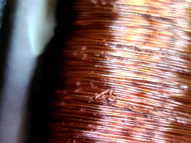

I may give it a try since there is indeed nothing to lose. The rest of the coil seems fine and this is the only spot looking "funny" (certainly not "factory-like). Pictures with my el-cheapo electronic microscope ...
Just trying to put a spot of tin on it ??

I have had good success by unwinding from both directions, then twisting the wires together and then, using an iron with solder already melted on the tip, touch the twisted wires.  The insulation melts and the solder flows to join the wires. Often, the tag end will melt and fall off.  It is worth the effort regardless of the value because "practice makes perfect" and at some point you may run into an expensive watch that needs this service.
I tried with a very fine tip of my soldering iron and some silver-solder. It worked "kinda" well, that's is to say that there sits some silver-solder across the spot but there is still a lose wire hanging on the side of the coil. Most likely I've baked a bunch of coils together 😲
I do measure a coil resistance again of 1.735 kΩ and assembled the movement ...... but sadly no life to be seen .... 😞
