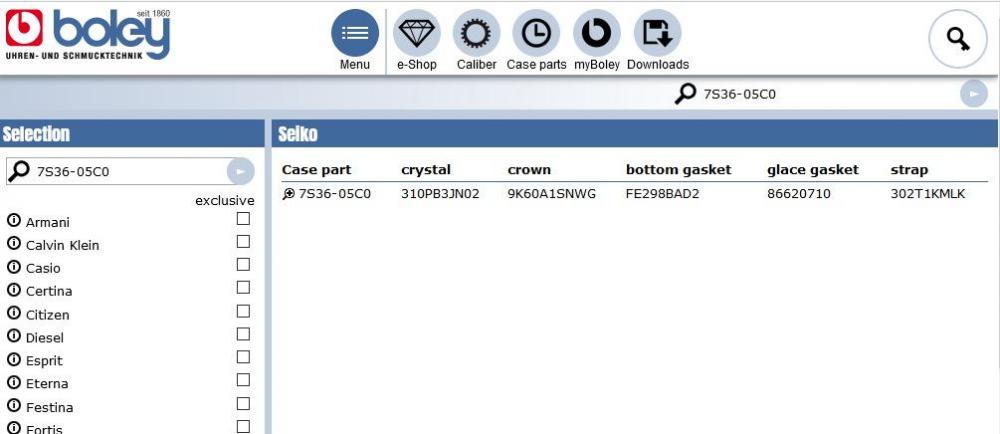

8 hours ago, JohnD said:
According to Boley the crystal you need is 310PB3JN02...
As mentioned in similar threads, the fact that boley.de list a part does not mean that it's available. You need to login to see its stock status, in this case it's yellow light which means they don't have it, and good luck opening an account first with them and they ordering it.
Also, and this is another frequently asked question, there is no need of hunting original Seiko 5 crystals, as they are invariably flat ones of mineral glass. Just measure thickness (likely it's 1.15mm), we know already from the P/N that dia. is 31.0mm, and order a generic, that will be cheaper and identical anyway.

I wasn't suggesting getting one from Boley,  just indicating the correct part number and qualifying the information with the source detail.............At least the OP now has a starting point with a part number to search for :rolleyes:.
It is actually available HERE (no Boley content)..........

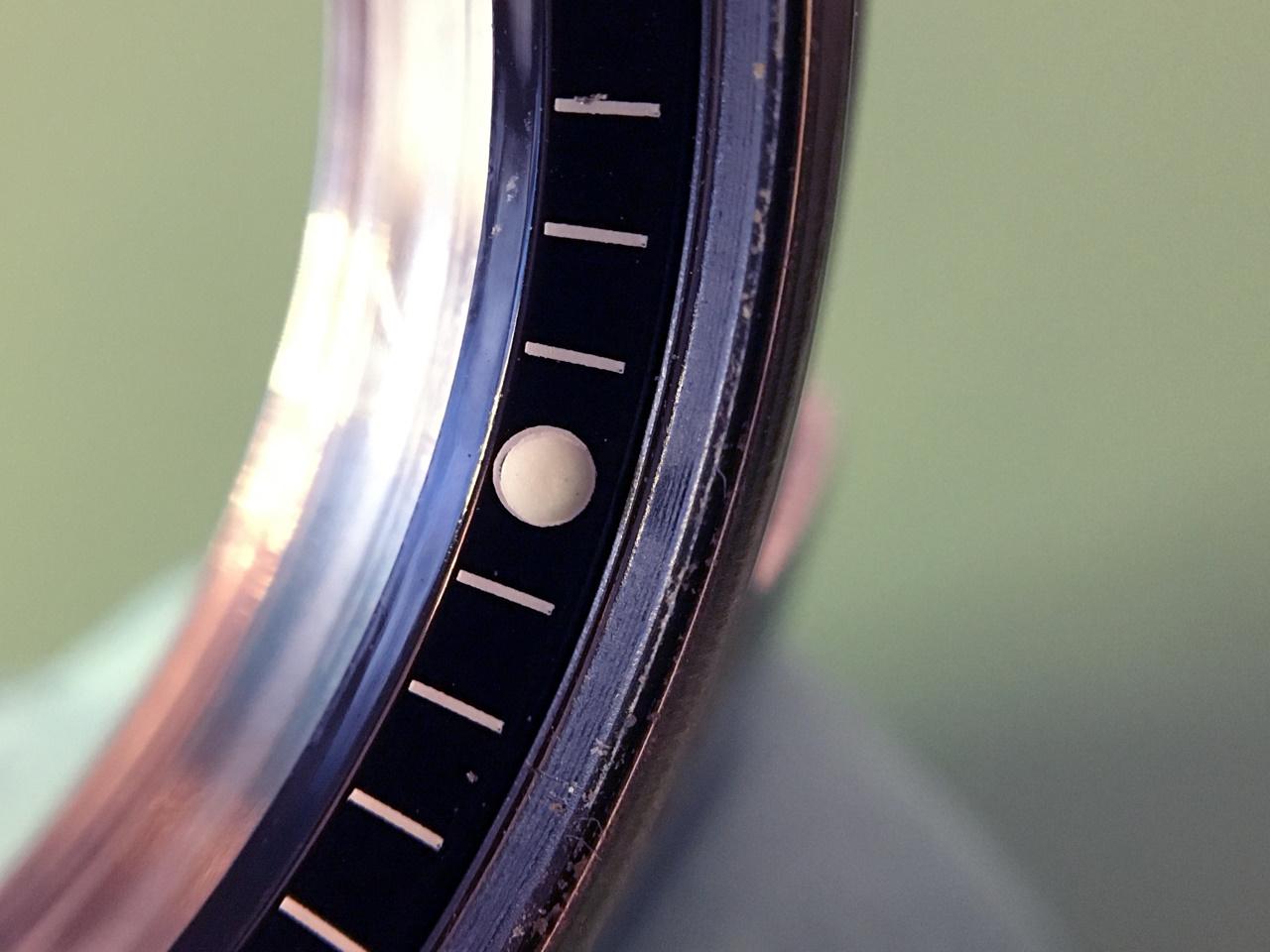

I haven’t yet made up my mind whether to go original or generic, but if I can replace the crystal and gasket with generic parts there’s a substantial amount of money to be saved and considering I paid approx. £70 for this watch, adding another £25 (glass + gasket + shipping) feels really steep.
However, there’s another problem; as you can see in the pictures, my glass gasket is black, and all glass gaskets I’ve seen so far are white(ish). Not sure how big of a problem this would be for the aesthetics of the watch, but it would be nice with a black gasket, but Cousins don’t seem to provide them?
Also, when I pressed out the crystal, the gasket stayed in the case as well as the chapter ring and the gasket seems to sit really hard which makes me wonder if it is glued or if it is simply years of dirt that makes it stick. Do you have any advice on how to tackle it (and the chapter ring)?
If you think my questions seem “funny”, I should mention that I’m completely new to SEIKOs, mineral crystals, and glass gaskets. Previously I’ve only handled plastic and armored glasses. So, please bear with me!

There is no need to replace the gasket unless it has been badly damaged pulling it out without care.
Quote
There is no glue nor dirt, a nylon gasket provides impermeability by mean af a slight friction fit, that is easily handled with proper crystal press and crown type dies.

Be VERY careful if you remove the crystal gasket, the nylon ones are very brittle and can break! I would be more inclined to refit the old crystal then polish the case with it, and the chapter ring, in place.

The thickness has me a bit puzzled. The crystal extends just slightly above the grooved parts of the bezel. I wonder if it is the original crystal but for some reason I still believe it is the original crystal.
Sorry, I did not recognize that at the beginning, your watch is a semi-diver, with a thick glass and a deep chamfer to clear the bezel. That makes it "special" and in practice justifies the relatively high cost.   If you don't want to spend you can always polish it. Otherwise if you like the domed style https://www.ebay.com/itm/1pc-2-5mm-Thick-Single-Dome-Mineral-Watch-Glass-27-42mm-Round-Watch-Crystal/302493359240
