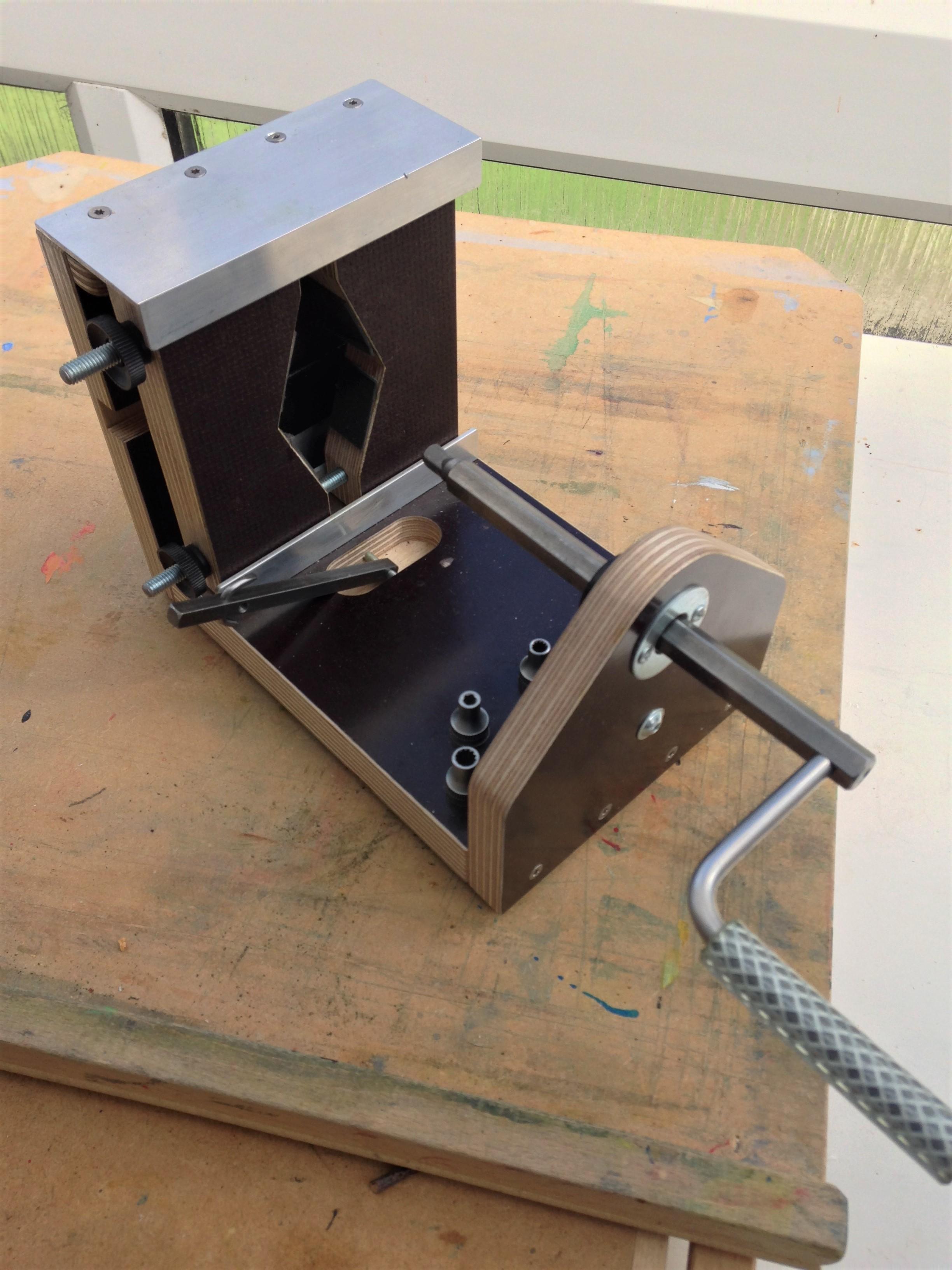

So if i understand correctly #1 is your spring letting down tool, could I have a picture of that please? What is #2 is used for? Why do you have a second bar for your second winder marked as #3? And do you have any bearings in the wood? It looks like you used hardwood, or is that some kind of furniture wood? I hope you don't mind to answer these questions.
I found this meanwhile: Joe Collins Spring Winder Plans , the thread leads to different threads to where you can find different variations, had no time to go trough them yet but planning to do so.

Hi Lui   The CONTRAPTION owas build using seasoned Mahogany hard wood, There  are  no metal bearings as the wood is very hard the tool used to locate the mainspring arbour is one of the keys from the mainspring let down set which slots into the key, That way it will accomodate arbours of different sizes. The second hook hanging on the end is for loop end springs and fits in place of the first hook on the base. they are interchangable.   The second picture was the Mk 1  and the bar is for arresting the handle when the spring is fully wound, used instead of a ratchet this allows hands free access to the spring retainer to be slid int the wound barrel. The tension is then taken up and the bar slid back to allow the spring to be unwound into the retainer and removed from the barrel .  It was designed to remove     Mainsprings from 400 day clocks upto the three train mantle and bracket clocks. Not for the fusee clock as the barrel in a fusee clock is about one and a half times bigger and has a considerable spring which deserves respect, I think the Olly Baker winder would struggle with one as you have to grip the barrel by hand while tensioning the spring
Well,  I’m starting to get some work done on a basic winder, for the hobby stuff I’ll be doing. This is midway through doing some of the basic cuts and planning. I’ll call this my Mark 1 once it’s done. It’s taking the Franke design as it’s basis.

A little bit more completed. Got the holder for the barrel sorted as well as it’s slide mount. Also the spindle holders for the winder/unwinder. Now going to look at how to recreate the reverser/ratchet mechanism. May just do it the same way as the Franke design, seems most convenient. Anyway - it seems we have another three weeks of lockdown as yet to Continue to experiment and build.
I may yet shorten the winding side once I have the ratcheting mechanism sorted out. It’s looking a bit long now.

Nice woodworking skills Moose, did you use a router? I see the base is decking wood, i am making planters out of it at the moment. Keep posting your work, I enjoy it.
You are correct - the wood is a left over from a decking project. It is very heavy duty, about 30mm thick, so provides a stable and heavy base. Don’t have a router, but used a small table saw to make the channel for the centre panel and to cut the step for the butt joint at the end. It’s coming along today as well. Maybe another pic later today.
Did most of the work now and it’s looking OK. Still need to fit the spring retaining hook and I’m waiting for delivery of a set of Main spring sleeves, which I should get early next week off eBay.
I guess it’s a sort of mashup of the Franke and Olly Baker designs. I used a ratcheting ring spanner to hold the spring tension whilst winding. The threaded axle just passes through it and I used a pair of nuts to transfer the rotational movement. I can reverse the direction of the ratchet very easily by flicking the ratchet over. I took this from the Franke design but did not want to go to the hassle of rebating the ratchet into the woodwork, so just used a bar to prevent the ratchet handle rotating. The bar design also allows the axle to slide back and forth whilst attaching etc.
I think for a “Mark 1”, it’s OK and certainly does the job. Will likely be all I need as a hobbyist anyway.
If I was to change anything, I might change the axle to a hex bar (like Franke) and fit the ratchet so it looks integral to the design. But that would mean having to source a new chuck design as my existing chuck screws directly onto the threaded axle so I would need a different solution. Or just use sockets, like the Franke.

Hi Moose  thats a stalwart job, Its a combination of a few designs I have seen on the net, a commendable piece of work .  Used as intended for hobbist work should last for years. I thought about the ratchet idea for mine but it meant sourcing the hex rod and rebatingalthough it makes a neater finish does not detract from the functionality well done.   If I ever rebuild "CONTRAPTION Mk ll  "    I might do it differently        cheers
Yeah, I did think a lot about the hex rod idea and rebating in the ratchet handle. But I already had a spare chuck which needed a threaded fixing, so I just used threaded stock rod, so it was the easy way out for me.
like you though, Mark 2 (should it come to light), will have that refinement. I quite like the Franke design, so would likely head more towards that.
