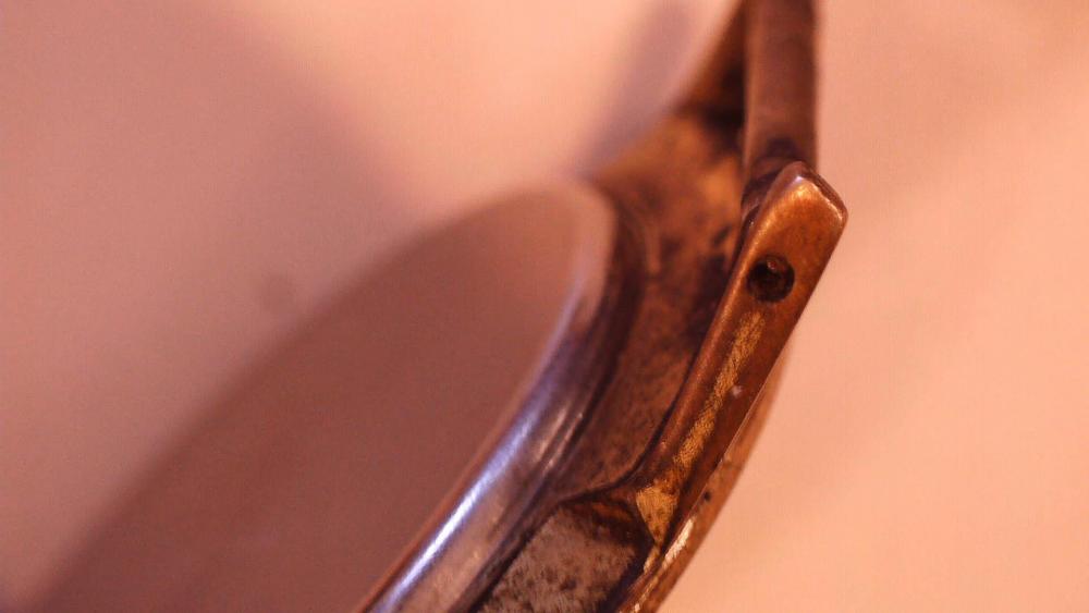

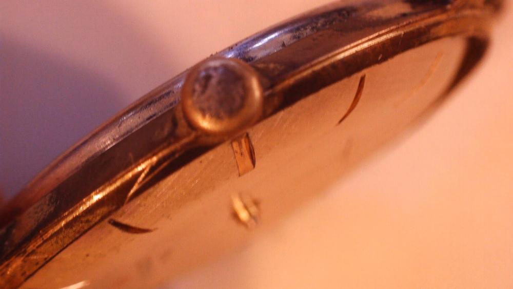

How to open Helbros (France) case
There is no lip on the back case, don't think it pries off.  Note the watch back stands proud of the case by 1/8 of inch or so.
I pulled the crystal, and have put quite a bit of pressure on the stem - don't think it is split stem.  But, the dial is way to big too go out the back.
I bought a bezel removal tool, it does not move the face bezel at all.
Any ideas?   Thanks!
It does. Just go around it with a japanese type caseback tool, its tip may need to be sharpened a little. There are also lever type tools but doesn't look like it's needed for this.
I recommend againat using razor blades, very unsafe and no way to exert and control force without making some of handle. If a caseback knife is not available an x-type knife can work as well.
Edited by jdm
