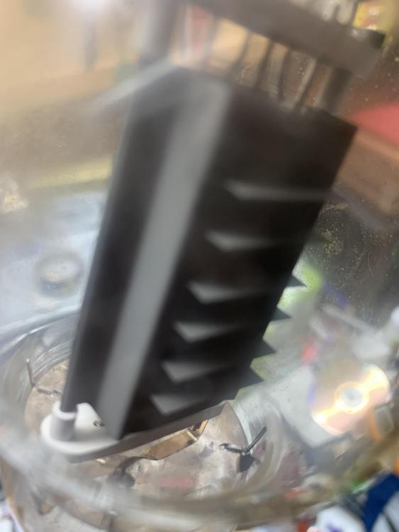

Has anyone here worked on an ultrasonic such as this one?  L&R Maxomatic..

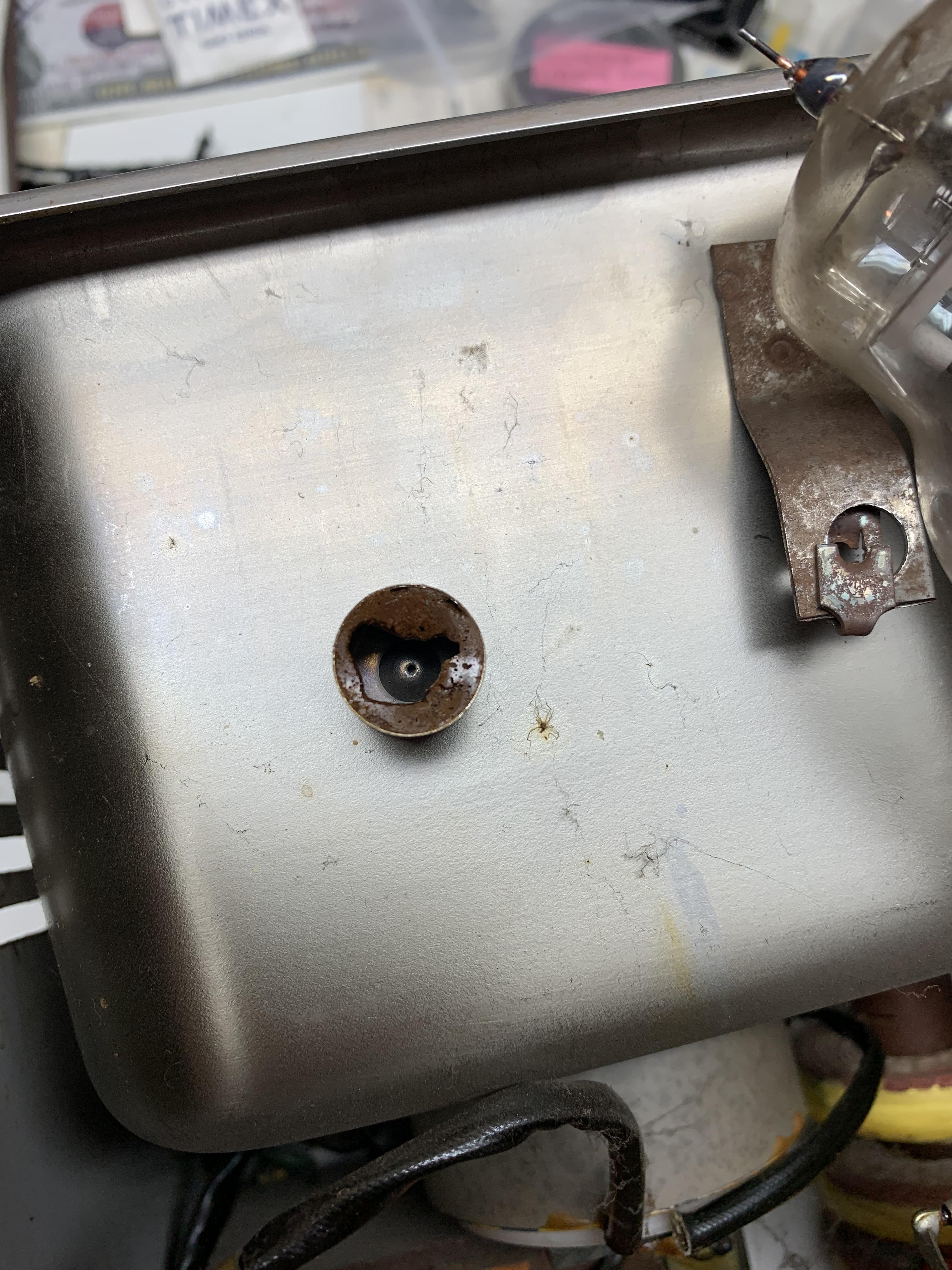

I was told it will smoke when powered up. After opening it up I pulled the tube and right away I see it failed because the top cap fell off!
Also I noticed debris inside which of course is not a good sign either.
So what to do?  I found a used tube for BIN at $20.00 and best guess is the machine is maybe worth $40.00 Is it something I should get into just for the fun of it?

I was told the machine was made in 1975 but did not verify that.  No matter as I did go ahead and order a replacement tube. Someone else advised to replace any electrolytic caps. But, there are only two disk caps inside.
I am assuming 'valve' is the same as 'tube'?

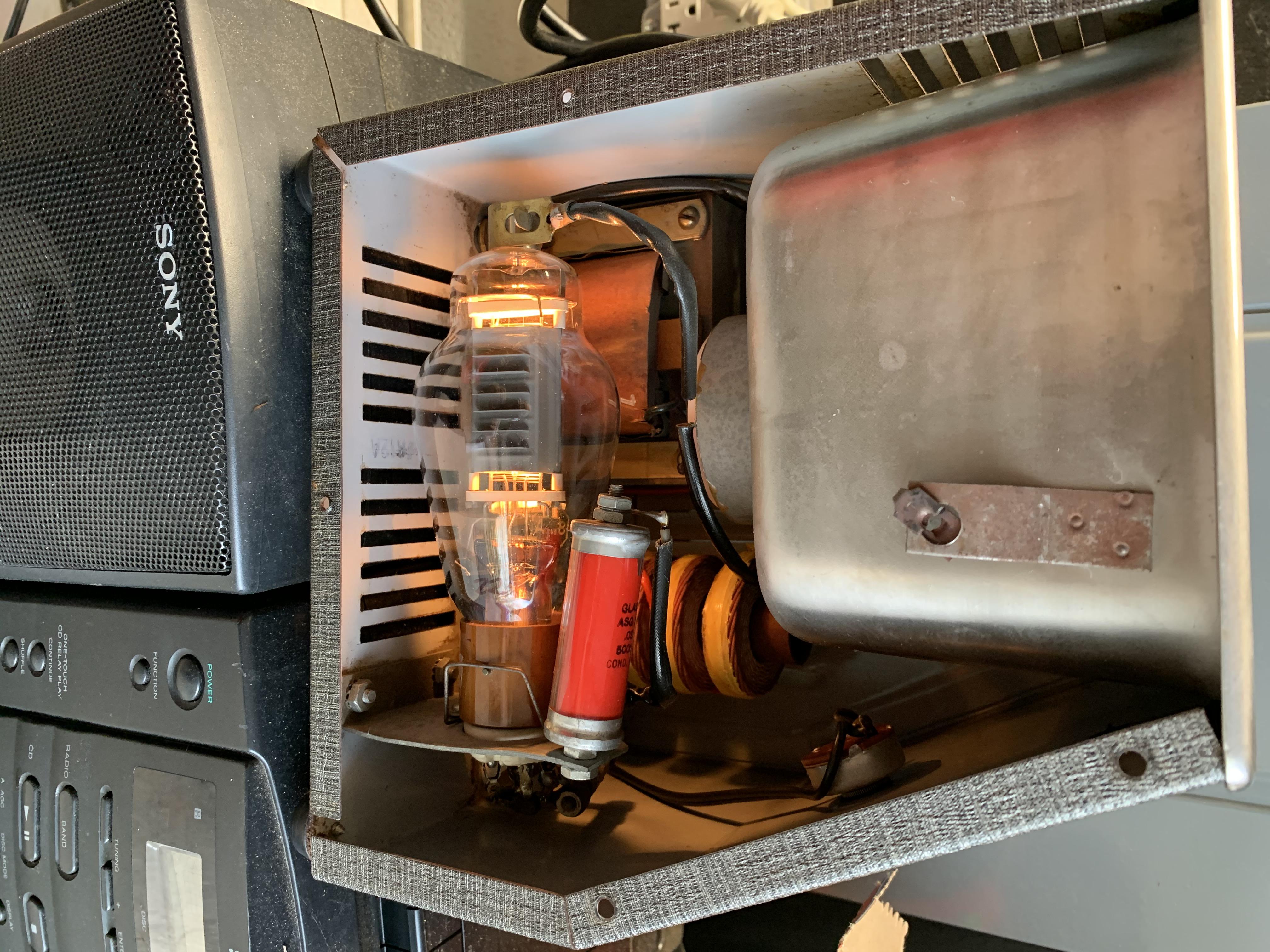

Yes, I found a 812A on ebay.

Thanks,  the cleaner will be going back to work at my watchmakers shop. He had given it to me for an 'AS IS' sale on ebay. but of course I could not resist to take it apart and figure out why it was not working.  I should have told him it was just 'over wound'  and needed a servicing.   :)
