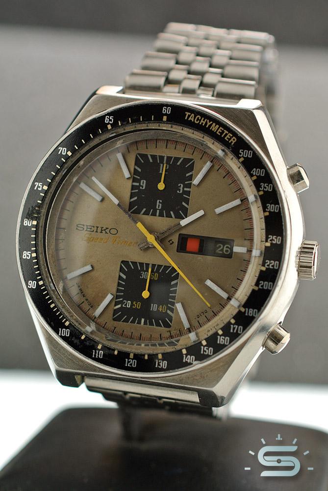

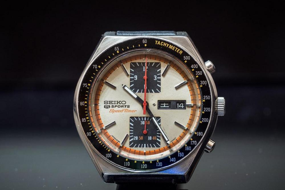

Another question and/or dilemma. I bought a 6138- 0030 case and dial and fitted it with a 6138B movement. Whilst still requiring some work and parts, I wanted to get it as close to the true form as I can. I need to pick up a case ring and spring, a crystal, pushers and springs and hands. I want to get the proper ones for the dial so if anyone can advise, I’d appreciate it!  I believe they should be baton, with orange second and chronos.  The hands that are on now came with the dial.
Also, do you think the yellow was originally orange and faded to yellow?
You can buy aftermarket hands pushers and springs all over ebay they work fine. I also found a couple movement rings as well not sure these use the spring type spacers found on the 6139s. I have one but never opened it up. The glass will be very difficult i think you can use one from a 6139 which i know spencer klein makes them. You can ask if they are compatible
    • Looks that way, if it had any amount of significant jewel count it would say so on the dial.    Looks that way, if it had any amount of significant jewel count it would say so on the dial.  Same answer as Mike regarding the dial, its often just a slapped on name of a retailer but i thought you were way above this understanding Pete ?
