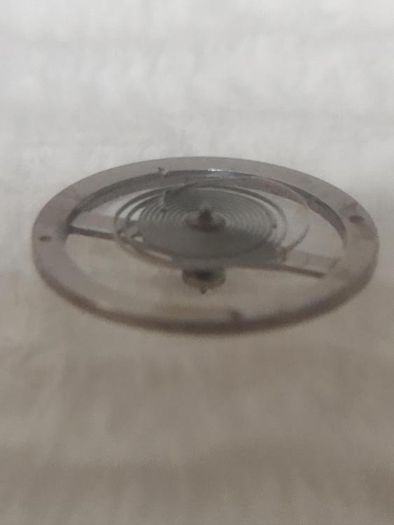

Can you post pictures of the balances as they currently sit?

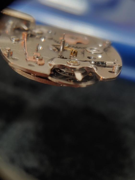

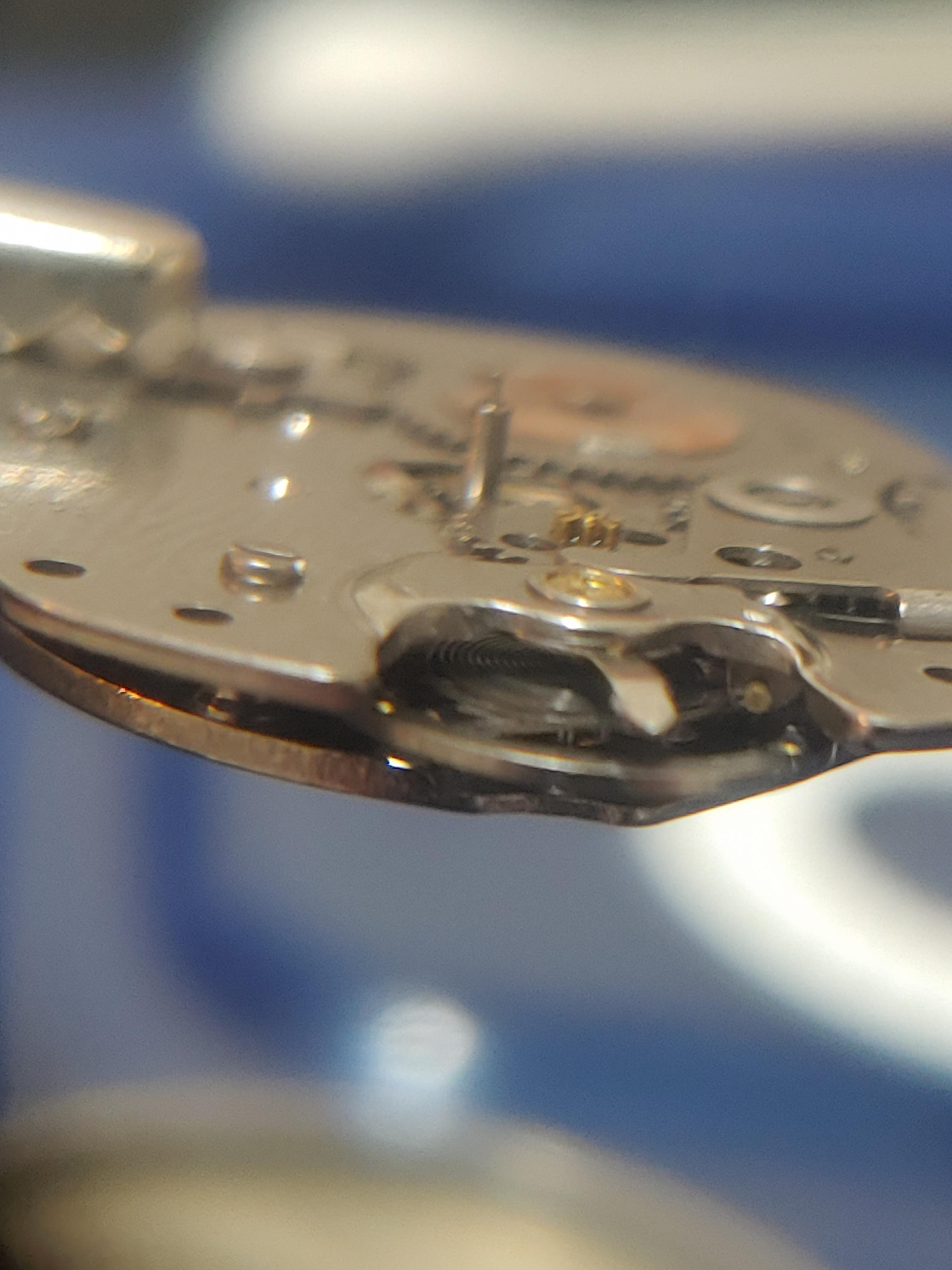

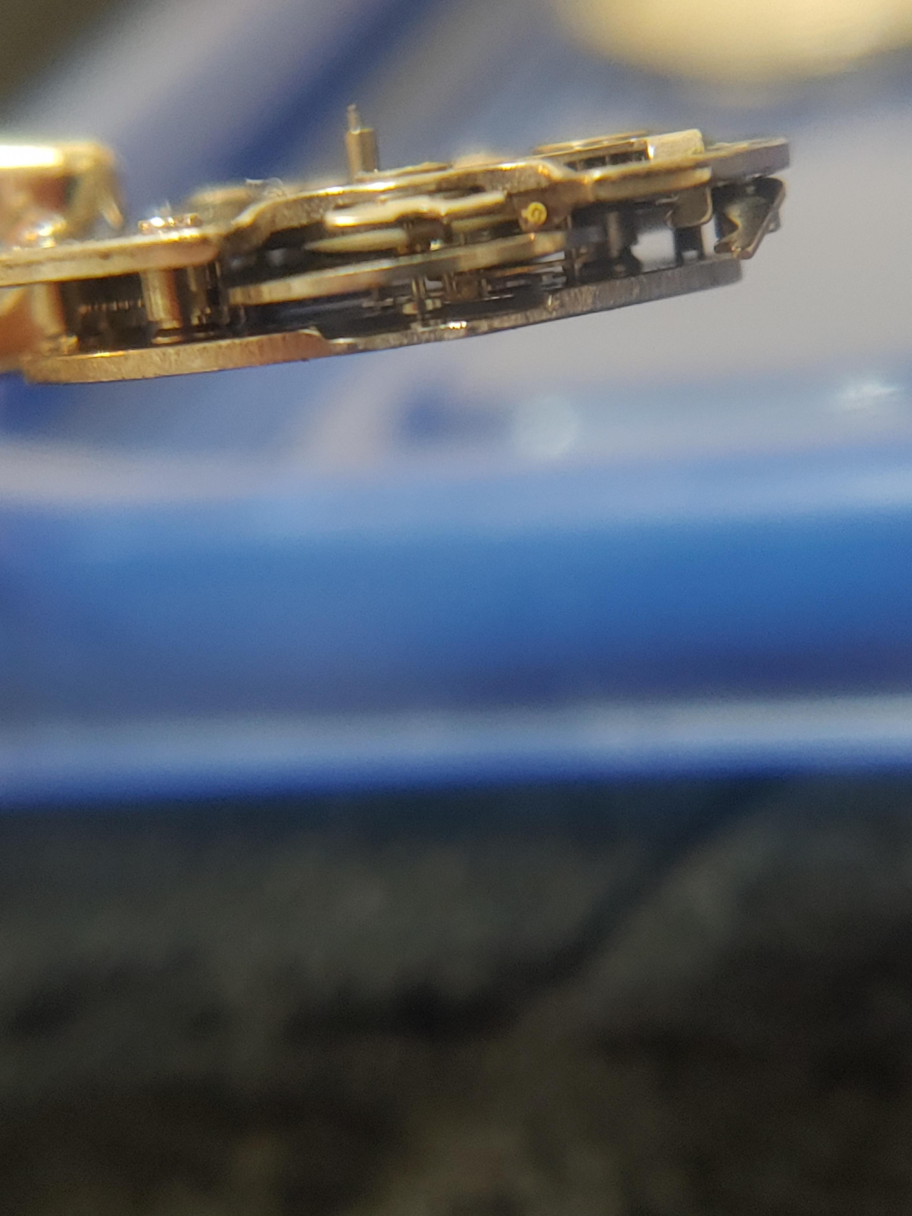

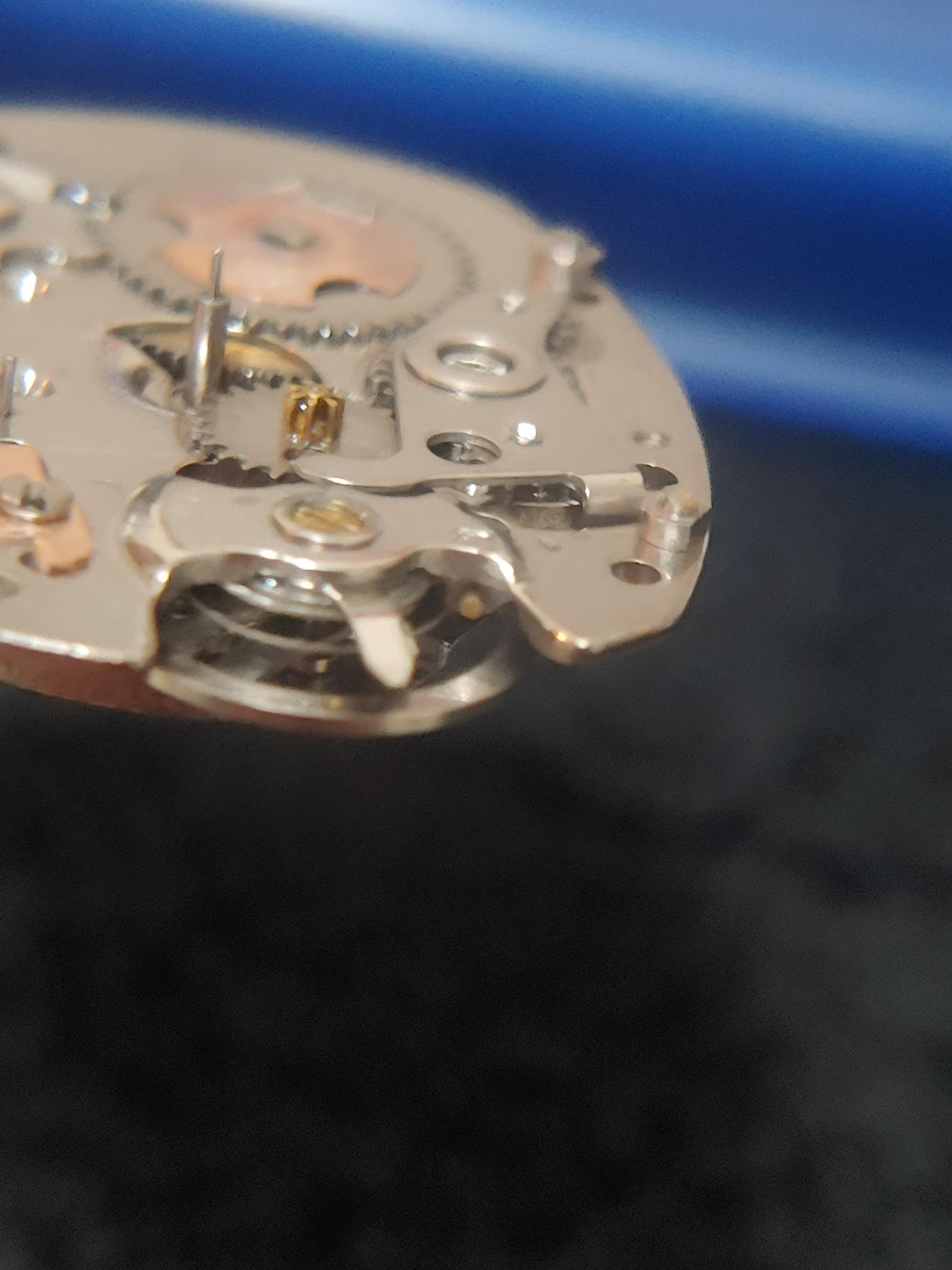

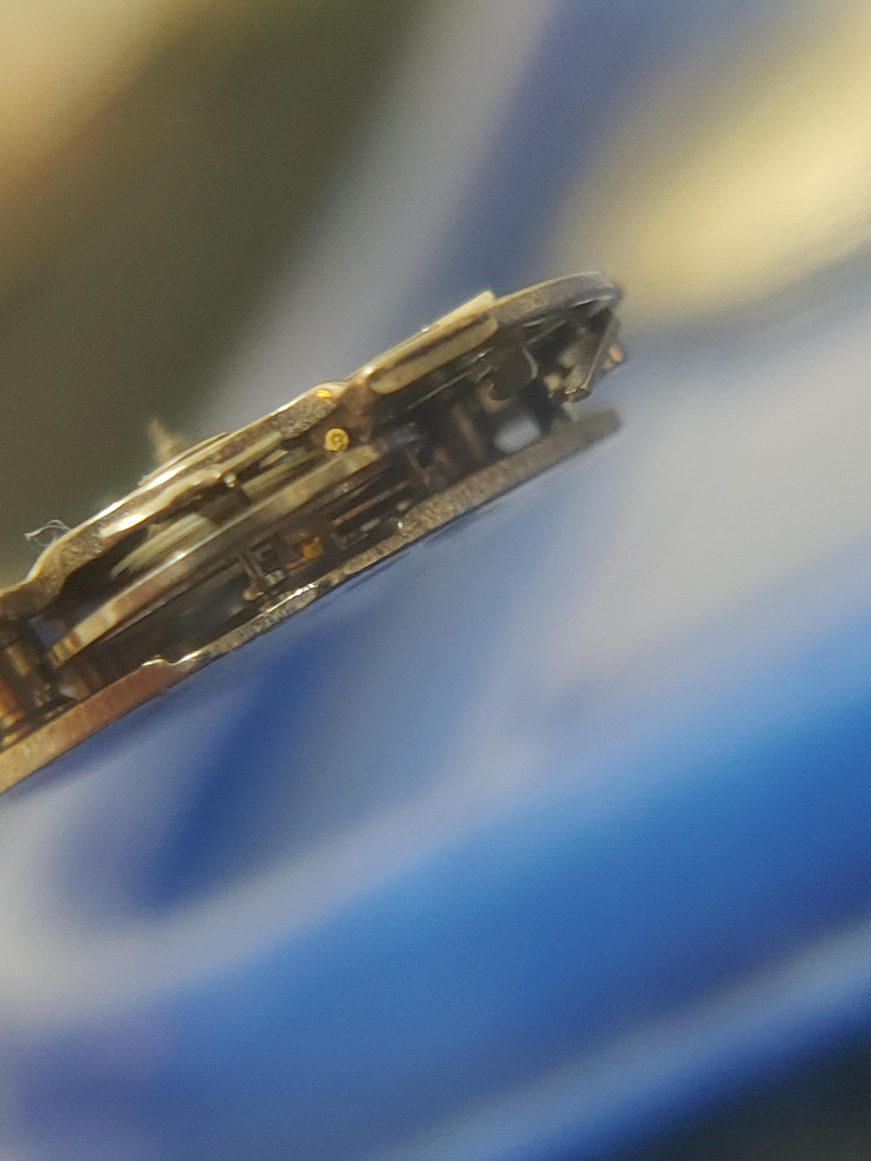

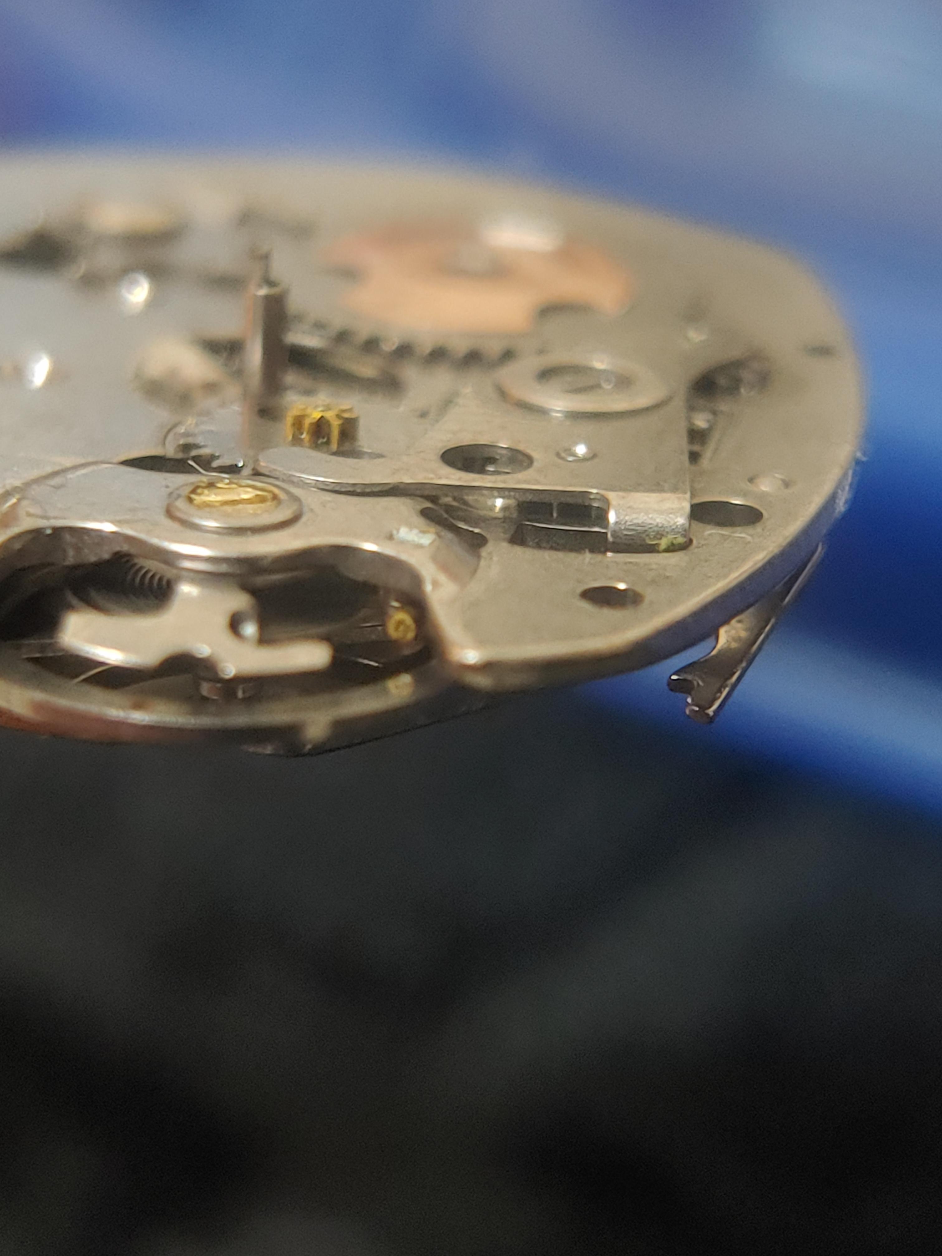

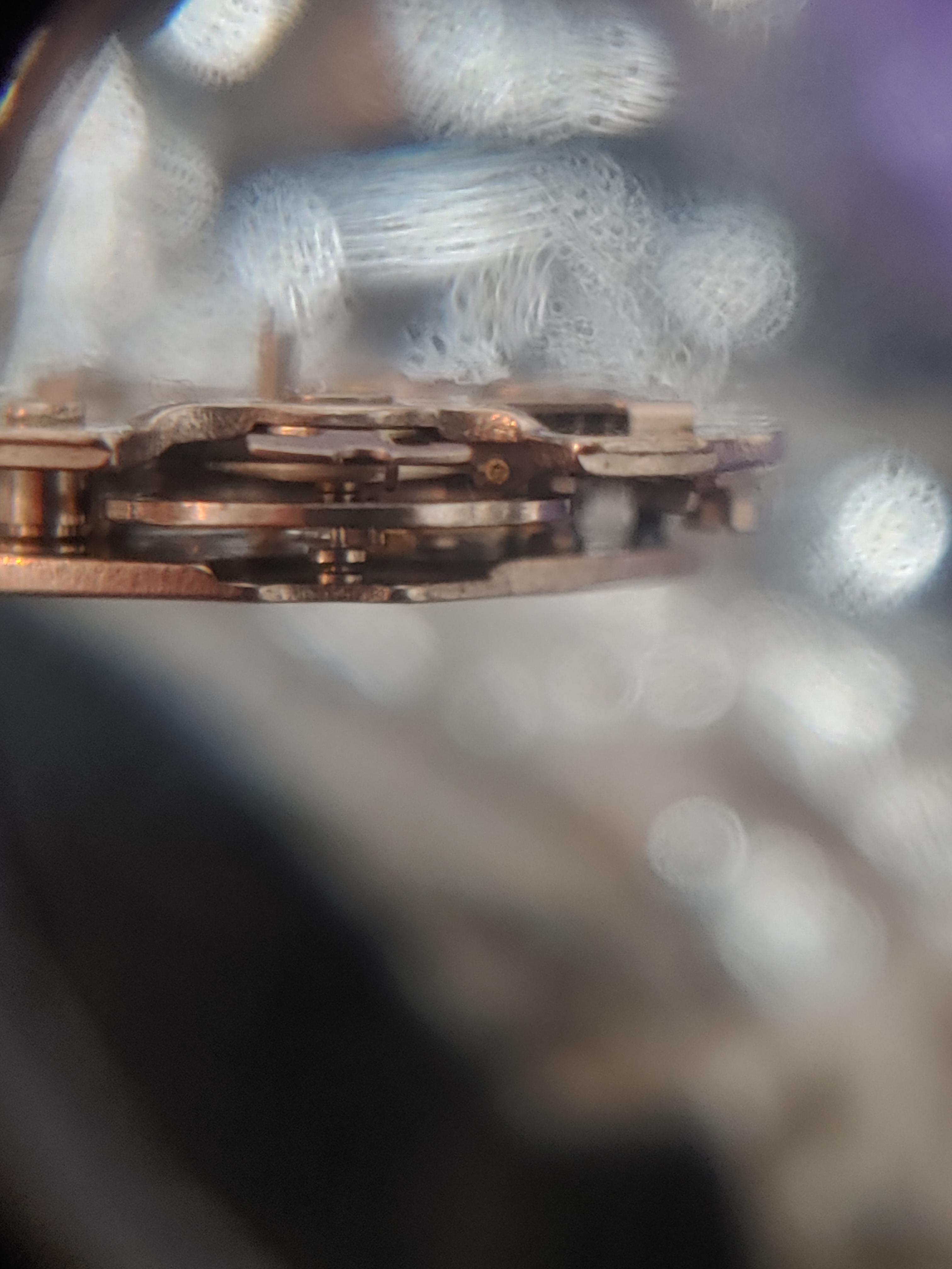

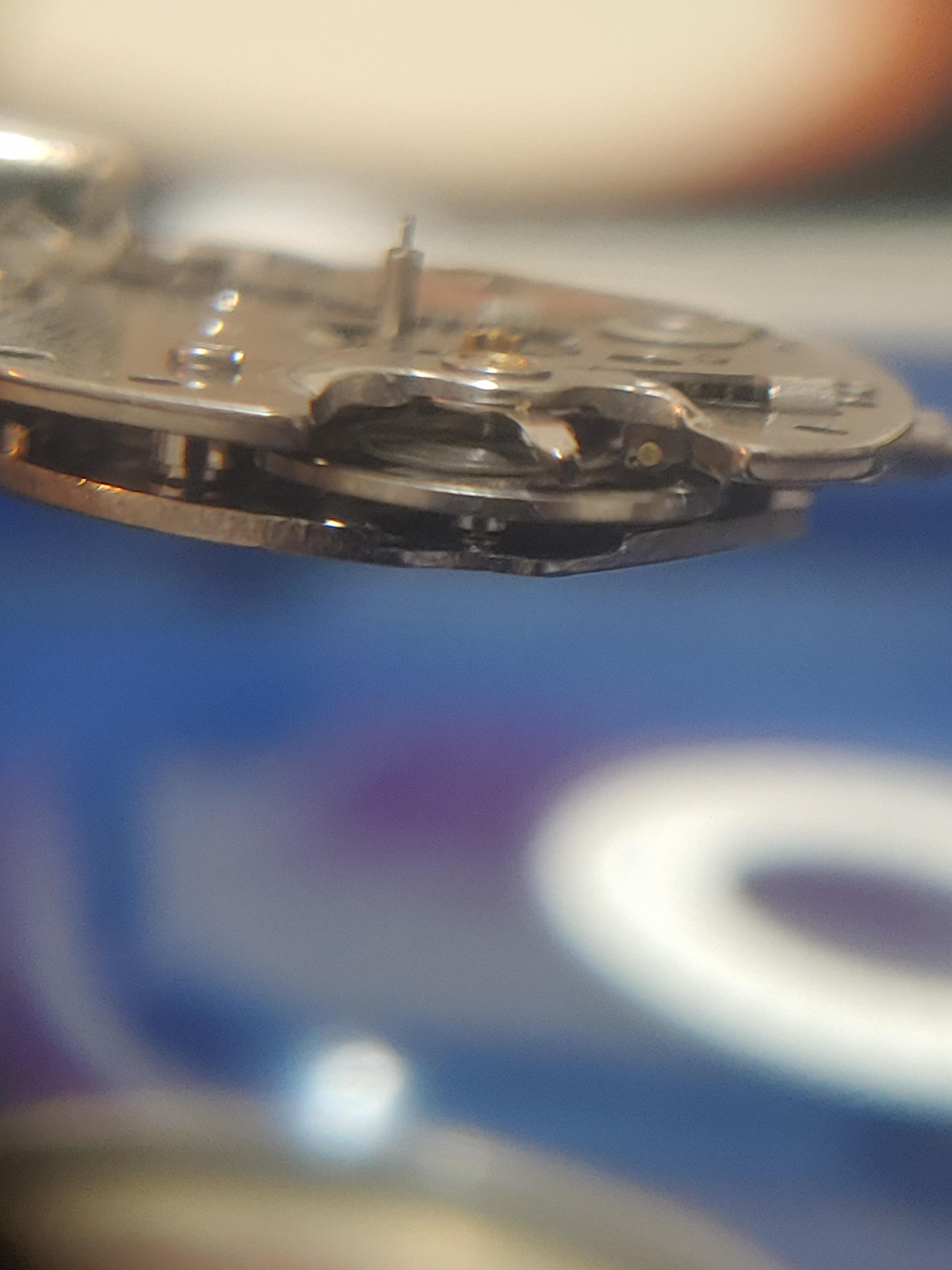

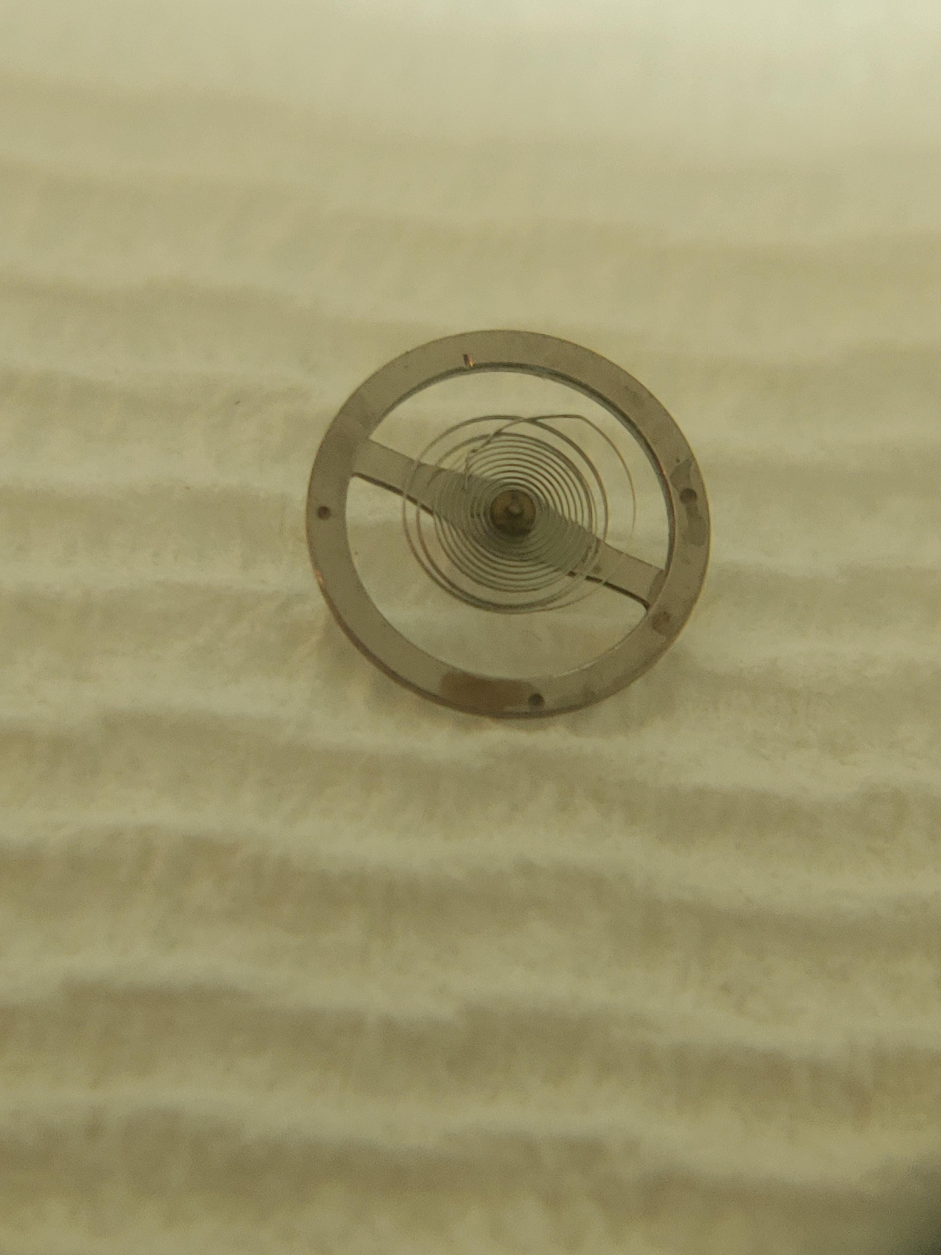

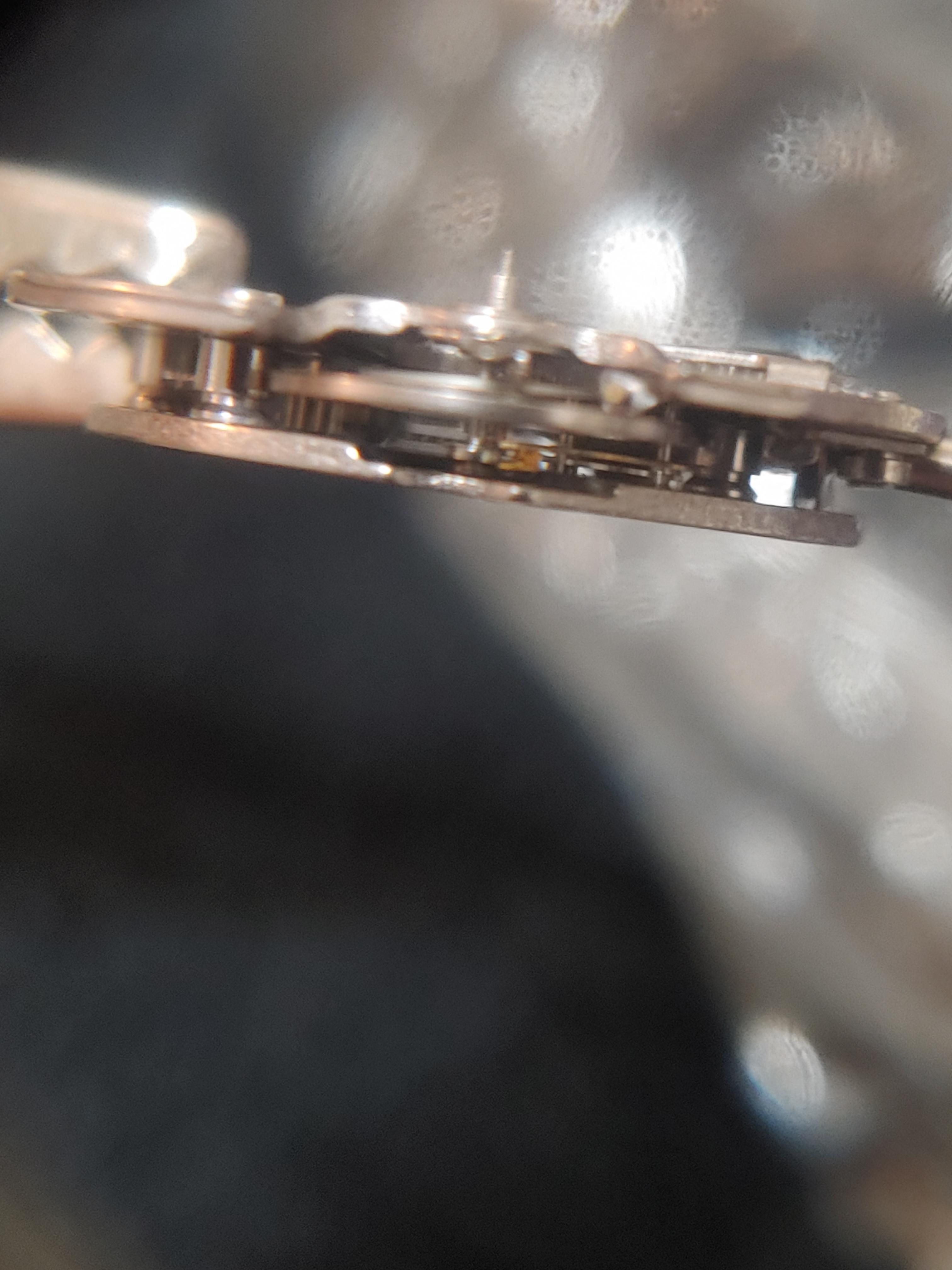

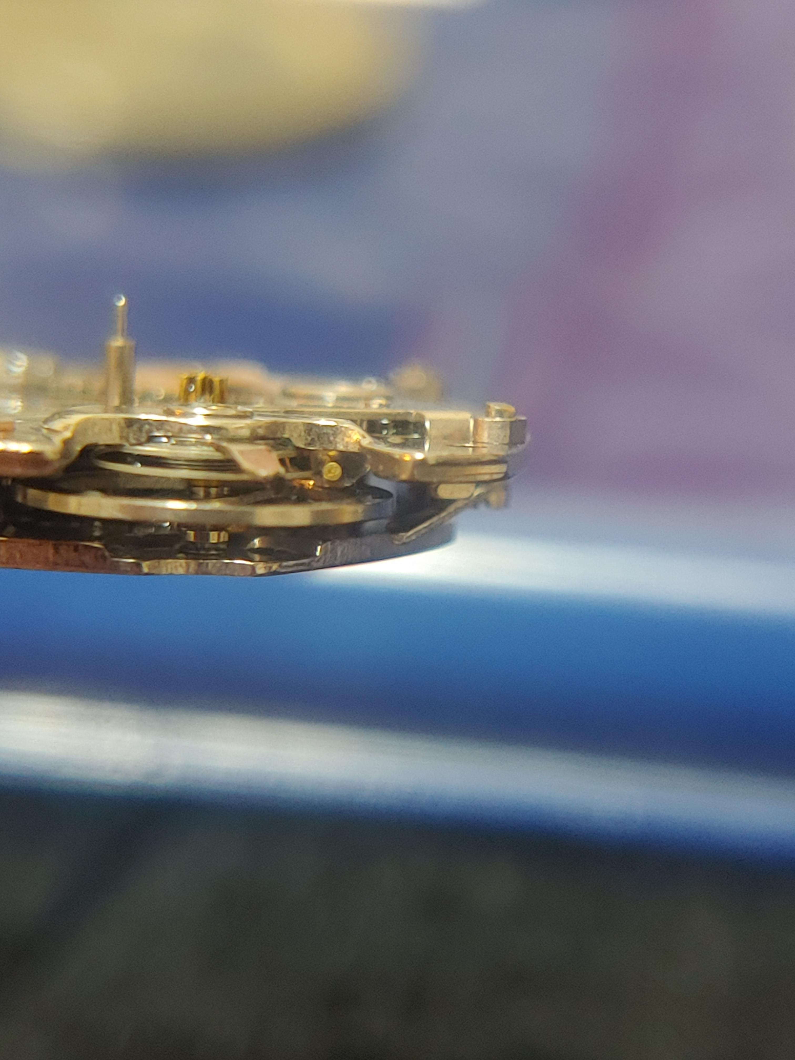

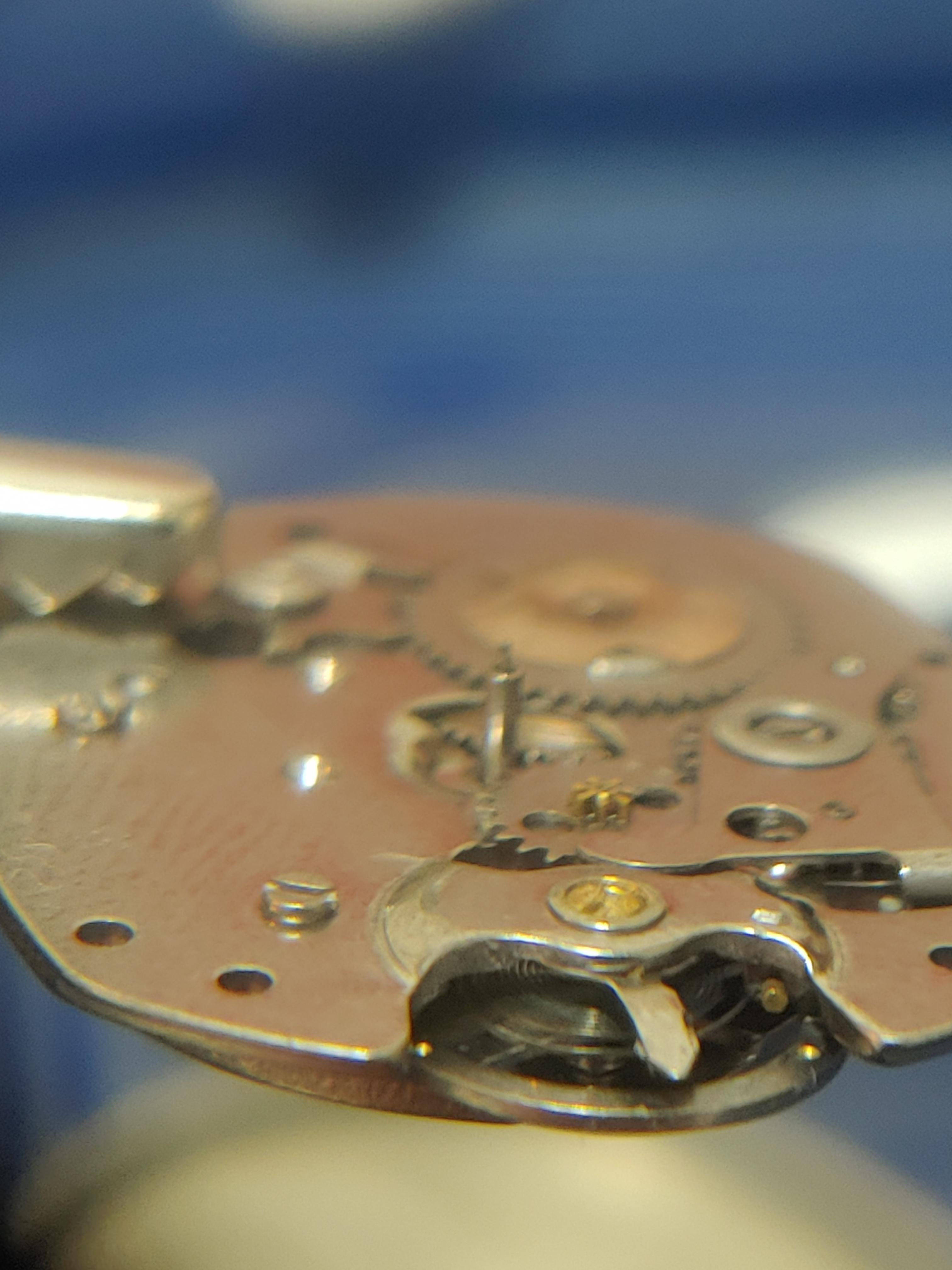

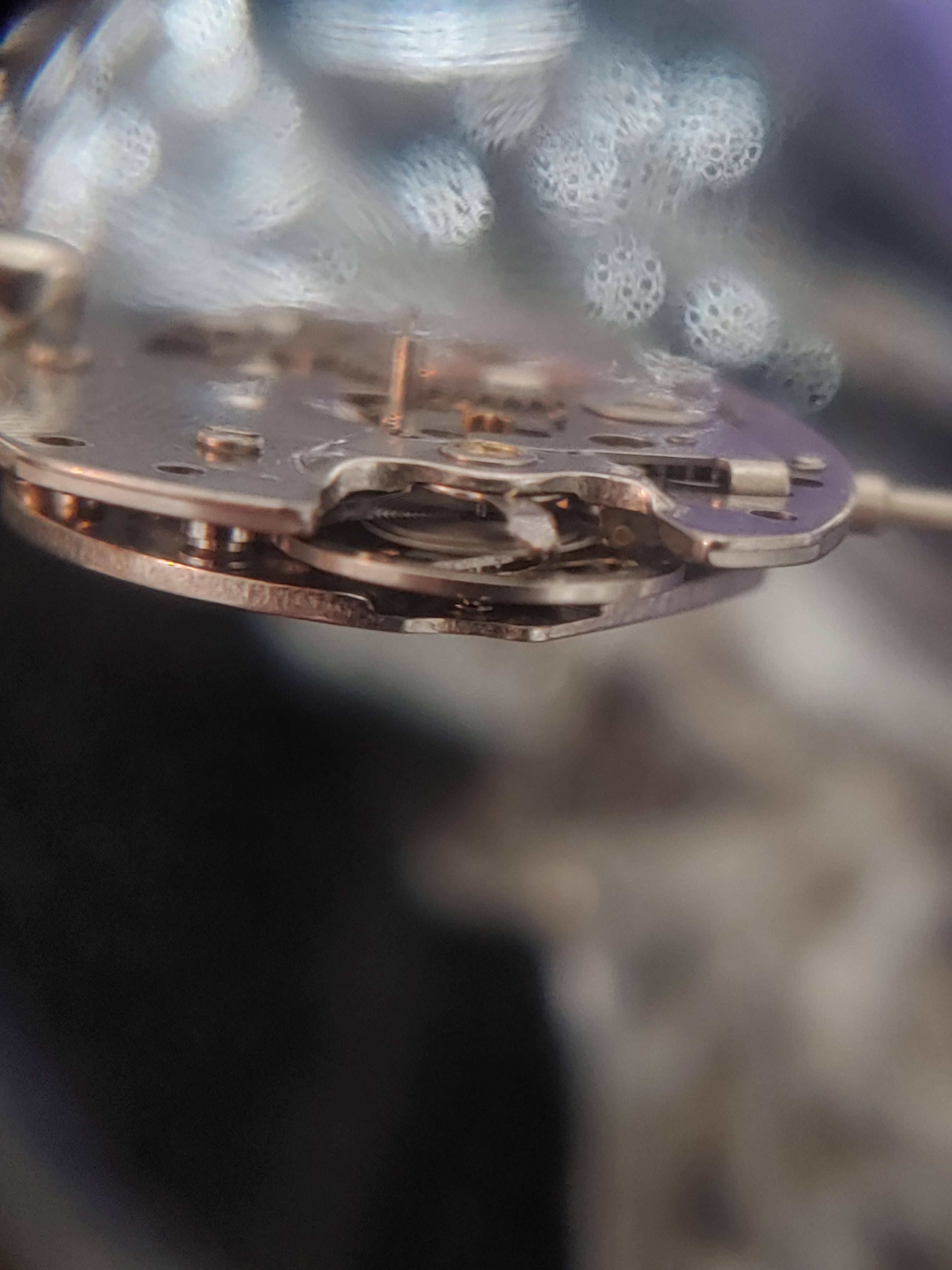

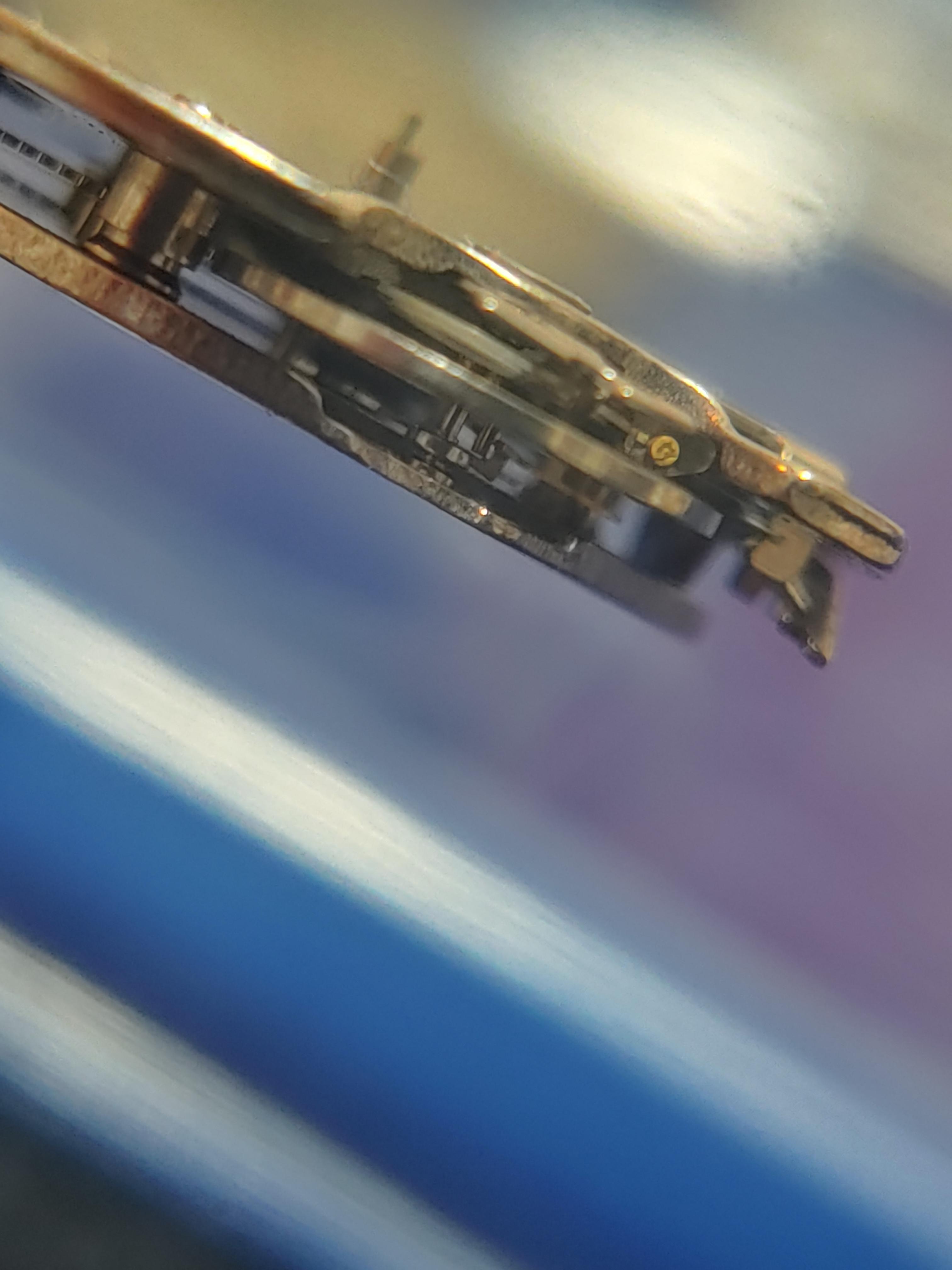

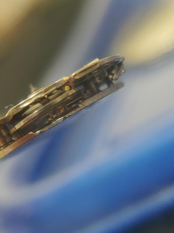

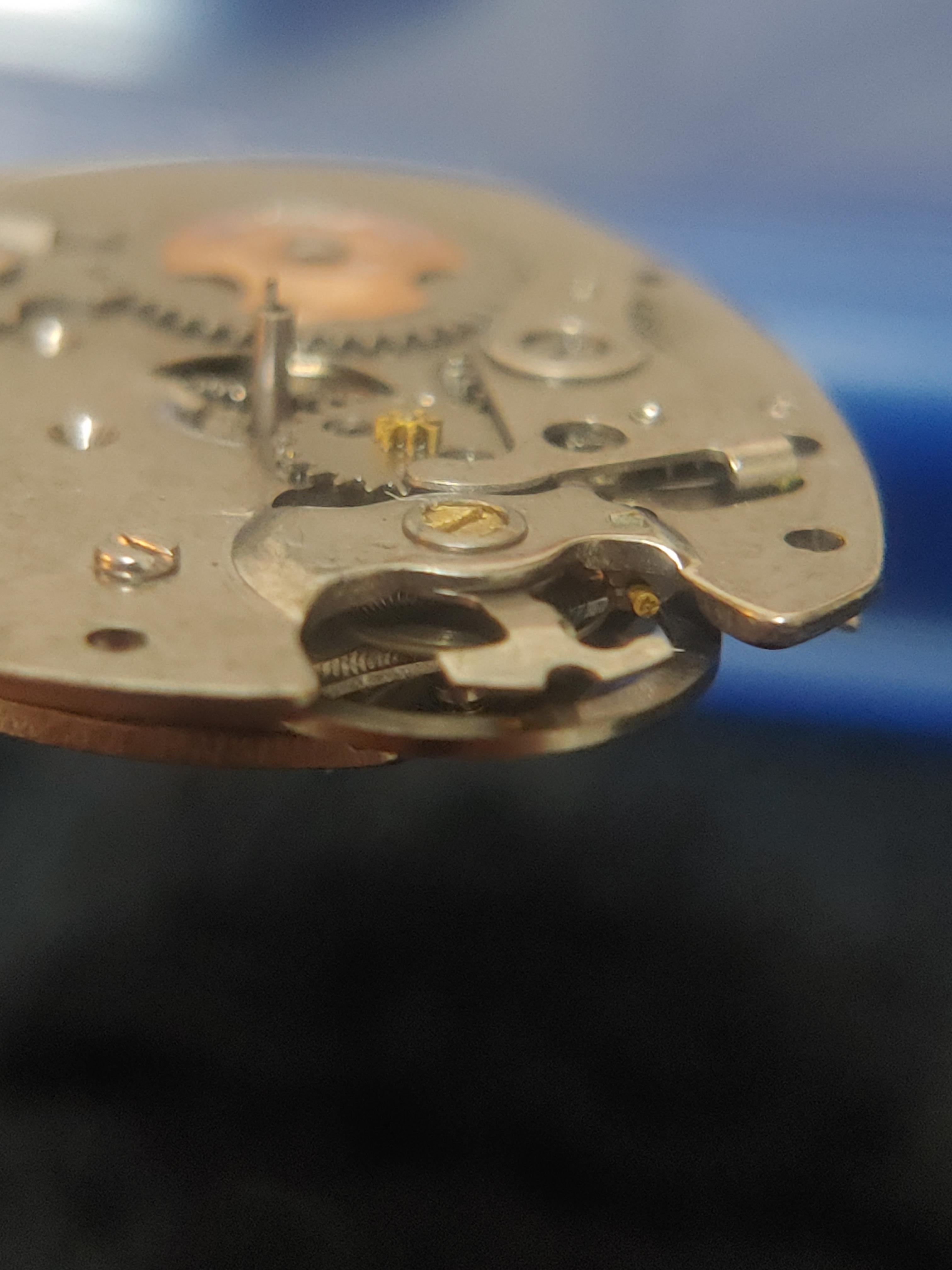

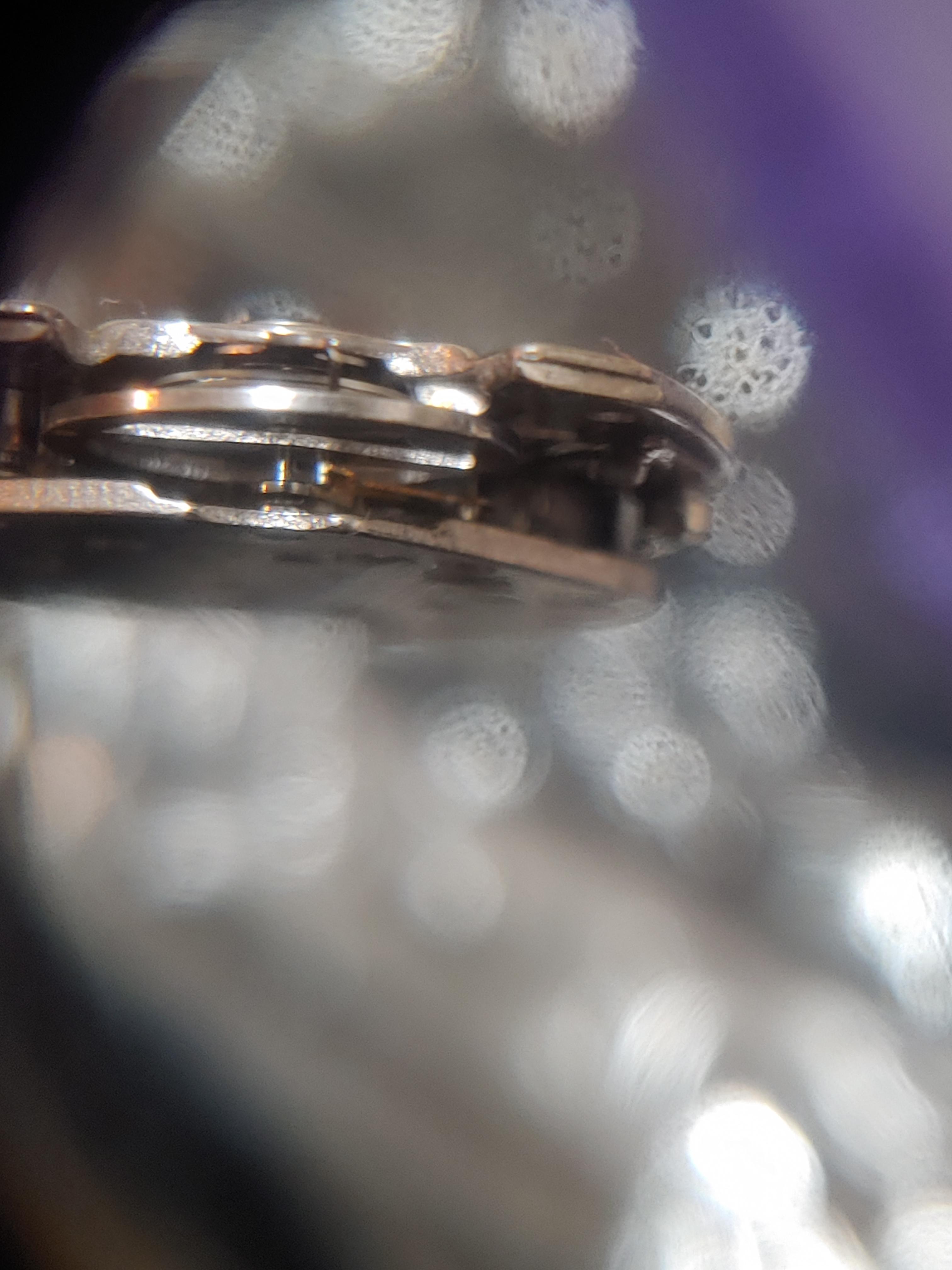

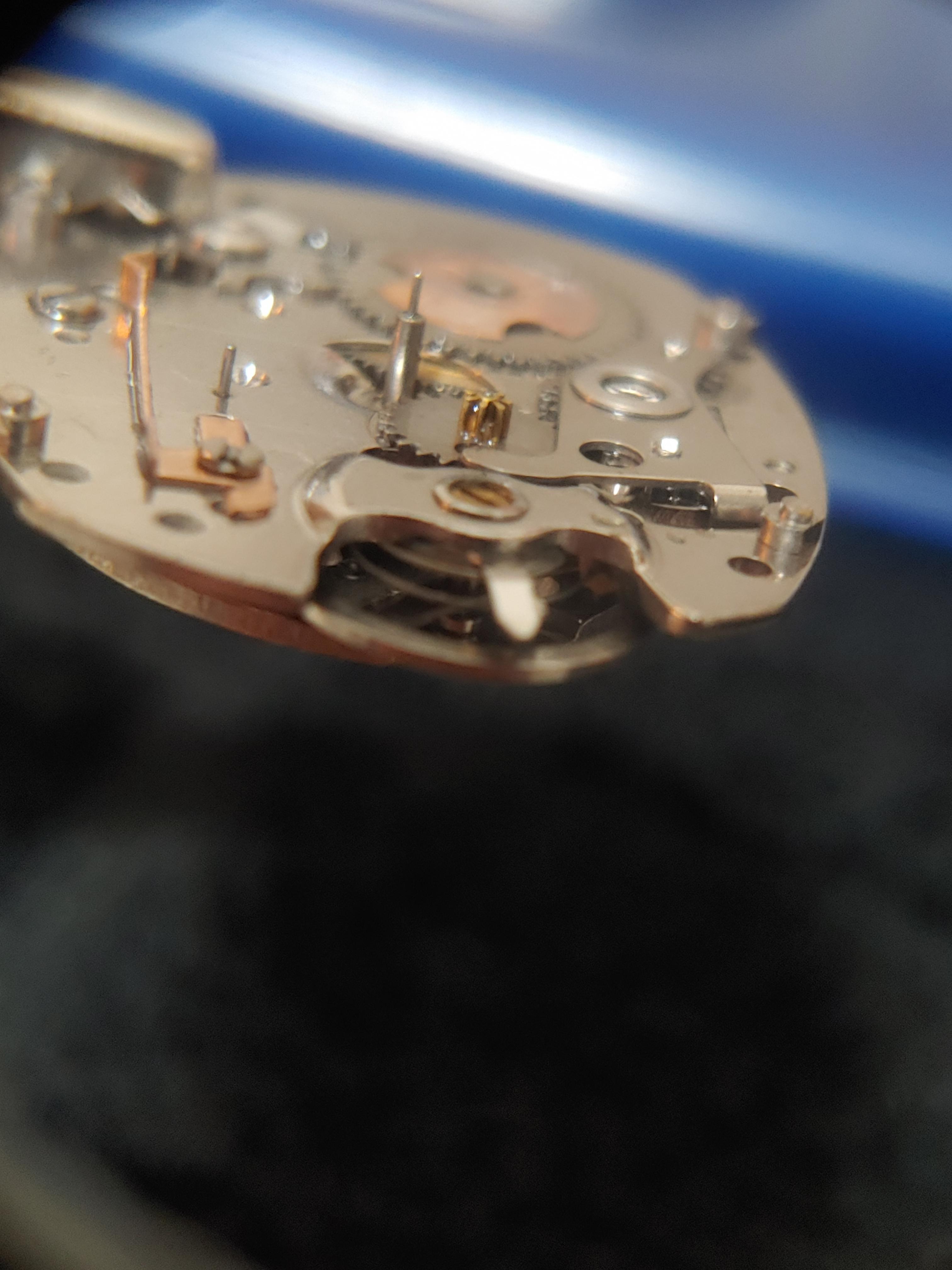

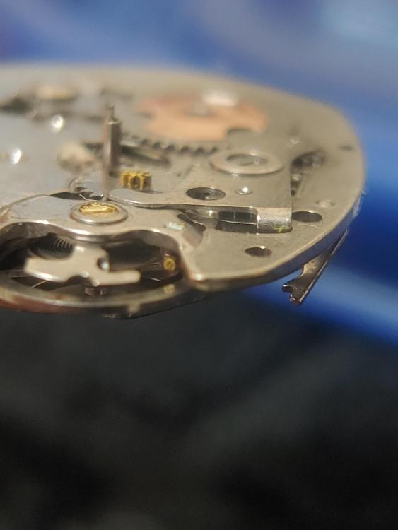

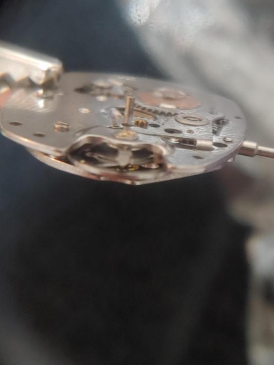

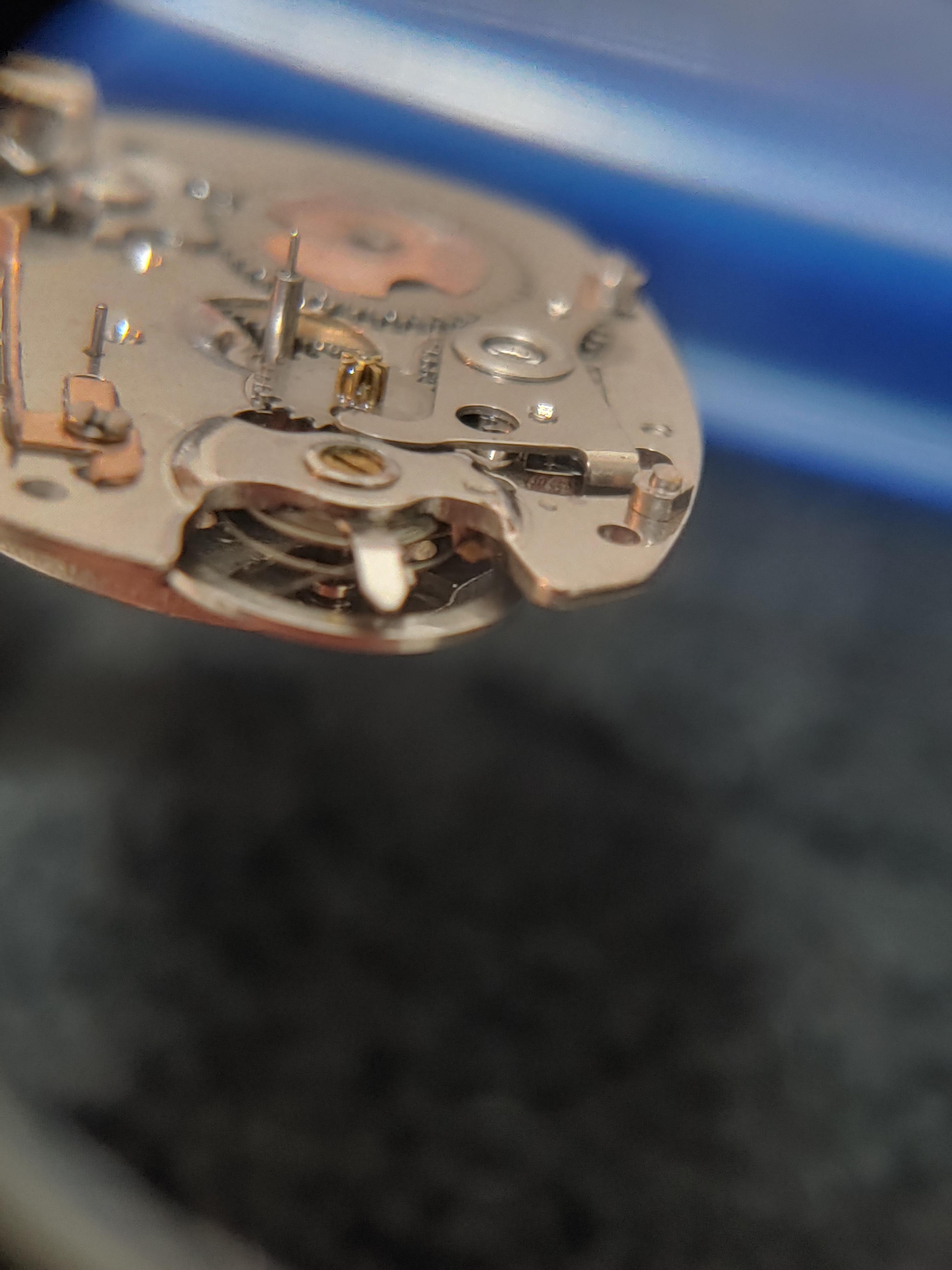

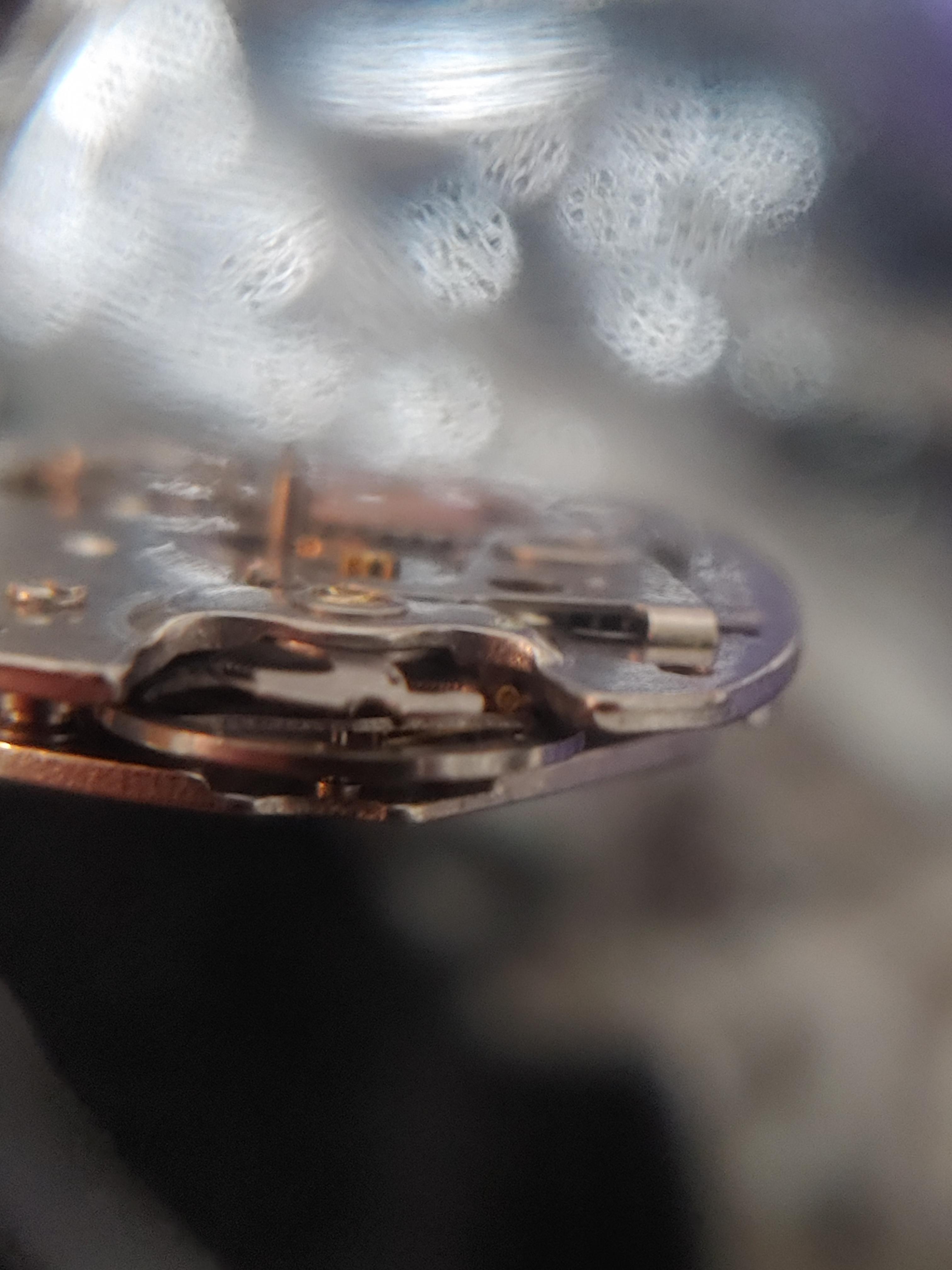

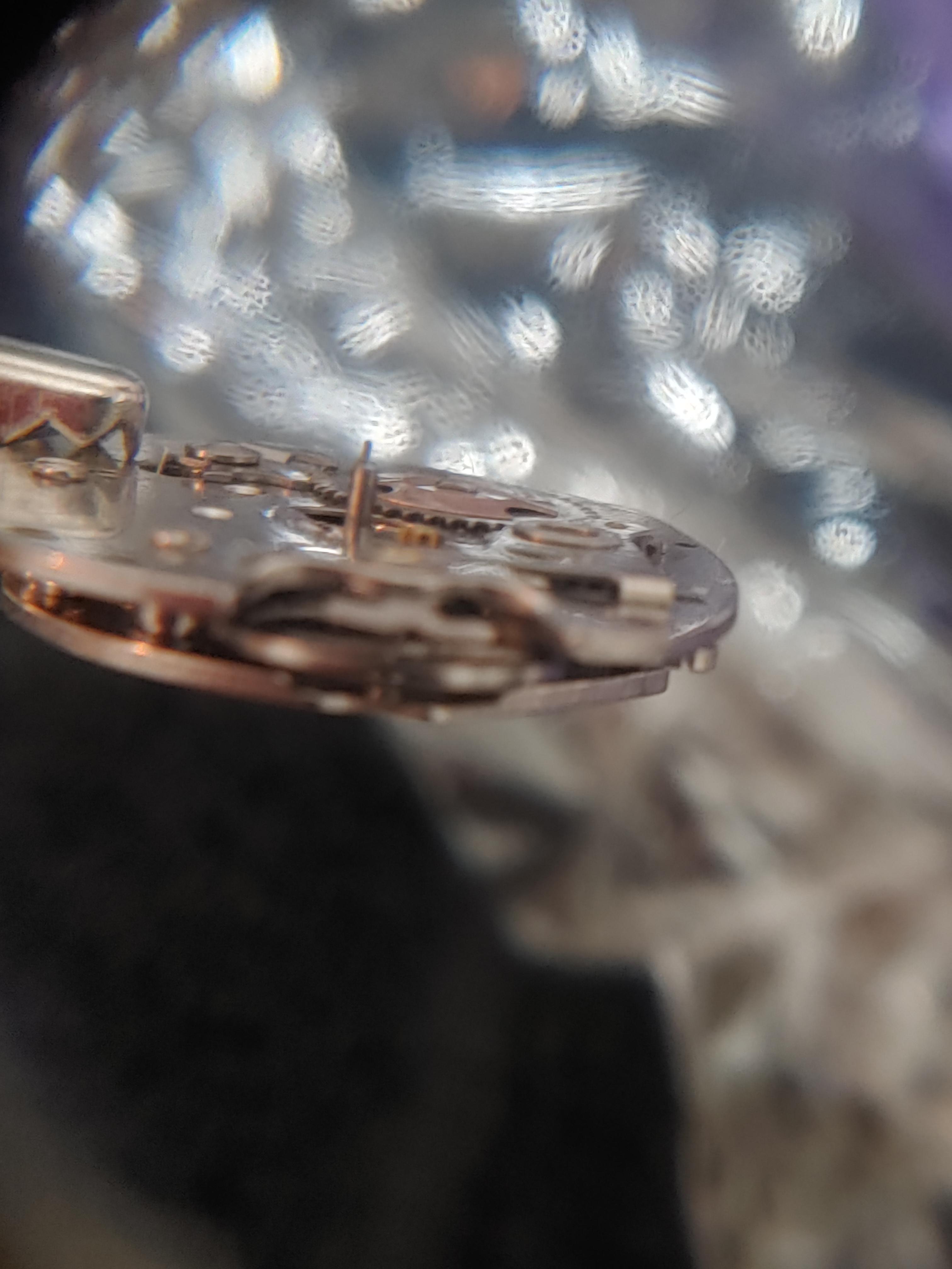

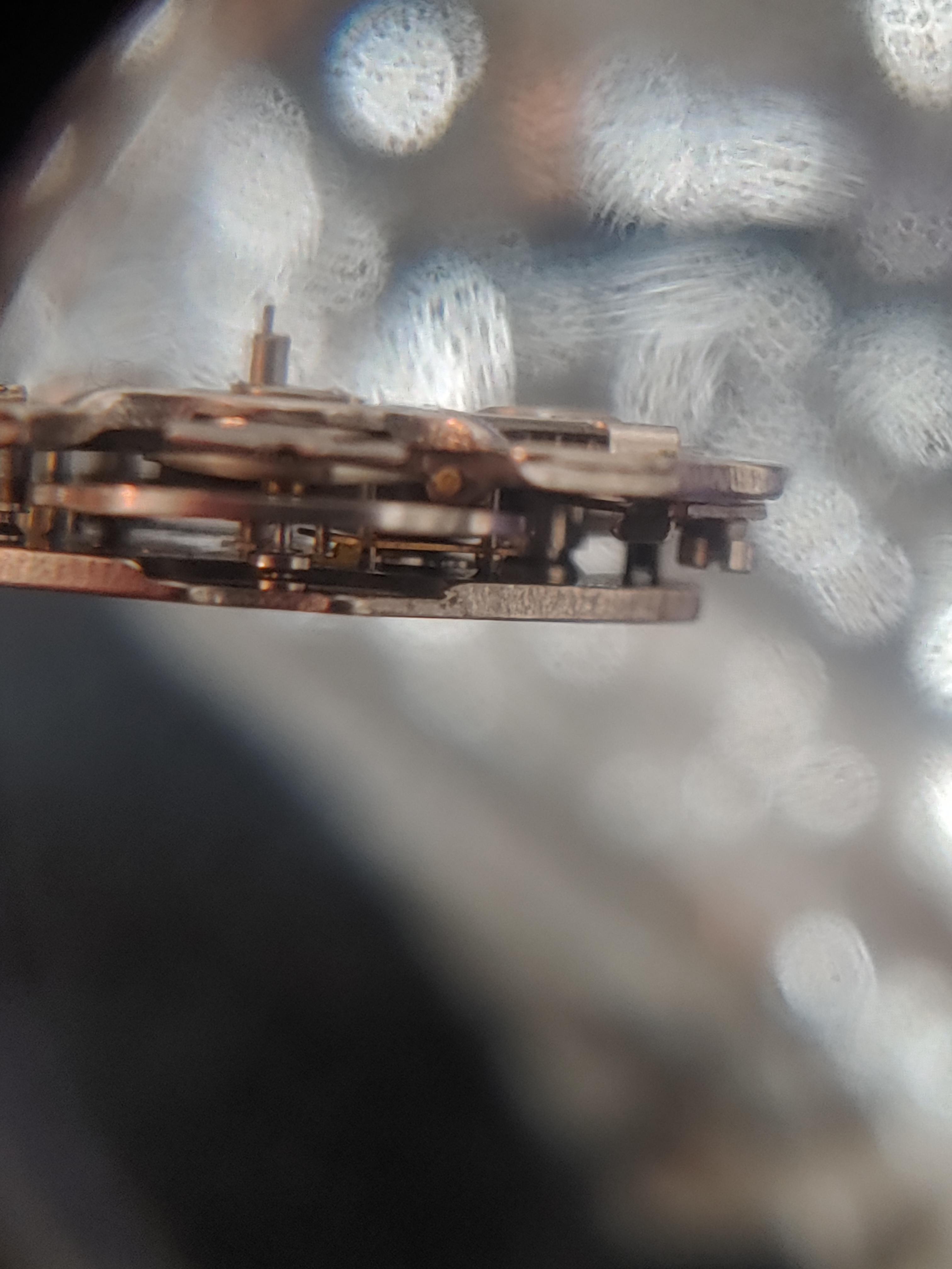

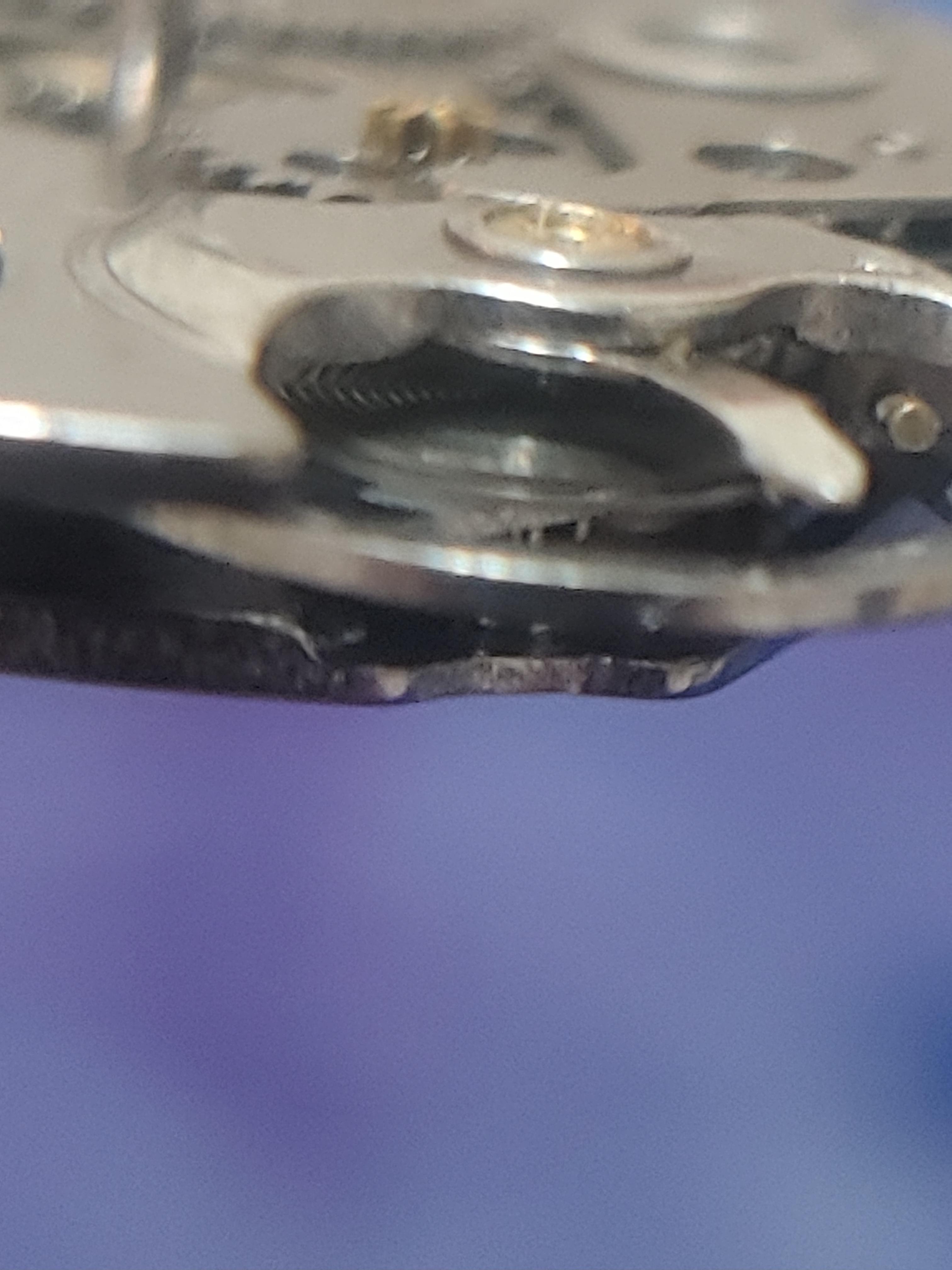

The first 4 pics are the movement running slowly and the others are the movement that wouldn't run
Hmm tricky.. they both look as though the hairspring may not be entirely flat, but the pictures are not that clear.
The one that doesn't run, does the balance swing freely, and does the fork move back and forth (albeit for a short period before it stops)?
I think one of the hairsprings was sitting a little crooked. I'll try to take some better pictures tonight. How would I straighten it out? Do I have to remove the balance and re-pin the spring?
On the one that doesn't run the balance moves when rotated with a finger but won't turn when wound.
Thanks for all the help, I really appreciate it!

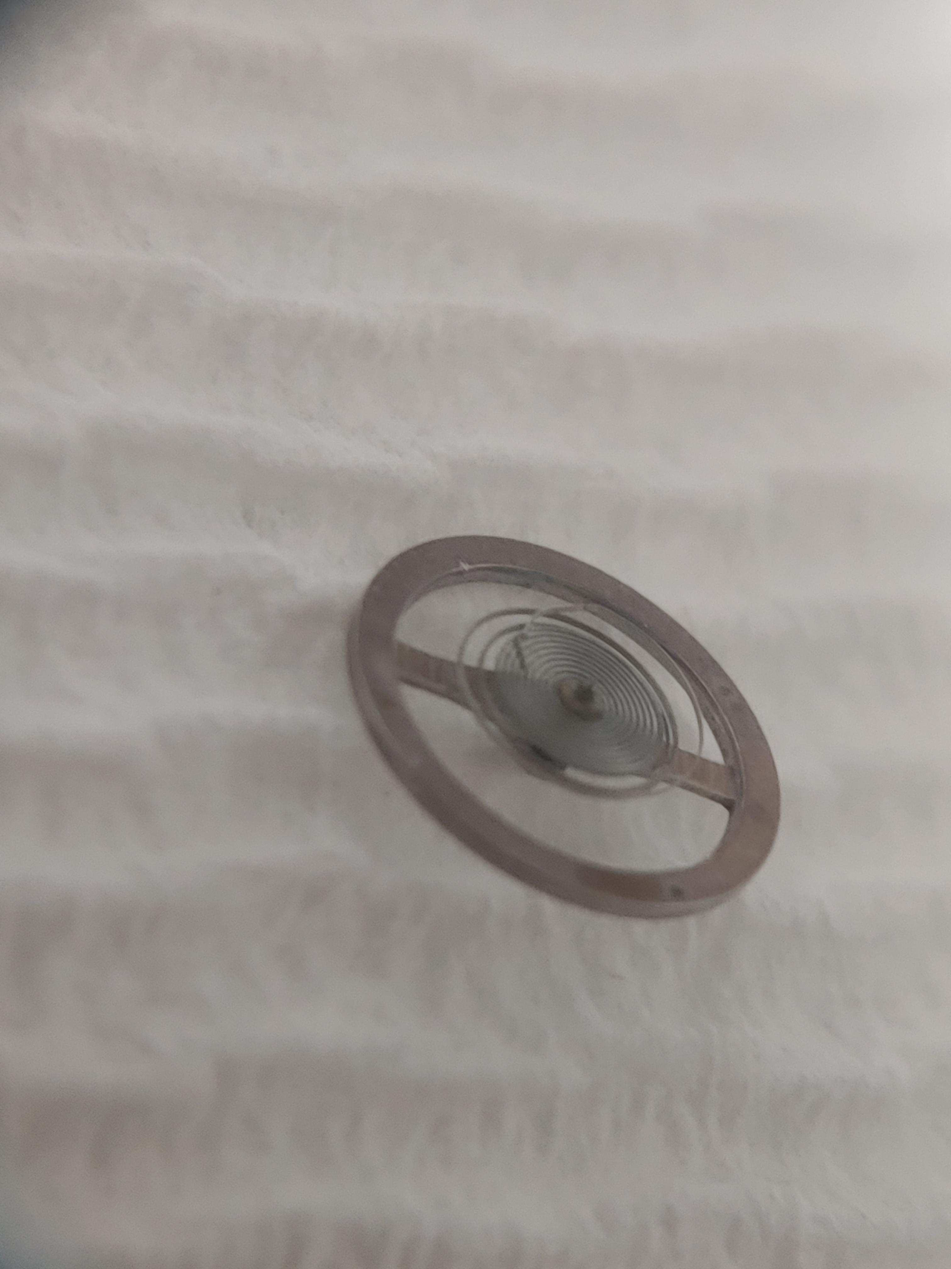

Better pictures would help us diagnose the hairsprings.

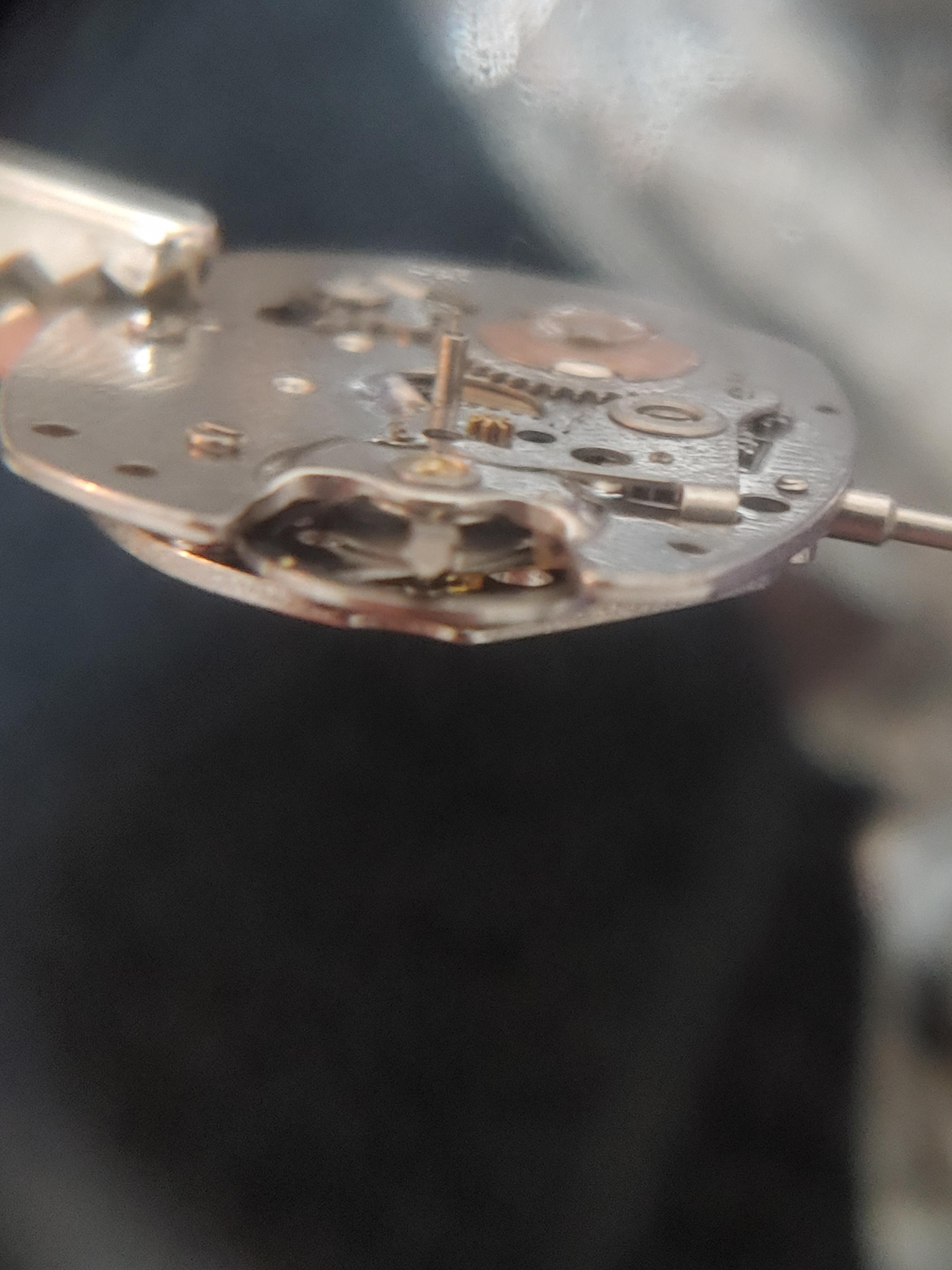

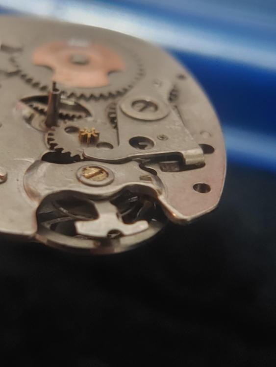

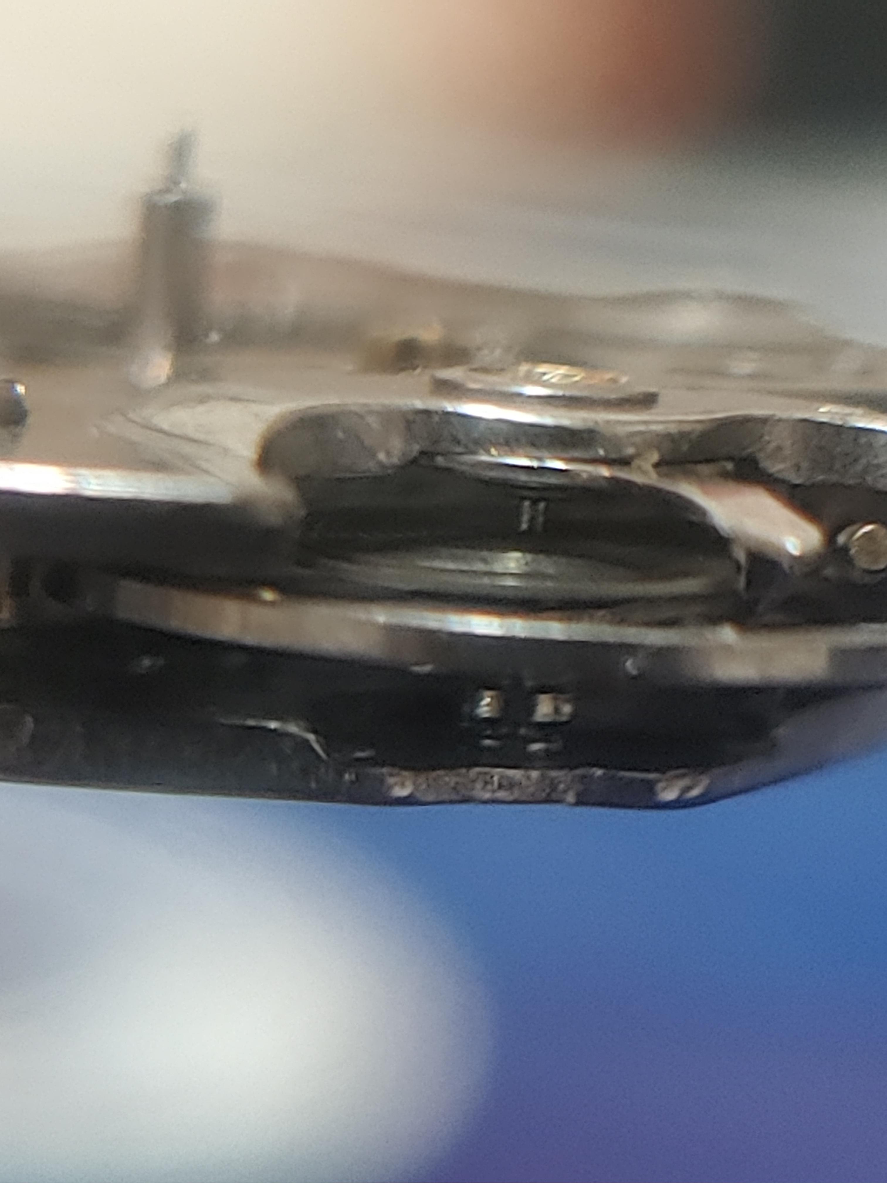

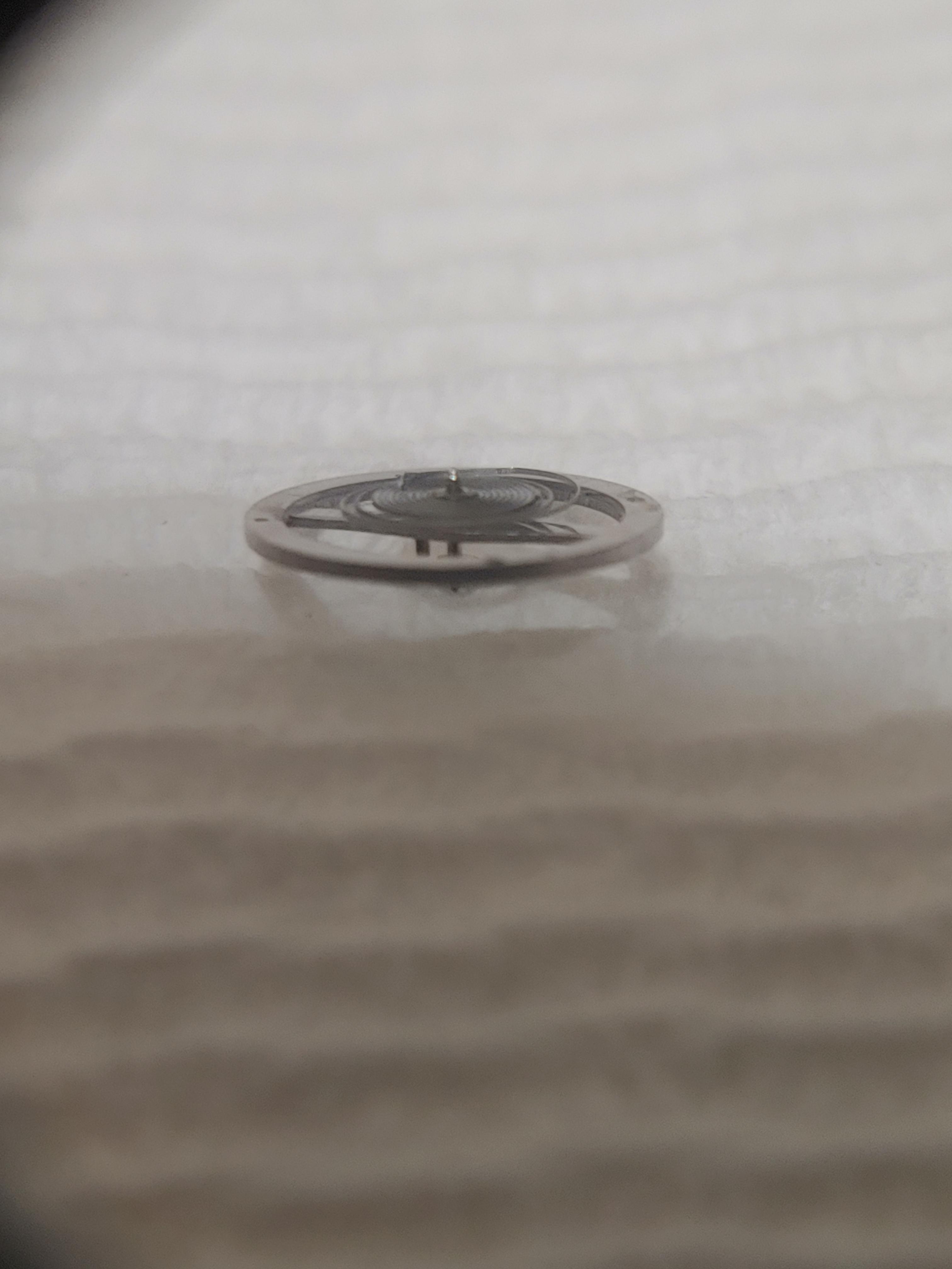

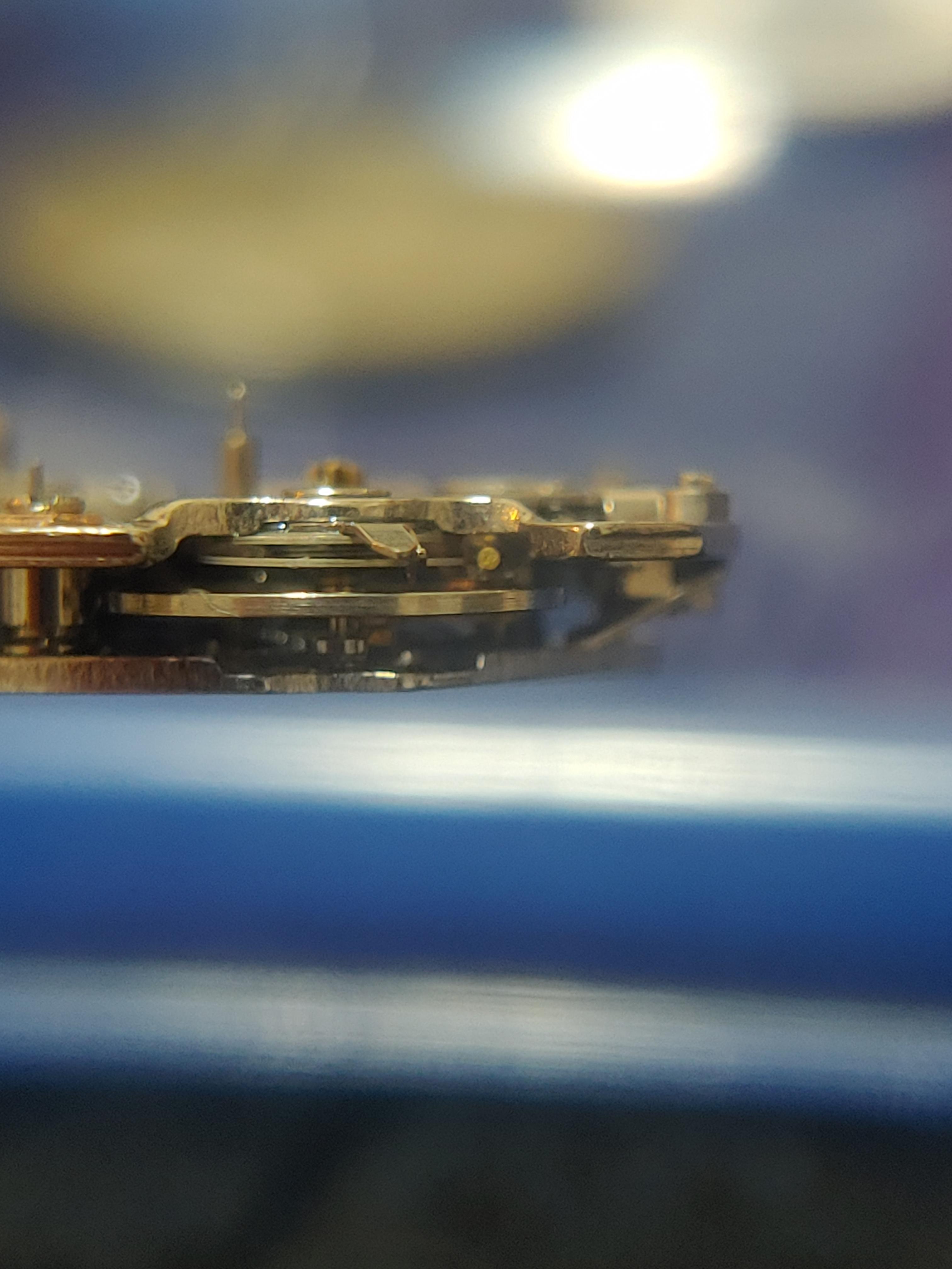

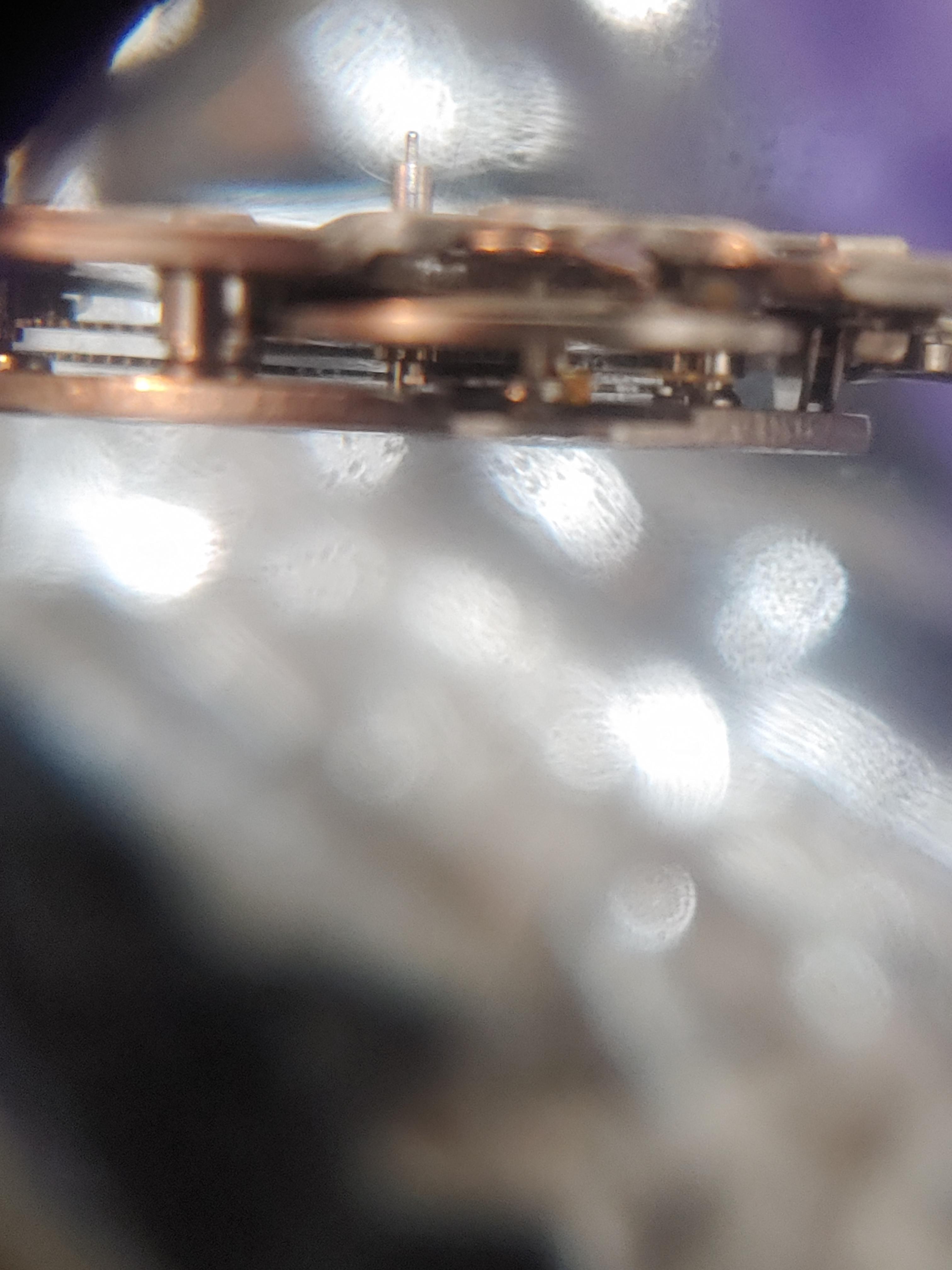

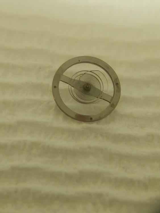

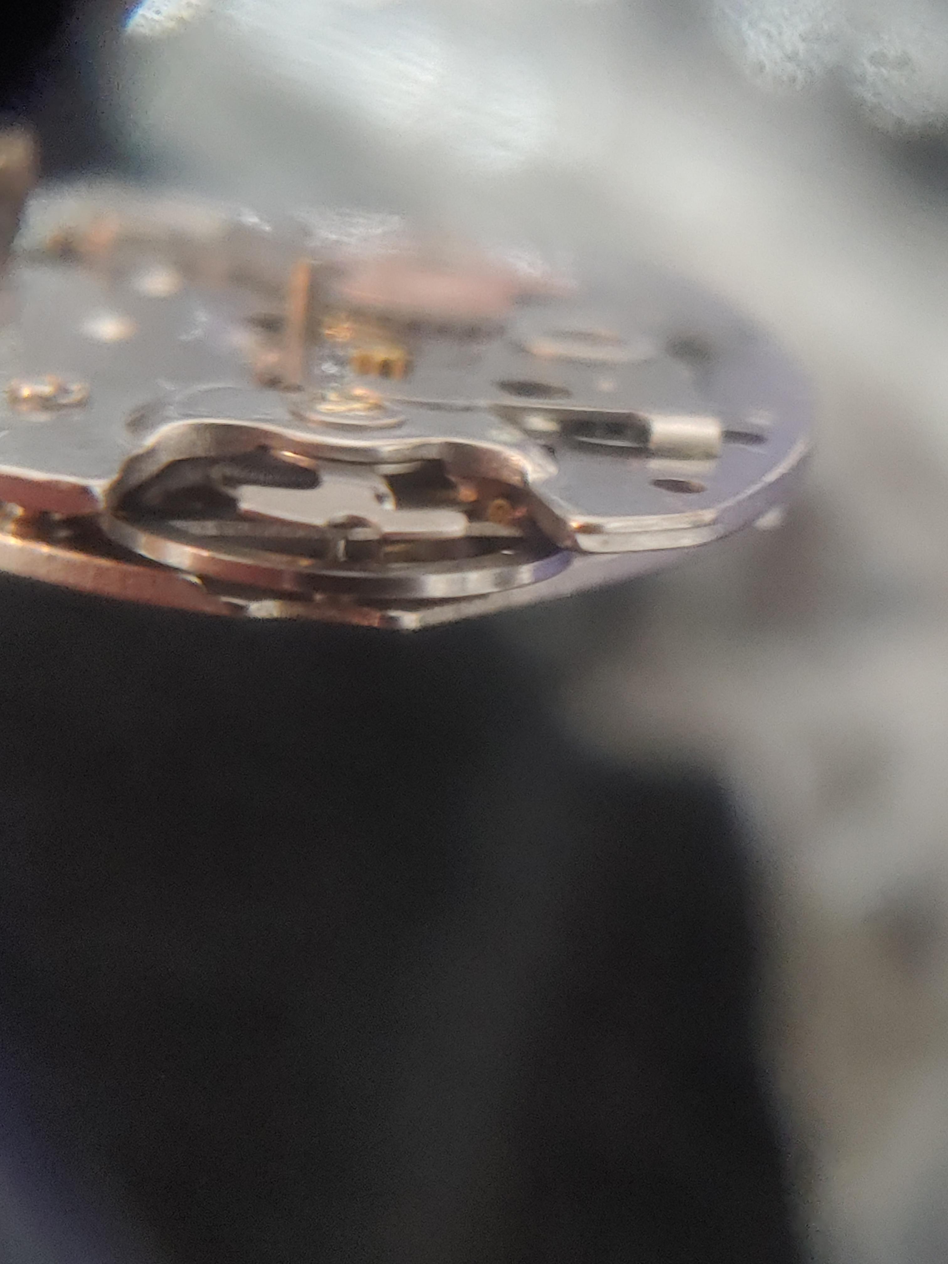

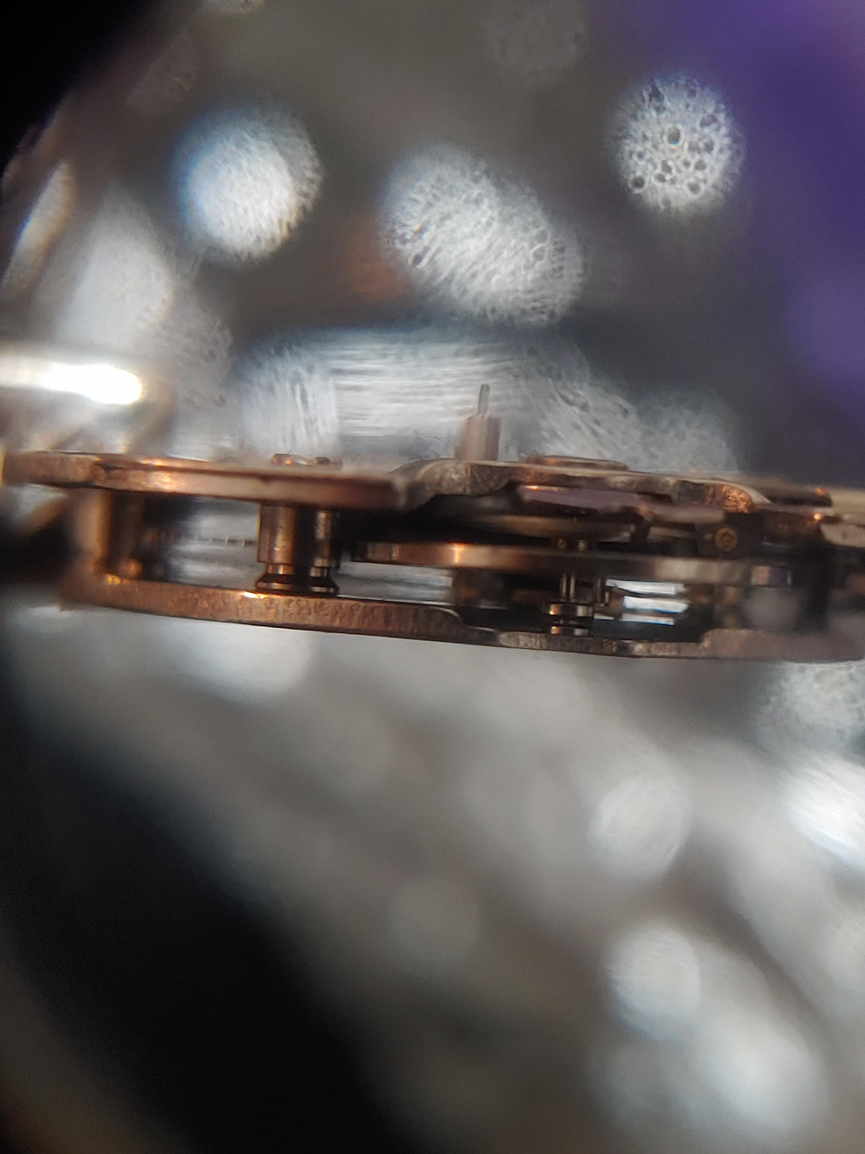

Here's a bunch of photos. Hopefully these show it a little better. I'm going to break the photos into 3 post. The first post slow running. Second post not running, third is another I pulled out where the spring looked really off. Is there a guide somewhere on correcting the mainsprings?
15 minutes ago, JerseyMo said:
are you workig on a 105 0r 106? oh I see the picts now - that is a 24
The first two were 24s and the third is a 25
Edit: Good eye you nailed all of them
Is there an easy way to reposition the hairsprings?
Edited by dups68
Ah okay was hoping to avoid that but I'll give it a shot if I have to. I saw an old post of yours on removing the balance/hairspring:
Once removed (and possibily demagnetized), should the hairspring just settle back into place?
Also, the the hairsprings on the two #24 movements look off to you?
Edited by dups68
How good are your fine motor skills?
Watch those two videos, and you will get a good feel for what is involved. The secret is to make tiny adjustments, and take your time. Patience and care. When you start going cross eyed, and feel like throwing in the towel, take a break and come back to it later when you are fresh.
@JerseyMo may have these balances available as spares, but learning to fix them is a worth while watch repair skill to develop.
