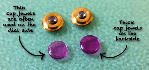

You can shim the cock at the outer bounds, to lower the cock jewel. Cut a piece of thin aluminium foil to place in-between the cock and main plate .
In cases a pivot is worn short, I usually flip over it's relevent end stone to face the domed side towards the balance jewel. This will compensate for the wear and reduce end shake, thence , reduce positional variations. You would need to bend its relevent spring inwards the jewel-chaton, to hold down the jewel assembly in place.

Do you feel side shake on both upper and the lower jewels? Or just one.
Both upper and lower Jewel-chaton assembly and holes are to be the same size on this caliber.
 Staff pivot should not jump out of the jewel hole as you lift one side of the wheel( balance wheel) a gentle lift. Perhaps a damaged jewel hole, wrong jewel-chaton and if the shock springs are so loose to let the jewel-chaton move inside the housing you will effectively feel the loose play as side shake.

First, what is a “jewel-chaton”?
It moves side to side a great deal. Mind you, 30 seconds a day is not horrible for a watch of this age. But it can be better.
The cap jewels are domed on one side so I can’t turn them over. Also, the cap jewel casing is square. I looked on cousins and I believe the balance jewels and cap jewels are round. The balance jewels also look like the Seiko 7 I just completed, encased in a spiral type silver metal. I want to order the replacement jewels first. But I can’t tell if I’m looking at the right part on the diagram.
The metal part is chaton. If the wrong one ,obviously small ,it can move inside the housing. And you feel that as end shake.
Seiko type jewel or casing in an ETA is news to me. Perhaps Eterna used it in this ETA.

Pivot jumps out of the jewel hole easily if the side shake is due to large jewel hole.

So, it is back to your first diagnosis, wrong jewel with larger hole, in which case the pivot should easily slide out of the larger hole, just gently  lift one side of the wheel, I grab one side of the wheel with a pair of tweezers and lift gently.
End shake has to do with the distance between the two end stones, you adjust by reducing the distance, ideally end shake is to be set about 0.02 mm.
End shake adjustment would reduce amplitude variations in FU and FD positions.
A larger jewel hole hardly impedes oscillation to cause poor amplitude.
