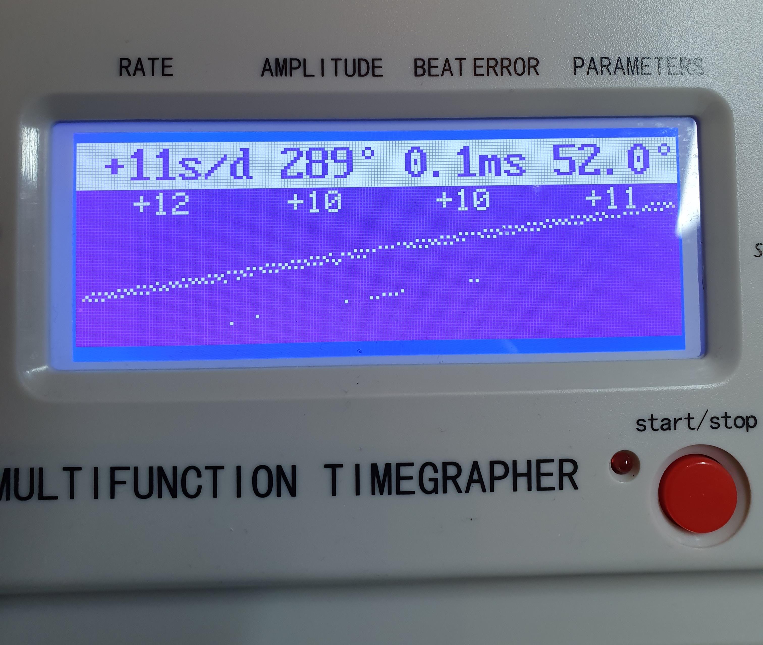

Guys, can you give me some pointers please, close to throwing the towel in here.
I've been doing this for a couple of years now and I'm getting really frustrated with my progress. Literally every watch I service has worse results (or the same) than before I took it apart! And I'm starting to think what's the point, I want to succeed at this but it feels like a losing battle...
For example the watch I'm working on right now a chinese clone movement. It is a brand new movement and was running at a solid 300 amp fully wound, keeps perfect time within a few seconds per day. I thought with this one I won't wash the balance/pallet fork/mainplate. Just to see if that makes a difference to my results. I washed the rest of my parts in my ultrasonic in some acetone (other times I use isopropyl or petroleum ether as recommended here). I've put it back together and dial up it's running at 270 and dial down 230. What could I have possibly done that's worse that the way these are assembled in China. There were a lot of random oil spots and they're generally assembled in dirty conditions.
I've taken it apart again and cleaned the gear train again. Cleaned up the oil from the movement that was there when I took it apart. End shakes look good. Stones are lubricated. Gear train moves very freely when I turn the crown.
I've done all of marks courses and the No Bs watchmaker course and understand how to service a movement but rarely see good results..
Any advice appreciated

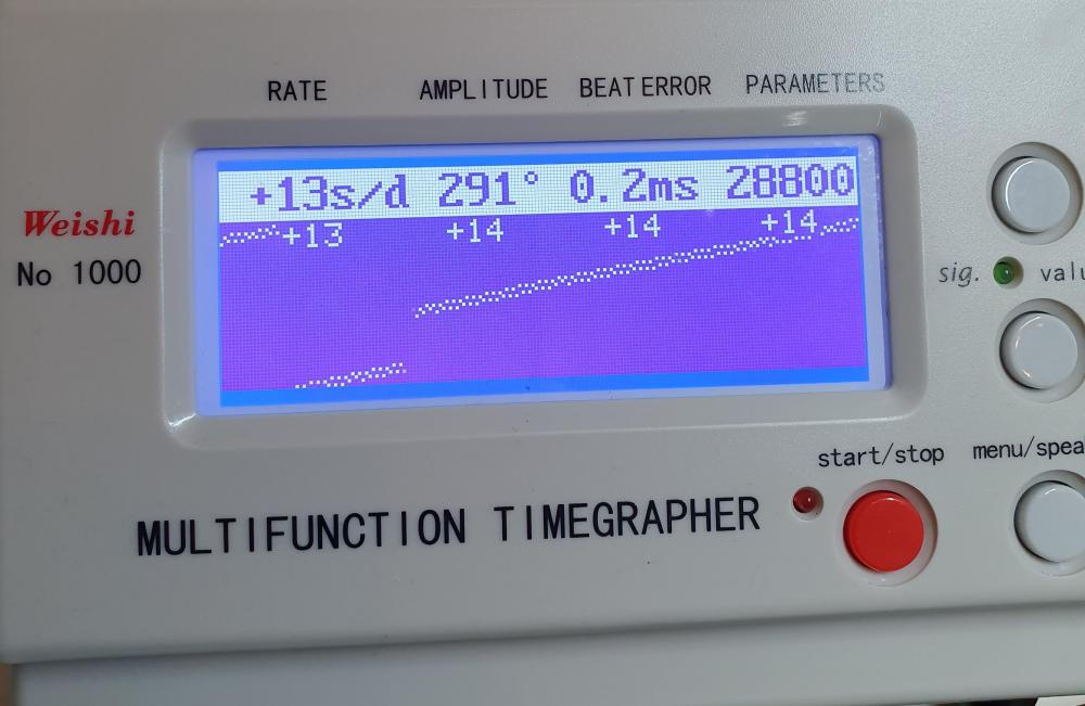

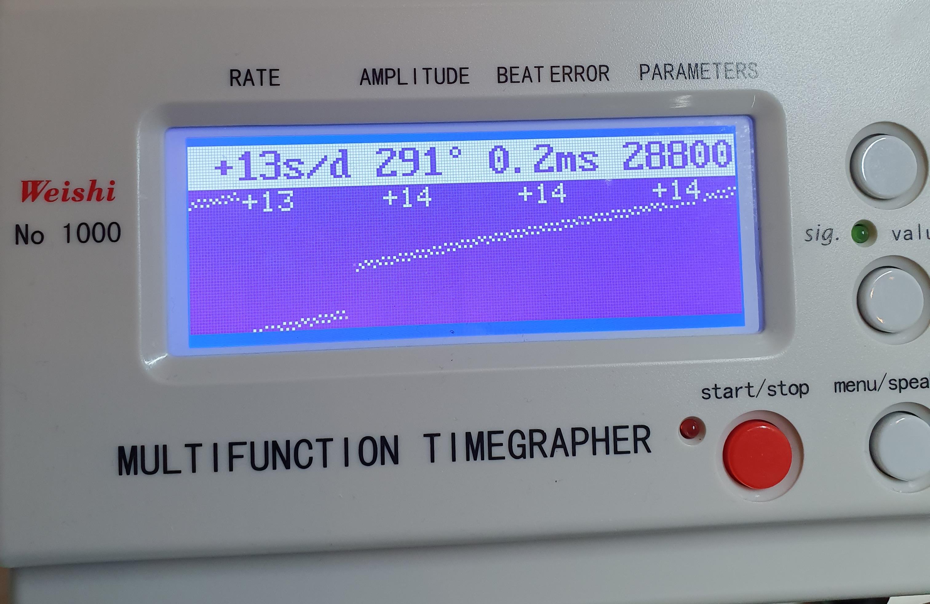

59 minutes ago, AP1875 said:
A question regarding the recent timegrapher. Do the spots indicate dirt on the pallet stones?
No.
They indicate that the 1st pulse of the tic noise was too low to be detected. A later, higher pulse in the noise triggers and gives a displaced (=later) dot.
Frank

3 hours ago, AP1875 said:
I swapped the balance and these are the readings...
Obviously miles better. So something must have happened to the other balance? I can't see a bent pivot, jewel looks OK, shock spring is still in place.it wasnt washed, literally removed placed in a dust free tray and then installed again. Any ideas?

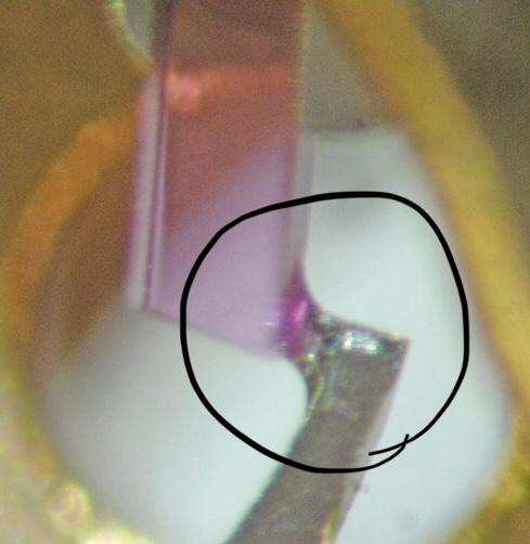

On 1/21/2020 at 3:09 PM, saswatch88 said:
After oiling the escape wheel teeth like you normally do put the escape under magnification, you should not see any oil or wetness on the teeth after a few minutes of running the watch, if you do you used too much. They should look dry. Also are you oiling the pallet pivots? Because you should not be.
I have some doubts about this. If you refer to the Omega rules for lubrication manual, it calls for a check of a wedge of oil between teeth and stone after 24 hours of running, so dryness after only a few minutes would certainly fail this check. It  also suggests the use of epilame in conjunction with 9415.
You should not see any wet on teeth that are not making contact with the pallet jewels. Many manufacturers use epilame even on train jewels, but i said its not needed  with 9415 unless the manufacturer calls for it which yes omega does but i dont service omegas, and this is a Chinese clone. One thing i know omega does not say is use epilame and 9415 on every 3rd tooth of the escape wheel. And......This was a quote from one of my previous responses which was taught to me by a certified omega watchmaker.
“as you move the pallet fork, and the escape wheel tooth starts to come across the impulse surface of the pallet fork jewel, you will see a small wedge of oil form in the angle between the tooth and the jewel. If that forms when the leading edge of the tooth is about 1/2 way across the surface of the jewel, that is the right amount of oil. If it forms earlier than that, it’s probably too much, and if it only forms very late as it moves across, that’s probably too little. Its not just a matter of looking at the escape under a microscope with no action.”

Oil wedge which shows too much oil, the wedge should form in the middle. If epilame was ran on the escape prior, some will transfer to that tooth and linger, at this time the entire escapement will need to be re-cleaned and oiled.
