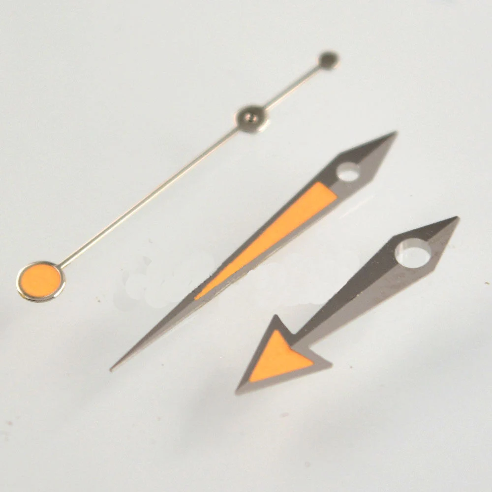

19 minutes ago, Chopin said:
These could work, perhaps...
HTB1gFwtSFXXXXaCXXXXq6xXFXXXt.jpg?size=141745&height=1000&width=1000&hash=3bd7fd9bf3fe3dcd8a7d7c99fa8670ed
Nice...
I was going to suggest these...
s-l1600.jpgbut you say no snowflake.. so maybe...
.. but the yellow lumed ones above looks good.
I'm quite taken with these, but I think they wont match your dial.
it was going on an a Miyota manual wind movement but unfortunately it wont fit as the original dial was dished so the movement sat lower in the case, I cant find a  mechanical movement where the stem is 1 mm from the dial so It is going to be a quartz Ronda movement hand sizes 120 70 20
