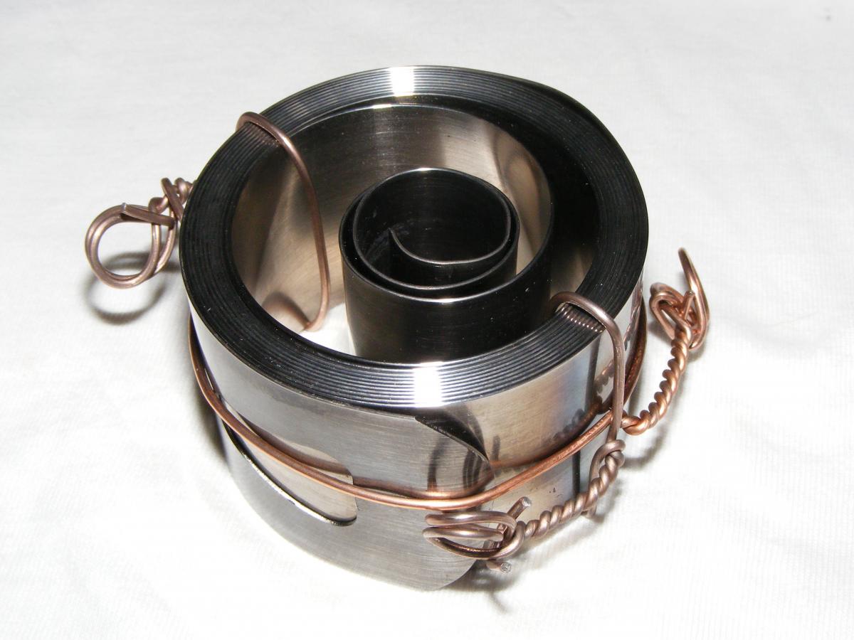

I mentioned in another part of the forum that My Brother in Law gave me a carriage clock to repair, his wife was winding it and lost concentration and felt a click through the key but it stopped working. I have had some valuable general advice already but here are some photo's. one of which seems to confirm that the spring has gone.
This is an 8 day, 2 Jewel unadjusted clock by Aug. Schatz & Sohne (Germany).  There is a 59 in a circle on the clock back and also a 5 and a 75.  Clockboy has kindly given me some advice on the origin, date and worth of the clock.
As you can see from the barrel where I have marked, it appears that the spring has broken, the location of the small piece is beside what looks like a rivet on the outside of the barrel and the end of the main part of the spring is loose.

Can anyone advise whether it is just a case of getting the old spring out and measuring the length and diameter and width or thickness and getting a generic spring.
That is exactly what I would do if I worked on clocks.
Cousins list 2 different main springs for a Schatz 59; 123234 & 123834. The middle two digits (32 & 38) refer to the spring thickness or strength.
All you need to measure is the thickness of the original and you should be good to go
Thanks Mark and Marc,
Felt like a bit of a wimp with my safety glasses and gloves on but as clockboy intimated they proved necessary as when it came out it came out fast and uncoiling and the broken and sharp bit curved round into the back of my hand.  Thankfully no damage to my pinkies though.
Measurements are 0.48 mm thick 11.9 mm wide and approx 950 mm long which does not quite add up to the schatz listing.  However rounding up to 12 mm by 950mm I think i have a match off the generics.  Will check further.

Might have guessed that it was all going a bit to well.  Cousins sell what is supposed to be the mainspring for the Schatz 59 but the measurements they quote are not the same as the spring that came out.  I went back and re-measured twice but I still get it to 0.48 x 11.9 x 950 which is probably going to actually be 0.45mm x 12mm x 950 mm.

Have you tried Meadows & Passmores if my memory serves me right there is a calculator on their site on how to purchase the correct spring size. In my opinion their springs are superior to those supplied by Cousins as the mainsprings from Cousins seem too stiff. Providing the new spring is not to wide and rubbing on the barrel wall the slightly weaker spring will be fine. You could actually repair the broken spring if stuck. I have never done this but I have read that you can re-drill the retaining hole with a diamond drill.
I made my mainspring winder and there are vids on you-tube showing many mine is a copy of the wooden construction one shown. Not the best but it works. Fitting a new spring without a spring winder is going to be troublesome as the new springs come pre-wound and held together by wire. I presume you do not own one so you will have to do what I used to do. Put the new spring in a vice (length way) then unwind the retaining wire to release and then gradually unwind the vice very,very gradually to release the spring. WEAR SAFTEY GLASSES AND THICK GLOVES IF IT SLIPS IT **BLEEP** HURTS.
To re-fit he spring or fit the new spring I found this on the M&P site.
If you removed the mainspring from a barrel, it must now be re-fitted. If you do not have access to a mainspring winder, you will need the strong leather gloves you should have used to remove it. Having thoroughly cleaned the spring of old lubricant, wipe the surface with a rag coated in mainspring grease. It is not critical to cover the whole surface, because as the spring winds and releases during use, lubrican will spread naturally.
Insert the outer end of the spring onto the hook inside the barrel. When sure that it has engaged, start to turn the spring into the barrel and after each half turn, rotate it. If, after a turn or two you don't think your wrists are strong enough to finish the job, go back now. Once you are half way, you cannot let go and will need to finish the job somehow. Wind in the spring by hand until the centre coils pop in. Take great care with mainsprings as they contain a lot of energy when coiled.
Hope this helps
After some searching I found a spring on the bay that is 12 x 35 x 26 x 950 which is very similar to mine which is 12 x 45 x 33 x 950. After some research I think these measurements refer to width in mm x thickness (in hundredths of a mil) x Barrel Diameter in mm x length in mm.  This would mean that the new one should fit in the barrel and the main difference is 0.1 mm in the thickness.
Don't really know what this would mean in real terms but I thought I would give it a try and if it does not work I will have a shot at cutting down a generic spring that I found which matches up in every respect except length - we shall see if I have managed to turn an 8 day clock into a 7.5 day clock (:-))

I watched the video about the mainspring with much interest and thanks to Al I now know I have knackered the original spring by bending it backwards so I can't re drill it - well have you ever tried measuring the length of a coiled clock mainspring ? Still it may be good to practise on.
Cheers,
Vic
The 0.1mm difference in thickness will make no noticeable difference in performance. As I have stated in a previous post providing it is not to wide and rubbing on the barrel it will be fine. Obviously the shorter the spring the shorter the clock runs before a re-wind.
