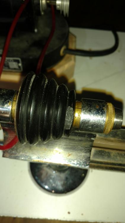

The lathe is barely used, but some time in the past it got knocked around and theres a big chip in one of the pulleys on the headstock....  Does anybody know what the plastic/rubber compound is and/or is there a good way to repair/recast the broken part?

Pulley divot:  Don't worry about it, it won't affect performance (post a pic, I'm guessing its not half the pulley).  Its probably bakelite and these can be repaired by grinding up/sanding into dust some of the parent material, using that to colour some epoxy, and apply.  Its a pita and not worth it for this, imo.

....Pulley divot:  Don't worry about it, it won't affect performance (post a pic, I'm guessing its not half the pulley).  Its probably bakelite and these can be repaired by grinding up/sanding into dust some of the parent material, using that to colour some epoxy, and apply.  Its a pita and not worth it for this, imo....
Thanks for the help. I actually had the headstock apart today and it's in very good shape. No visible wear, for that matter, no visible wear on the headstock pulley either. The lathe has patina for sure, but from a wear standpoint doesn't appear to have seen much use. I'll be surprised if it's Bakelite. It's hard, but feels like it deforms a little under my thumbnail when I press hard. You're right that it won't make a difference though. With the motor I'm using I probably won't ever need to use that notch! It just bothers me. I don't mind the putting on the chrome or other patina, but functional defects get under my skin.
Here's the chip. I'll take better pictures once it's properly set up.

Just use JB Weld and form a piece in the gap, then file it to shape. I have done this and it worked well.
