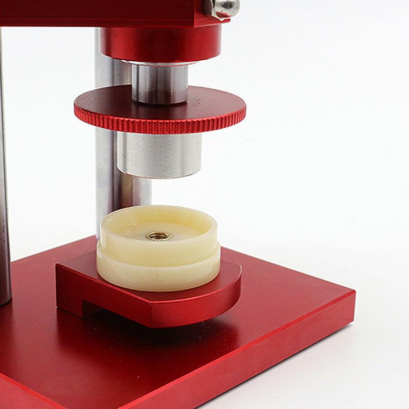

Currently, I'm using a chinese copy of the Bergeon 5700-Z, which has served me well, but the tolerances are not perfect. The bits that attach onto the bit holder do not sit parallel onto the casebacks I remove ( one sits slightly higher than the other ), which causes a large risk of slipping and scratching casebacks. In addition, the bit holder does not adjust evenly such that the bits don't move equidistantly from their respective sides, which makes it difficult to center the bits perfectly onto casebacks.
As for the crystal press, I'm also using a chinese copy of what resembles the Horotec 07.130, except the lower threads don't sit on the actual base of the tool but are slightly elevated onto an intermediate plate. This leaves a small gap between the actual bottom dye and the base of the press. I've noticed that when applying a lot of pressure onto the tool when setting crystals, the intermediate base where the bottom dye rests on bends slightly down due to the applied force. The crystals seem to be going in very evenly so this has not been an issue, however, I like how the Horotec 07.130 has their dyes sitting on the actual base of the tool so that the bottom and type dye will always be parallel upon applying force downwards.

I just received the same Chinese crystal press you have,  and I had some of the same concerns about rigidity as you. Glad to hear that it hasn't been a significant issue.  I suppose if it does become a problem, it will be time to come up with a metal block to slip under the support.

BTW, my Chinese 5700 doesn't any of the issues described by the OP, and works perfectly. However, the casting isn't perfect, and the some of the bits sent were duplicated. I remedied that easily on the lathe,

I think that can be caused only by the square pieces that hold the bits to be different height, and/or the bits themselves to not be accurate. It should be correctable without any special tool.
Check that the square parts mentioned above are assembled correctly, that is they are inserted on the same turn of the threaded bar. Also, avoid tightening their knobs, so they can align better.
