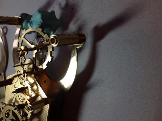

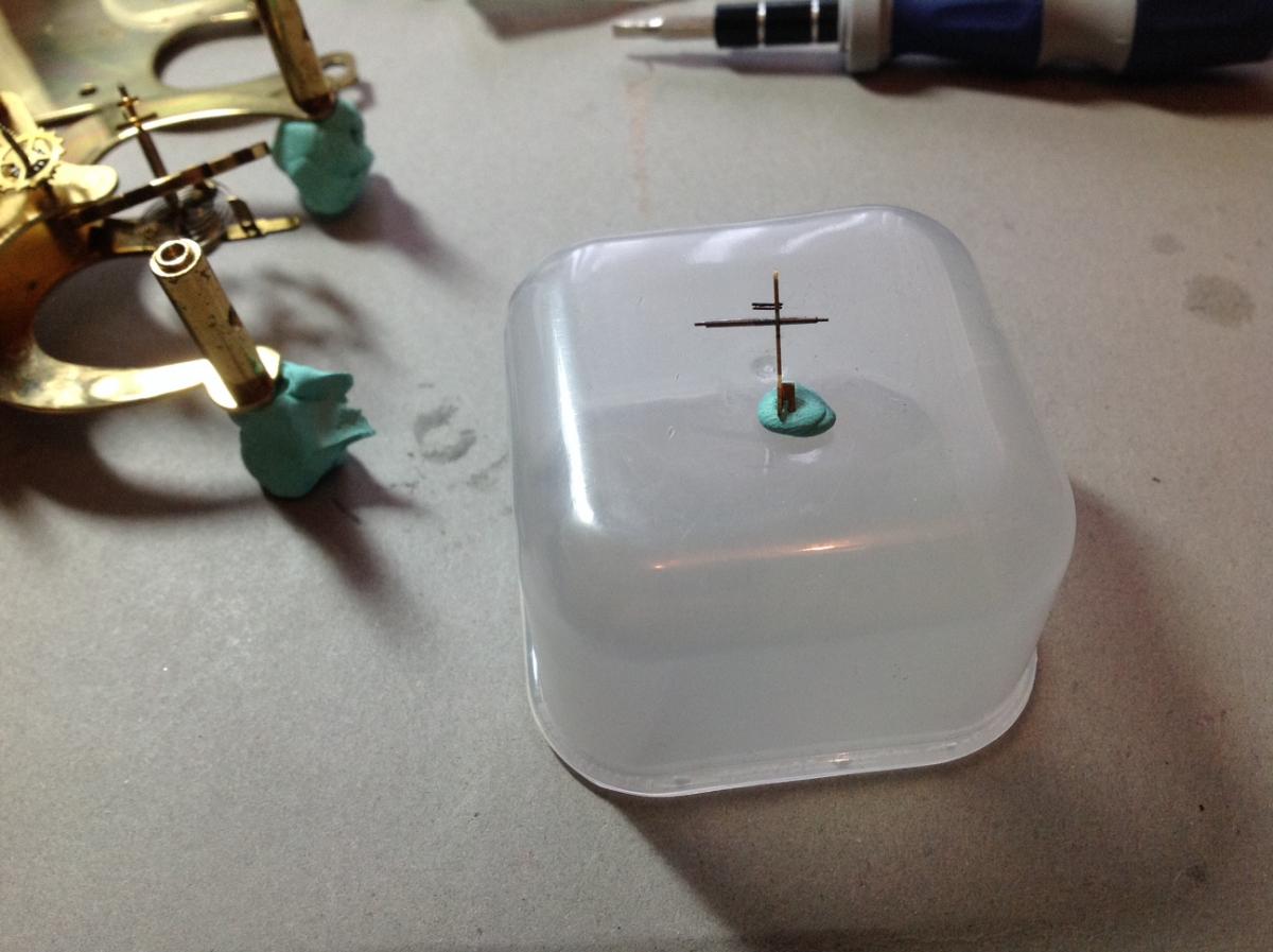

Well I took off the backplate,
Looking at the Anchor it became obvious that both bins were both bent back
I bent them in the opposite direction and they are straight now
Put it back together with judicious use of rodico to keep them near the right place

Great news.  The pins would have been designed to have been perfectly straight. So you should be good from now on. Another fault I have seen is the anchor shaft been bent but looking at your pics no problems. There seem no significant wear on the pins so fingers crossed you could be at the eureka moment.

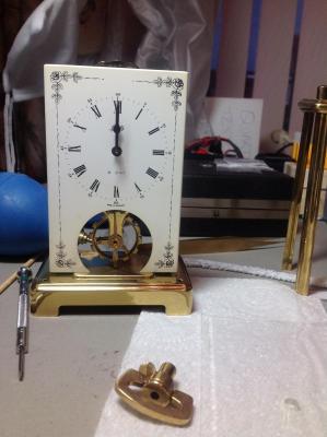

OK time to bring this to a close, got everything ready and the hard work is done so just got to do the rebuild of the case around the clock
Put the bottom on first, two screws that double up as the fixings for the trapdoor to get to the regulator.  Note the four holes in the corners where the screws for the pillars go.
Now the face just two simple screws at the 3 and 9 position on the reverse (sorry I forgot to photo)
Quick look at the back
Pointers on next, note the regulator is slightly towards the plus, I did not notice that originally and it had an effect.
Next the panes simply push into the grooves on the pillars and the whole lot is kept together by the four screws that go into the base through the holes already shown. Then the winder and pointer adjustment knob are fitted the winder screws on anti clockwise and the knob is a friction fit.
And thats it finished. The other clock is a quartz that again came from my brother in Law as it was broken but it turned out that it just needed a clean on the contacts and a new battery.
When I wound the clock it started straight away so hopefully that is a good sign and I noticed within an hour that it was a bit fast so I undid the hatch and shifted the regulator slightly over to minus and I will watch it over a few days and adjust as needed.
