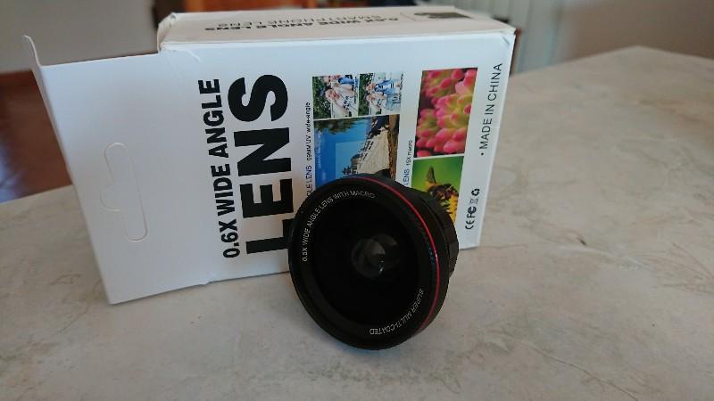

Is your a 0.45X lens? According to this vendor https://www.aliexpress.com/item/32834912449.html
Note : All the market The model 0.45X will take distortion Picture when you use wide angle photos , if you want Anti-Distortion picture , Please choose the 0.6X
So I've ordered the 0.6X.

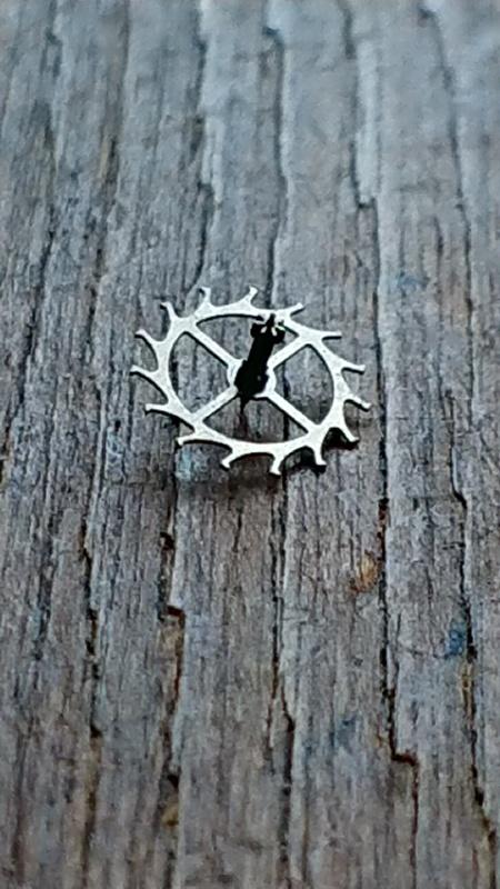

7 hours ago, Nutiborskoku said:
I've tried those clip on lenses and they do work. The downside is that the picture is crisp and sharp in the middle but out of focus around it, like a fish eye lens.
This picture was taken with one of those clip on lenses.

My lens arrived, it's of very limited use for either wide or macro shots on my Sony.
In the context of this thread I think it's important to show what our member VWatchie gets with an Iphone 6S and a $10 lens.
