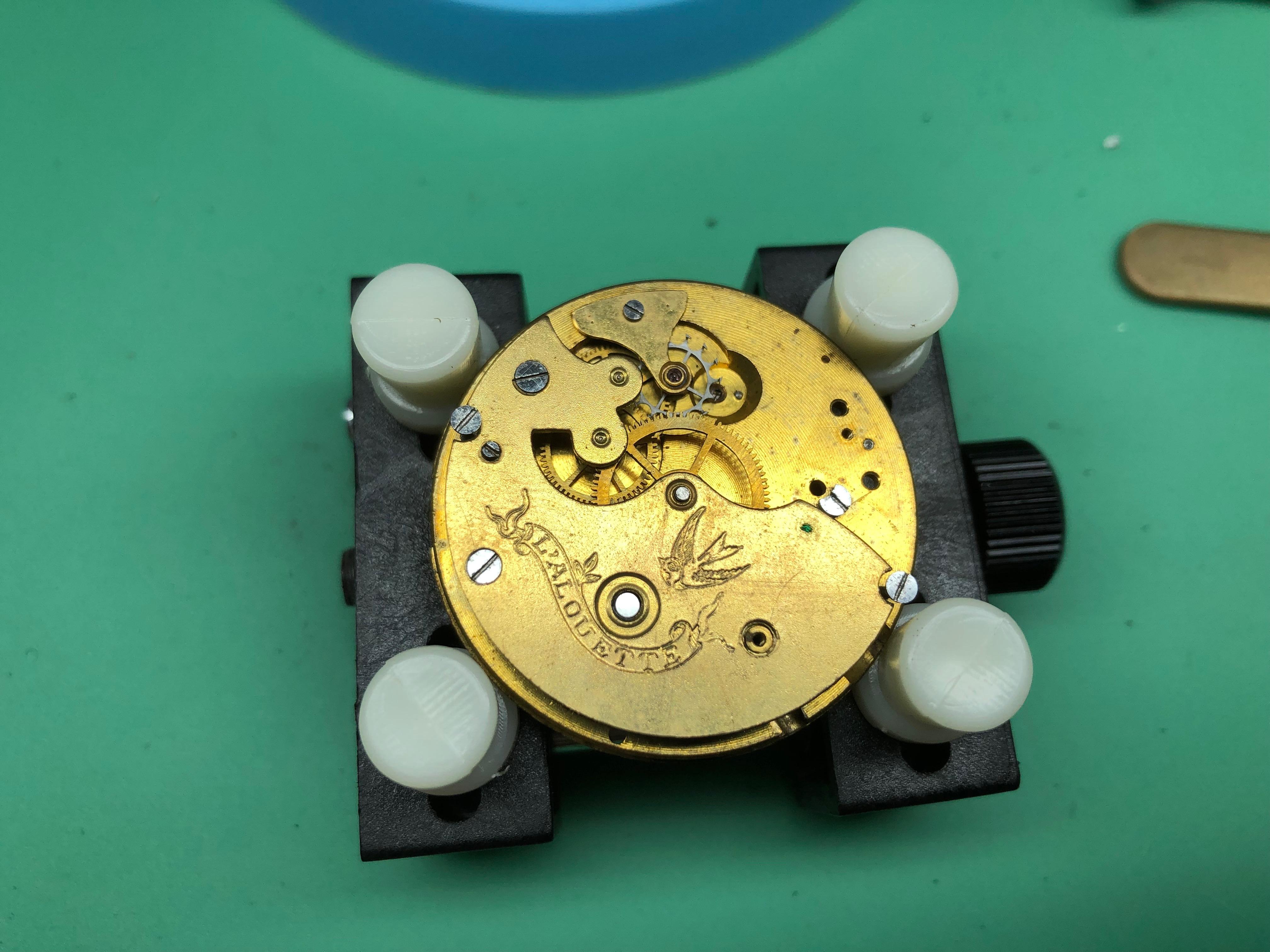

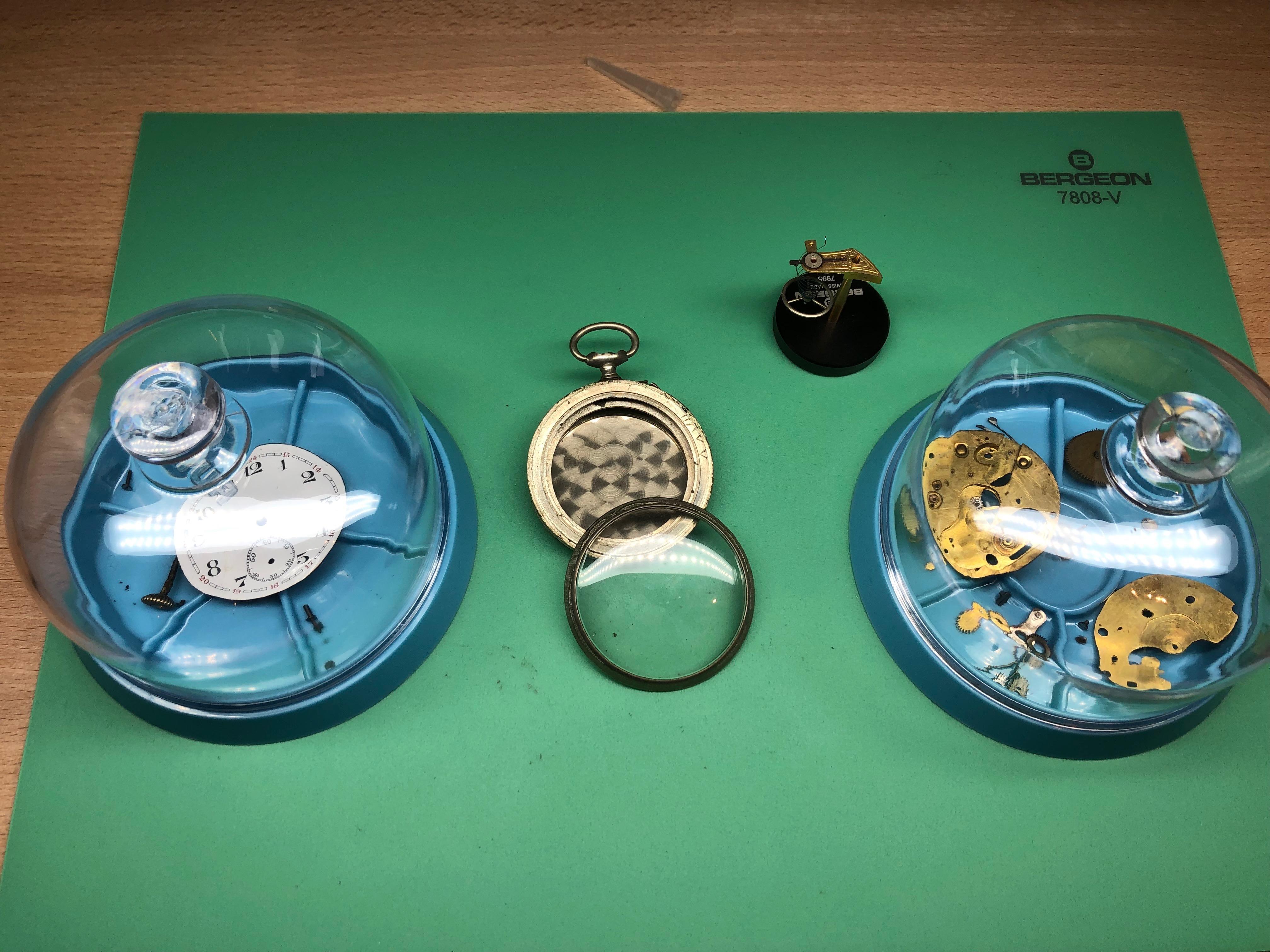

Started my 3é pocket watch repair...
Koen
So here the 3é one...

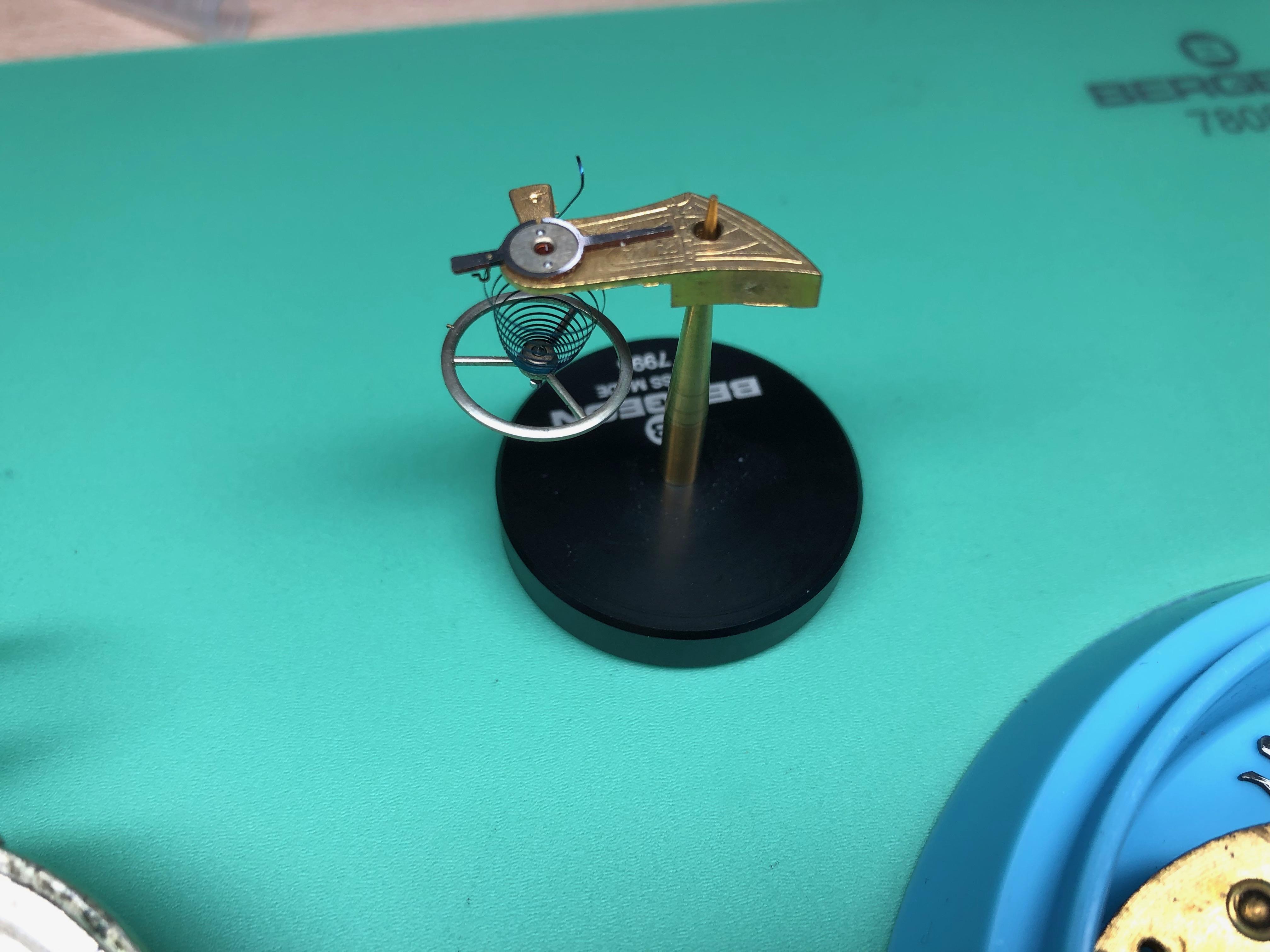

This one is not working, also a cylindric balance...

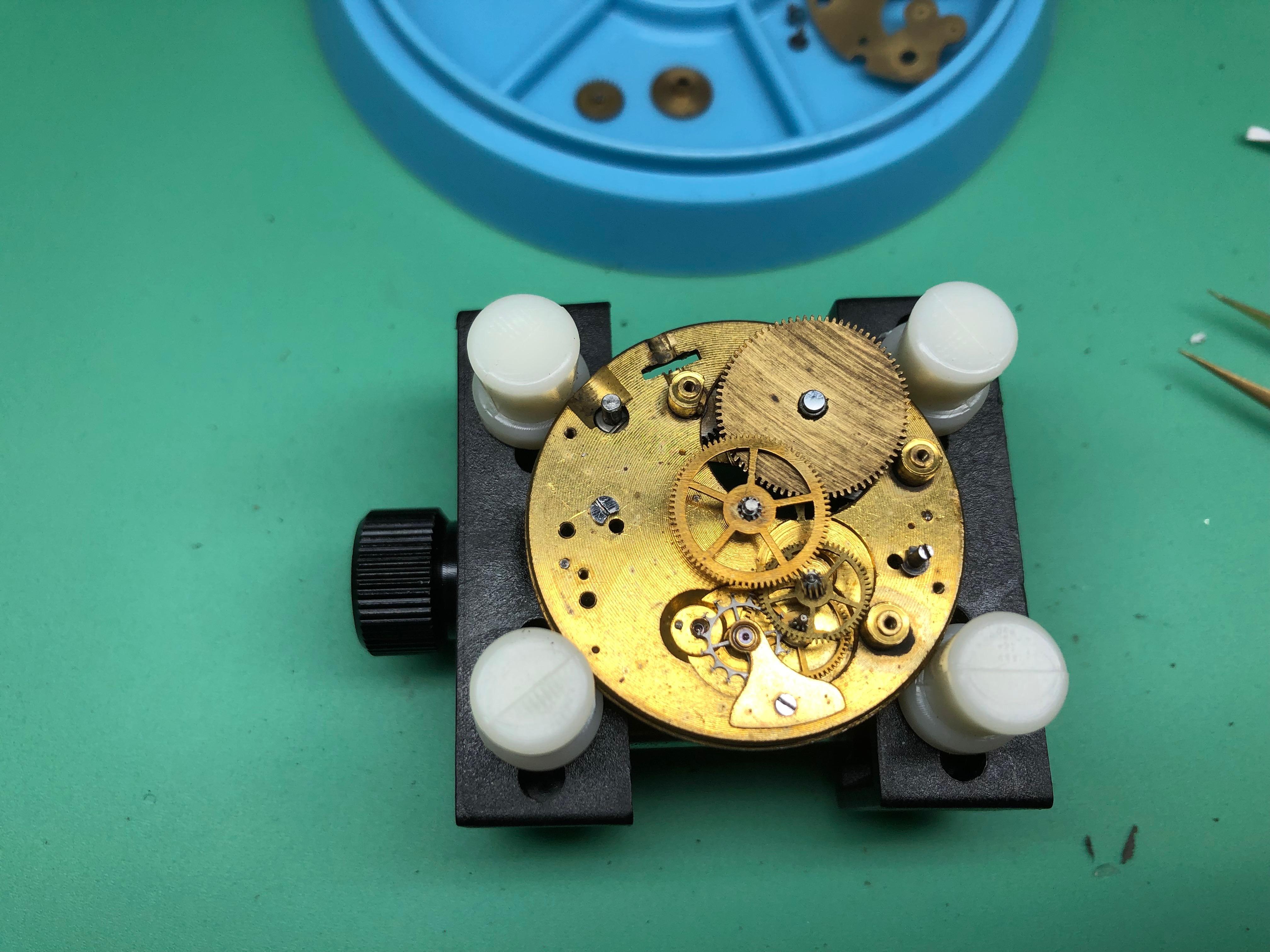

Oil and grease is dried out.

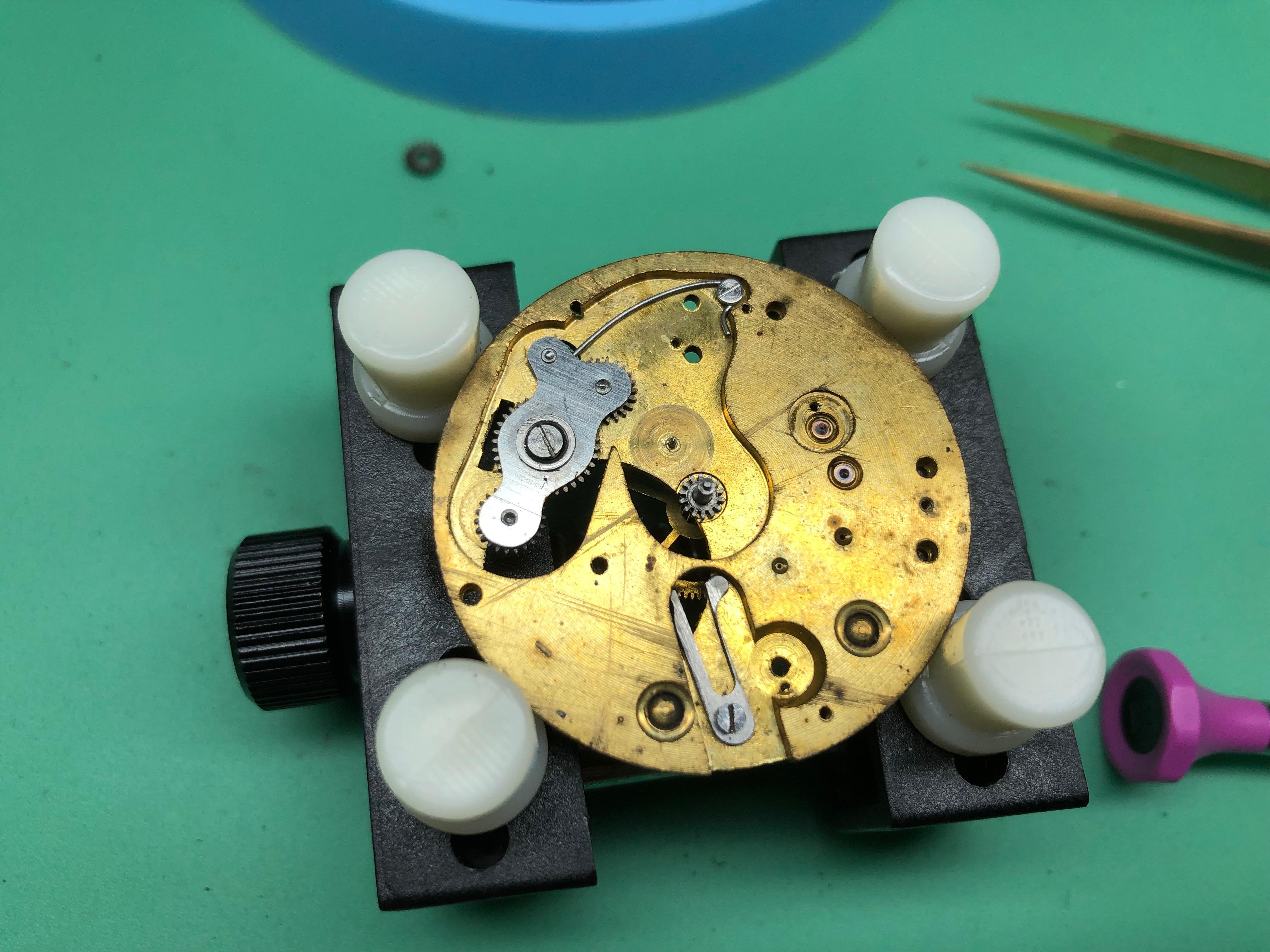

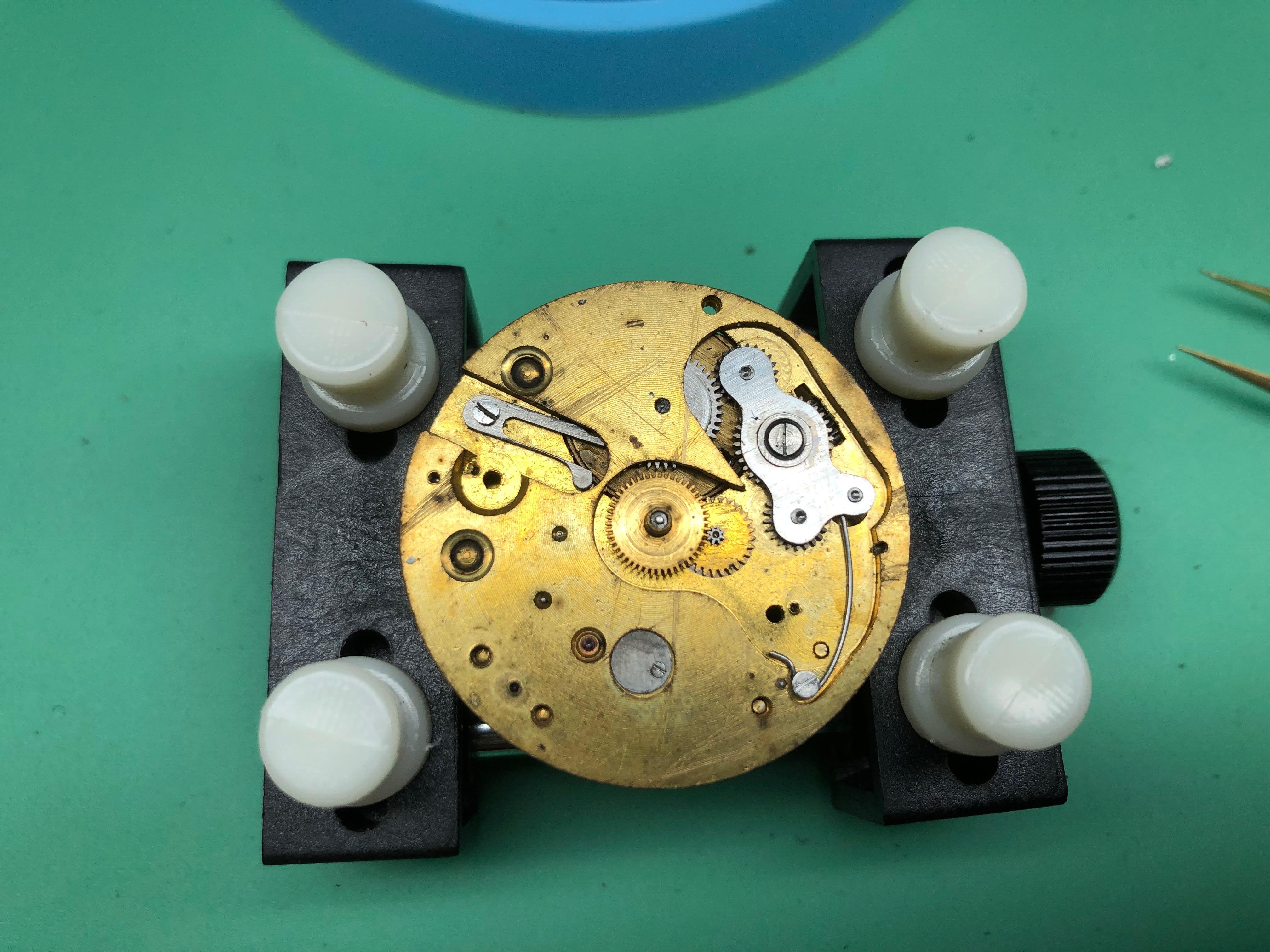

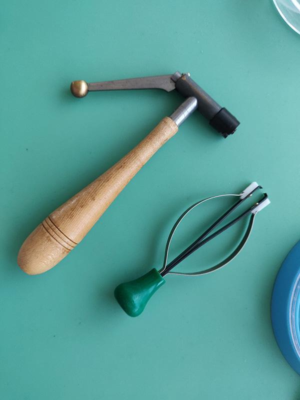

The pinion I can't get off... same as the 1é one... think for this part I need a pinion remover tool? Or is there a other way?
Need also to order a second hand, this one is missing.
Dosn,t the canon pinion need to turn on center arbor in set position? So,
I see no need for pinion remover tool.  A droplet of penetrating oil on the center arbor and pinion, let soak for day or two, push on the center arbor from the dial side down, if didn,t loosen, you may at the last resort tap on the arbor gently to break it loose.
