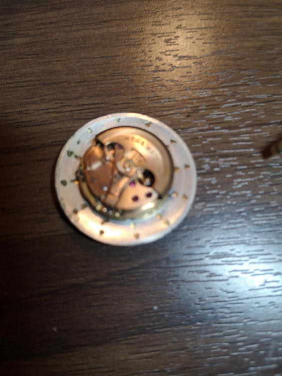

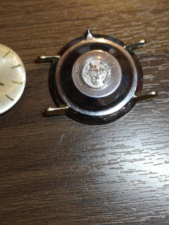

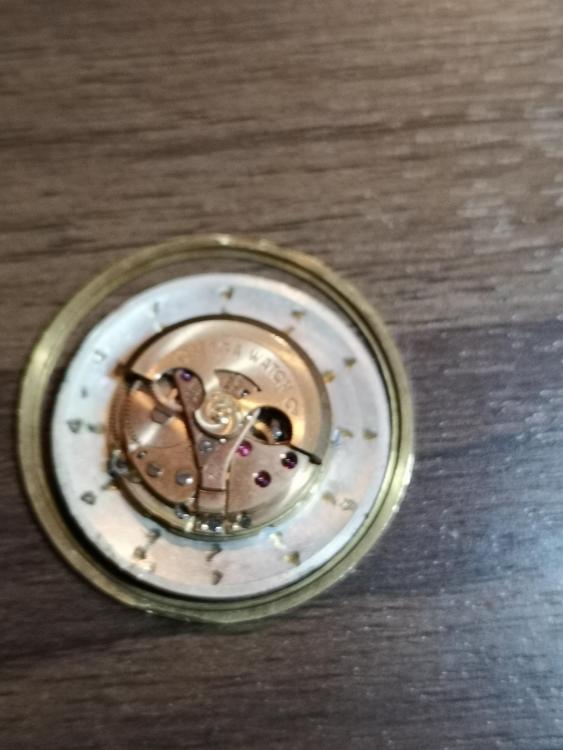

I'm fairly new to omegas only been looking at them for a couple of months.
But i think i may have a fake.
It just don't look or feel right.
calibre 671
movement number 214543355
case number 165004.
It might just be me, but it looks like its been cobbled together.
Here's some oics
sorry there not the best.
Any opinions would be helpful.
be lucky
gary
Its a mid size Omega Seamaster Deville  from the mid 60's it looks legit, it is missing its seconds hand but the hour and minute hand look correct, the dial has suffered a bit over the years, it has a lot of service marks scratched into the back of the case I think this watch is all present and correct apart from the seconds hand.
