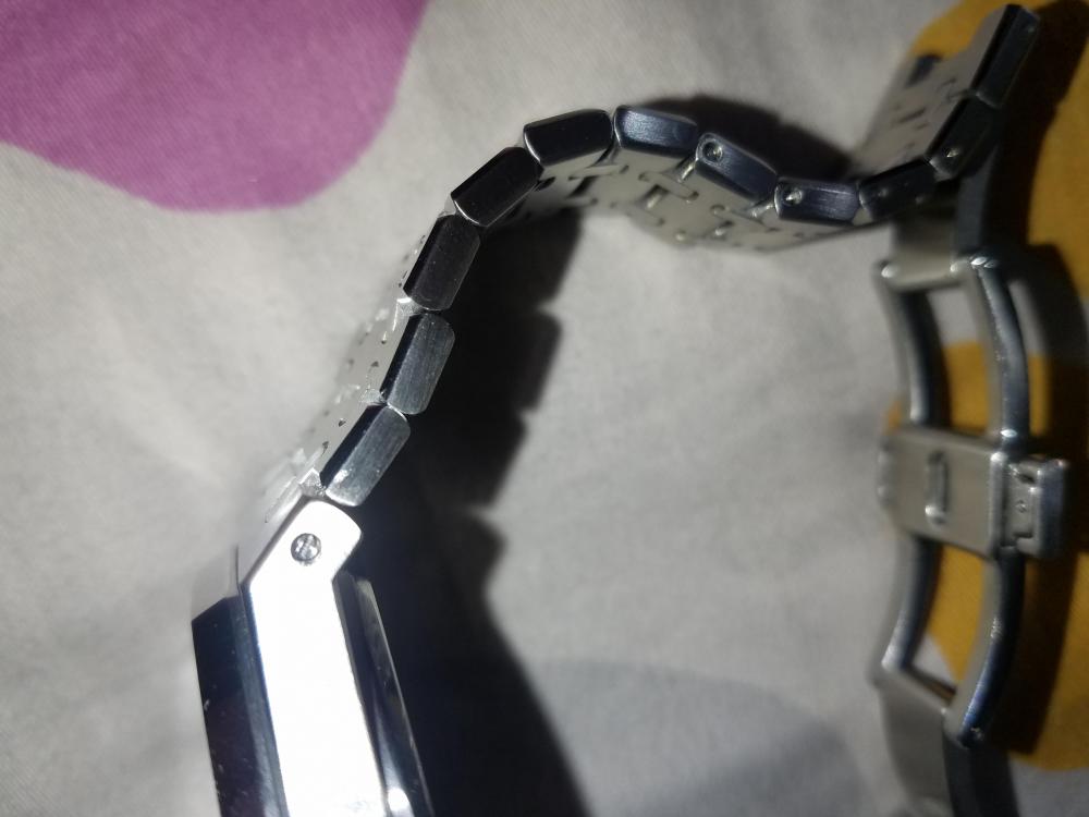

So I just bought an AP replica and noticed that it has a manufacturing fault?

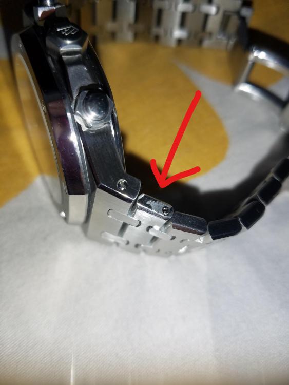

It has a hole for removable link where is shouldn't be, it was loose and I lost the original one. What you see in image is just a temporary fix. Now what the problem is that the watch has hole on one side and on the other there is no hole the metal is flush as it should be. The small metal link on the side that is okay if in place but when this pin is removed the link on the side of pin comes loose. This is a picture of watch flipped over.
Now how can i get it fixed cause this piece of pin can come out anytime.
You could use a small drop of screwlock to hold the pin in place. This is easier to remove than superglue.
Does the hole have a thread bored anywhere or is it just a blank walled blind hole?
If you are feeling particularly adventurous you could tap the steel at the open end with a suitable thread, then cut and chamfer a matching  pin and thread the screw head end of that. You would of course need to have taps and dies of the correct sizes.
If that seems like too much work, then threadlock or some other glue might be the least painful course of action.
You could also tap in a sleeve of some sort to hold the pin head in place. It all depends how neat and tidy you need it to look, and what tools and resources you have available.
Thank you for the answer Andy. No the hole does not have a thread, as I mentioned before it looks like a manufacturing fault which isnt supposed to be there as this is a non-removable link. I also thought of using some kind of glue to keep he pin in place. I think I will go for that instead of being adventurous.
You could also fit a pin, then blank off the hole with a metalised epoxy (JB Weld SteelStik Epoxy Putty Stick or whatever you can find locally). If done with care, and if the colour matches well enough, then the hole would effectively vanish with a little light polishing.
Definitely a good advice.
In place of the metalised epoxy he can use some silver solder paste and a pen-torch ... when polished the silver solder will become almost invisible.

If you have the epoxy, then mix a small sample up and let the sample set then try polishing it with fine emery paper and judge the results from that. If it is a good colour match, then go with that, otherwise go with the silver solder. You could combine the two and epoxy in a small piece of silver solder, then finish the end of that flush with the band.

I've had a look at your bracelet and it seems to be brushed finish.
So you just have to finely sand the protruding solder flat with 500/800/1000 grade paper, then you redo the brush finish ... all over the bracelet side of course so that all the links have the same finish.

If you, or a professional intends to actually solder it, it would have to be silver solder.
Old fashioned leaded solder and common or garden "electronic" lead free solder (tin based) will not stick to steel, and certainly not to stainless. I'm not sure where "here" is, but in for example India, which I'm fairly familiar with, I'm sure a fairly run of the mill Jeweler would be able to do the job for around the $5 mark.
