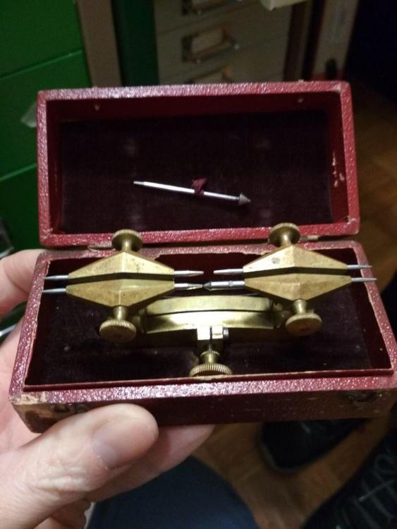

Help Identifying Tools
JBerry
Number 2 is a depthing tool plenty of descriptions of use on google and you tube, 3 are oil sink cutters, used when bushing a clock and a shallow round depression needs to be cut around the pivot hole to retain oil on the pivot. Can also be used on non jewelled watch plates when they are rebushed.
Thanks very much!
