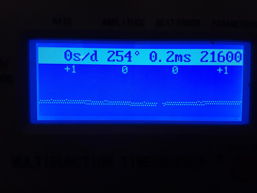

I finally got around to opening it up. It is the "C" version. I cleaned it up with a blower (didn't see any hair or particles), regulated it again,  checked it on my timegrapher. It seems to continue to be slowing down, but not by as much as before.

22 minutes ago, meanoldmanning said:
That amplitude is pretty low. Should be nearer the 270 range minimum on a fairly new 7s. Right there suggests something ain’t right.
Actually amplitude varies a lot even among relatively new Seikos, like the OP one. 214 deg is not stellar but still acceptable, one should check with a full winding at the barrel screw. 270 deg. is really rarely seen even on brand new ones, but what you will certain find on these is an average of 0.5ms beat error, and 10-15 sec/day fast rate,
And good luck finding that something which "isn't right" to cause low amplitude, believe me .. I've tried.
Edited by jdm
214 isn’t acceptable in my book. I don’t have many of them but none of the half dozen or so I’ve had have such low amplitude, at least not when anywhere near full wind. All of the NH3x and 7s26/36 I’ve had run at minimum at 270 +- a few degrees. Even the old 700x series mov’ts I’ve worked on wind up closer to the 270 range than not.
And yes the OP needs to wind at the barrel screw, not by swinging the watch x number of times.

Then you're exceptionally lucky with your collection. Here's a random pic from my archives, that is a an Aug. '11 unserviced watch.
Do you work on Seiko movements? If so you could perhaps share some tips to increase amplitude, that is certainly one parameter in which they are inferior to the Swiss. That is, until one realizes that they are sufficiently accurate anyway.

Then you're exceptionally lucky with your collection. Here's a random pic from my archives, that is a an Aug. '11 unserviced watch. Do you work on Seiko movements? If so you could perhaps share some tips to increase amplitude, that is certainly one parameter in which they are inferior to the Swiss. That is, until one realizes that they are sufficiently accurate anyway.31264674738_78cb338aa5_c.jpg&key=8059c66a0c72ffab6c9fbfe65b6df4b0f836f7e0cba3c89d5440afa5e89fbf7f
Yes, it’s pretty much all I work on. 63xx series, 700x series, 7s, some of the smaller mov’ts from ladies watches, 754x quartz, etc.
The common understanding is Seikos run at lower amp than Swiss but that’s usually misunderstood in my opinion to mean dismally low amp like in the OP’s post. Even the old 63xx mov’ts I service wind up running around 250+ otherwise I start over. Cleanliness, pivots and jewels in good condition, proper oiling. QC from the factory seems to be pretty low for sure, I’ve seen photos of brand new 7s mov’ts that are way over oiled with oil migrating from the pivots in the winding mech. That doesn’t benefit anything
Here’s a 6349 I serviced recently (40 years old mov’t).
