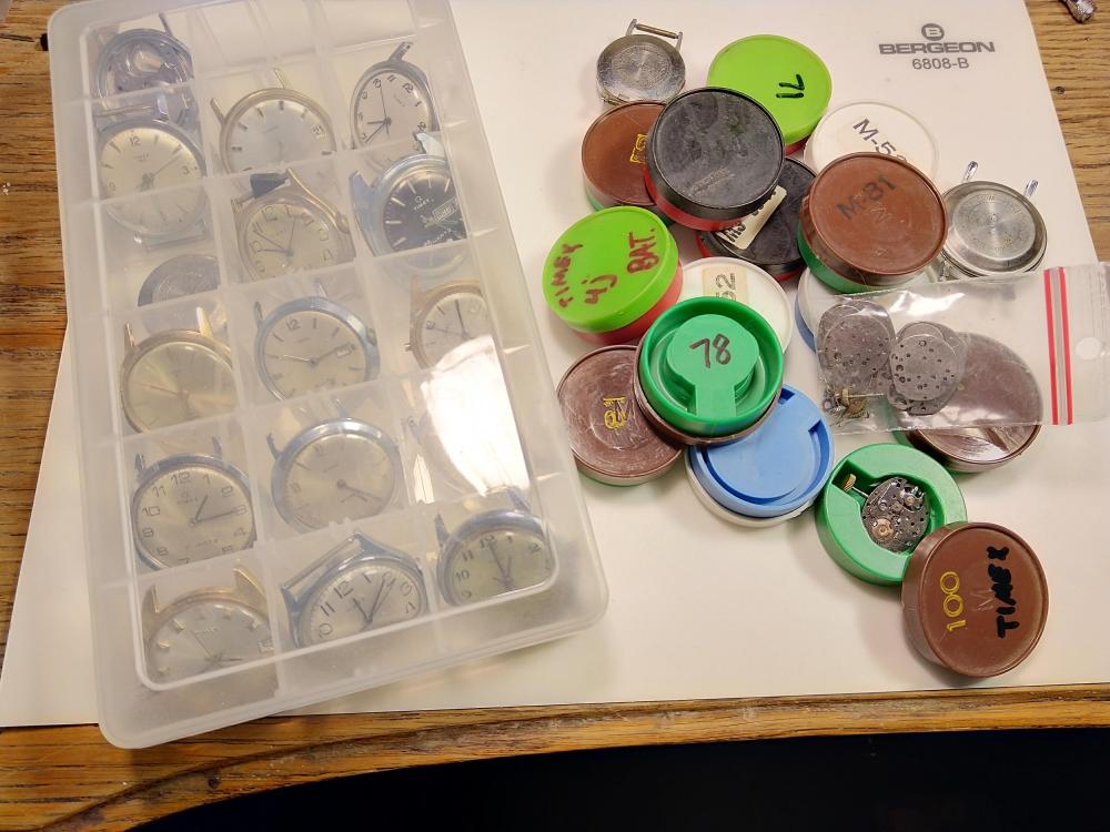

I must say I enjoy this thread very much and of course when presented with a challenge like that one have to rip out some movements to check .. But as expected I didn't find any.
But one though run my mind, there must have been some kind of service on these watches, why would there be loose movements and watch glass to buy otherwise? Maybe the service was to rip out the old movement and in with the new  :D
Posting a picture of some of my movements without rivets on both sides.... ;)
