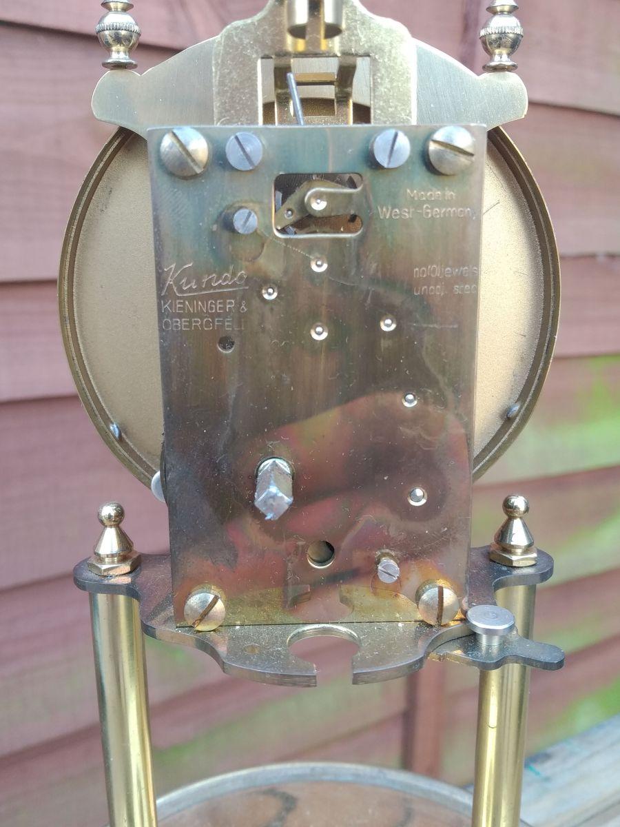

Hi   I have Terwilligers 400th edition and a look at it, there are many Kundo 400 days  The best thing is if you can post a clear picture of the back plate we can hopefully identify the type from that and then scan the relavent page for you.  hope that is helpfull for you      cheers
Hi, aww... I forgot to click on the "follow button" so I have not received a notification about your post and just opened a new topic for it: kundo Thank you for the offer, I believe I have the same movement as Mattaphysics:
