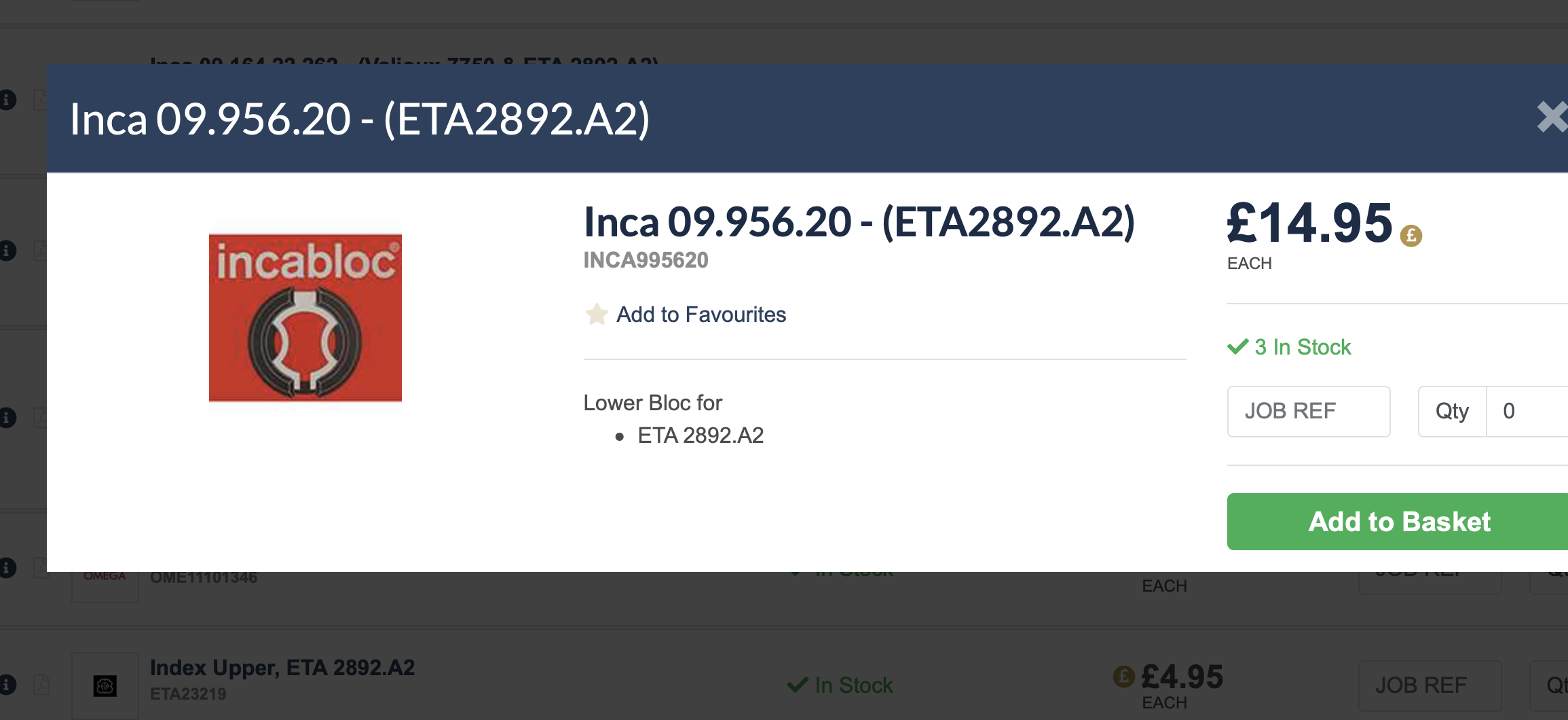

Working on a 2892-2 yesterday and I sent the balance lower cap jewel into orbit. :pulling-hair-out:
I have two options and I'm struggling with both due to lack of knowledge.
1) Buy a new Seitz jewel and fit - When on the cousins website https://www.cousinsuk.com/category/jewels-seitz all the cap jewels bar one type are obsolete am I looking at the correct section? Can anyone tell me what size jewel is used in the lower block, I would measure the top but ive heard they're different sizes.
2) buy a new lower block and remove the cap jewel, is this one correct, shows as 2892a2, assuming they're the same?
Thanks for any help

Give Gleaves a call https://gleave.london
They are on WhatsApp if you use it 0207 253 1345
That site is really good, fair play to them for taking pictures of every part. I will definitely use them when possible.
I found these on cousins by chance so I’m feeling relieved
I also ordered a container of the mixed jewels as suggested so thanks..
