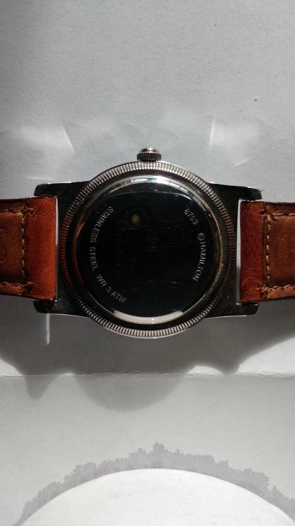

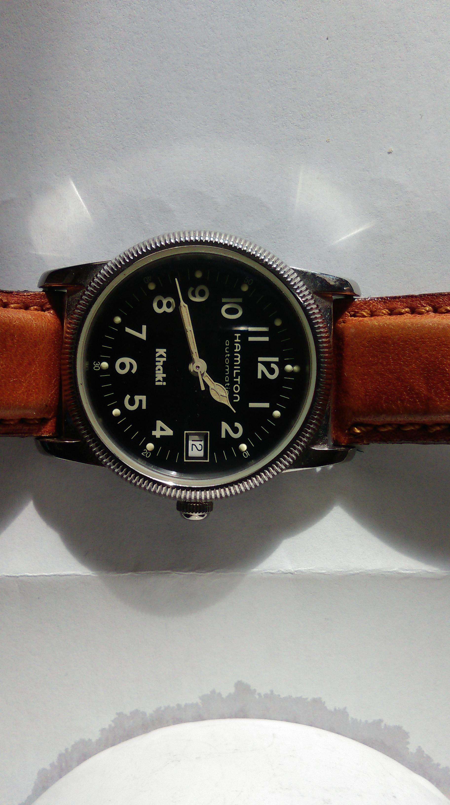

How does this one open?
I’m not sure so this is guess work. A case knife around the red arrow edge. Alternatively, what looks like a Rolex grid mark around the case green arrow, so you will need a case opener that would achieve it?  I do not think it comes out from the front.

    • Two pins or screwdrivers angled out slightly, pressing through from the barrel centre from the opposite side so they contact just clear of the hole in the lid? eg. Strap pin driver needles or similar.
    • That's a good idea - shrinking down the nut and wrench size from the old casebook trick!
