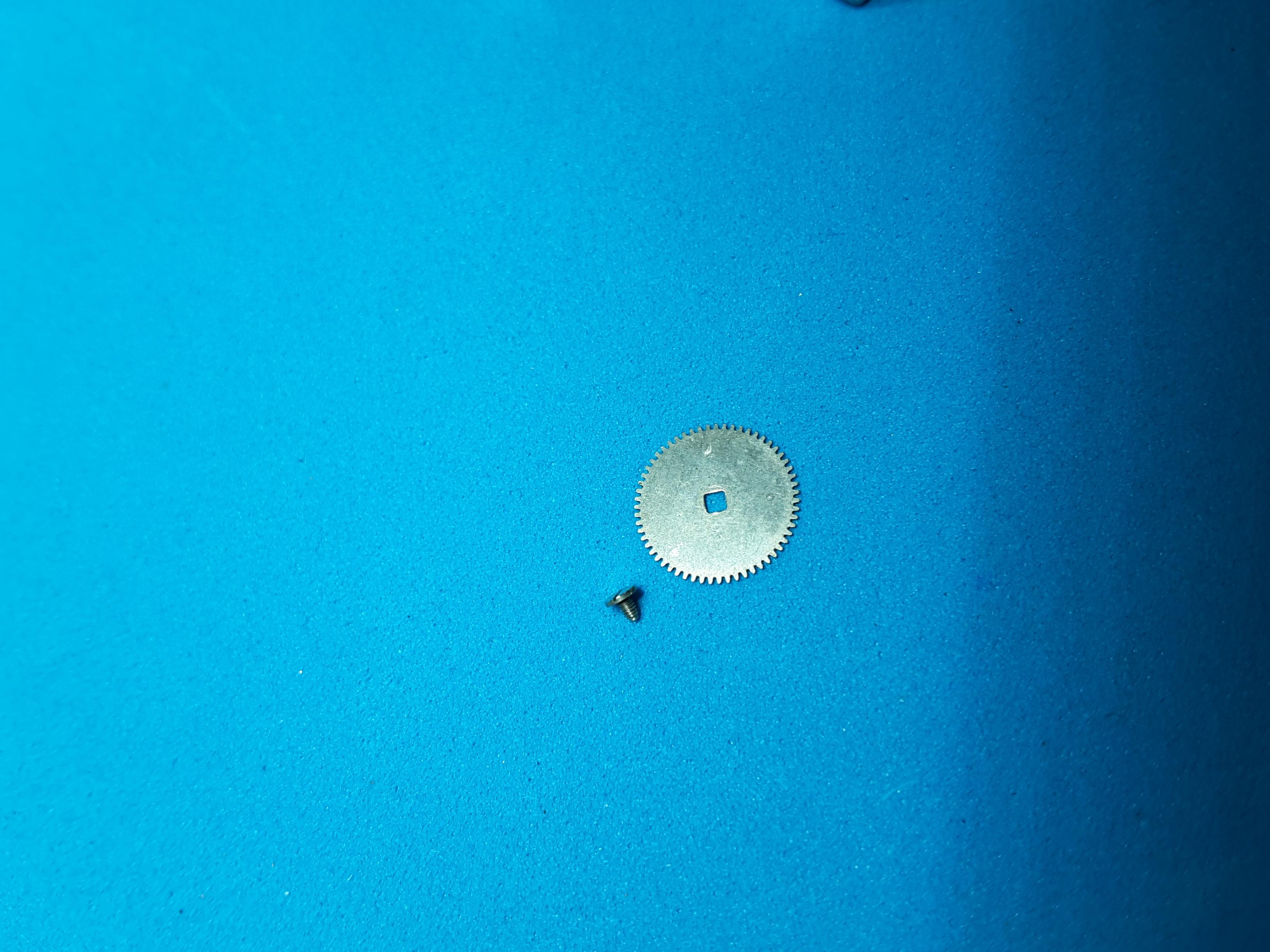

@Nucejoe
Hello Joe, having experience stripping down several 8110A movements. Can you tell me if to two screws in the photo below are left hand thread?
There is no mention of LH in the BOM or schematic, but I have had an experience (a bad one) with these three grooved screw heads on a Seiko.
I pretty much have the Cal stripped ready for the washer, but though I better phause and reach out before making a mistake I regret.
The screws are: Ratchet Wheel and Piller Wheel
Thanks in advance,
Will
Sorry for late response, internet trouble most of the day.
Lucky johnR and others were available. But looks like they didn,t get there in time either.
Yes the three slot is indicative of left thresds, that is so the screws reamins tight. Same with automobile wheel bolts.
Both broke?
Merry christmas in advance that happy ocasion you wouldn,t want to screw up.
Another pain is the chrono push buttons, don,t remove unless faulty. The ring is a real pain keeps falling off unless you replace with brand new ones.
The keyless and chrono is a complex complication too. Take pictures and examine the works to familiarize with.
Sorry sorry.
No need for sorry, this was all my bad. John had responded in plenty of time, the problem was LEFT on the brain. I moved from the keyboard to the ratchet gear and turned to the left to loosen, Wrong!
Fortunately, only the barrel arbor and I’ve already fished it out. The piller wheel went fine when turning to the RIGHT.
Only loss was the screw and the parts are in the cleaner now.

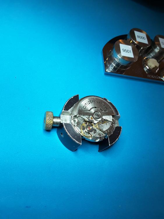

Well Gentlemen & Women,
It is kickoff day for a new assembly (ASSY) of a Citizen 67- 9011 Chrono Bullhead. Using kickoff loosely as I started some 10-14 days back with disassembly and finding a broken mainspring which took some time to find. I had tried to buy 3-4 of this MS (for future projects) but was told this is the last of a discontinued part of which I received yesterday.
Unlike the Seiko 6139 Cal. where there can be found tons of service documents and manuals.  I have had little luck finding Citizen service manuals, other than the part schematic kindly offered by @JohnR725 and kind advise from @Nucejoe. Thankfully we are in the age of the digital camera, of which I have long ago learned to use as an assistant to my lacking skill and crutch to my failing memory.
With 212 disassembly photos in hand (every photo is taken on three side to offset glare), along with the new MS, we start the reverse-disassembly. Thanking in advance for the gracious advise, help  and guidance I will undoubtedly fall back on while calling for help along the way.

And on the tip front, here is anther habit of mine. During the teardown I separate the parts in some type of logic (as we all do) but I will take the periodic photo of my parts tray. By photoing the tray I document what parts are where and when.  When a part goes missing I find myself going though the photos, finding the part and then following it while trying to nudge a clue to its whereabout (or at least to point of exit).
Good morning Gentlemen & Ladies attached is a quick video update on my Citizen 8110A caliber (or calibre as used across the pond). I am pretty far along on the drive wheel train side of things, ready to drop in the “Chrono Bridge”.
A couple small questions on lubrication points but other than that, straight forward.
What I neglected to mention in the video is that I am using D-5 on the lever arms pivots and friction points. As I understand D-5 is good for slow moving, high friction points which I have interpreted levers as being a D-5 application.  Alternatively one could use 9501 typically reserved for the keyless works but I have not seen it done. Lastly 9010 on the wheel train pivots.
If you see any parts in my parts tray that should have already been incorporated, please speak up.
