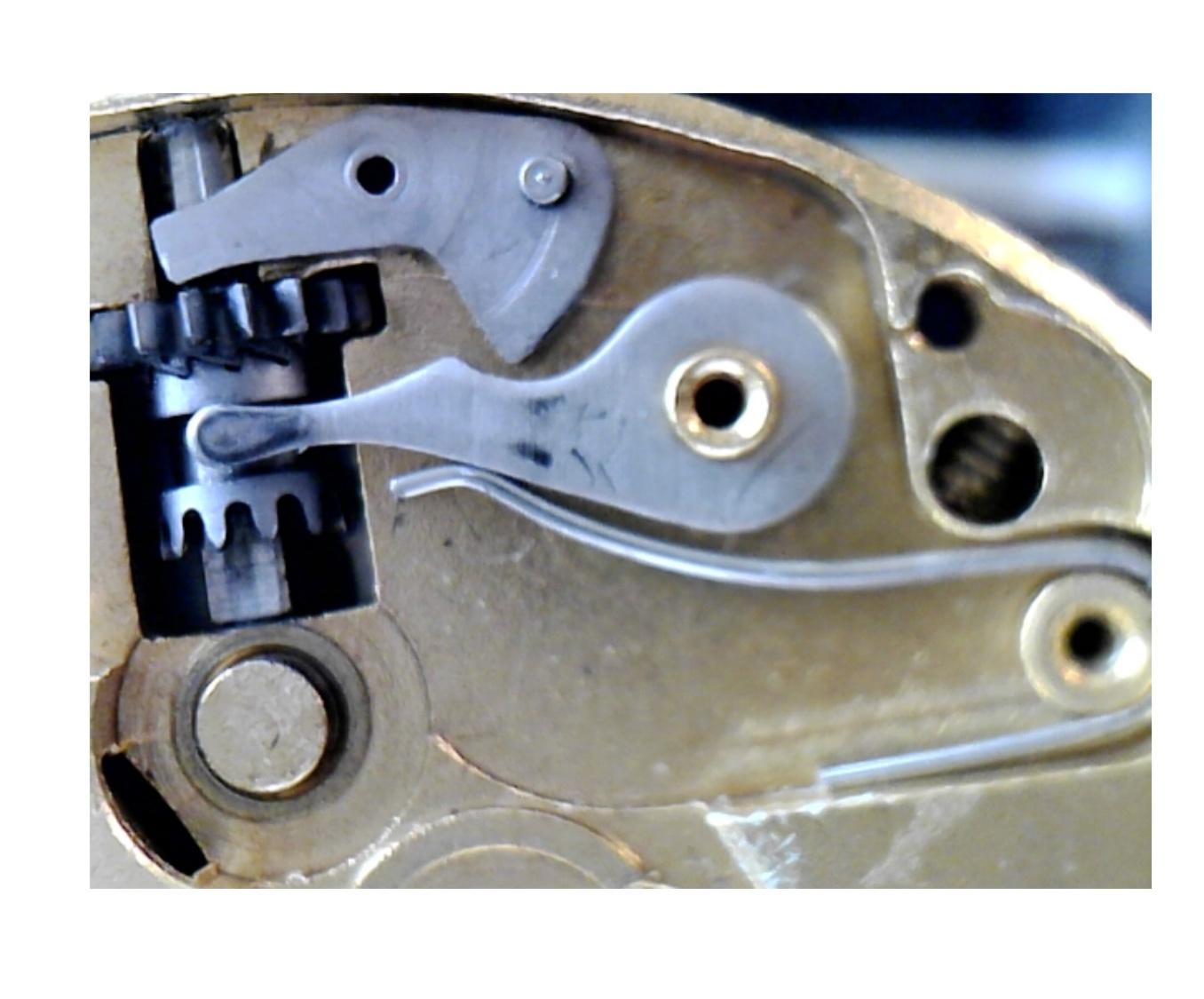

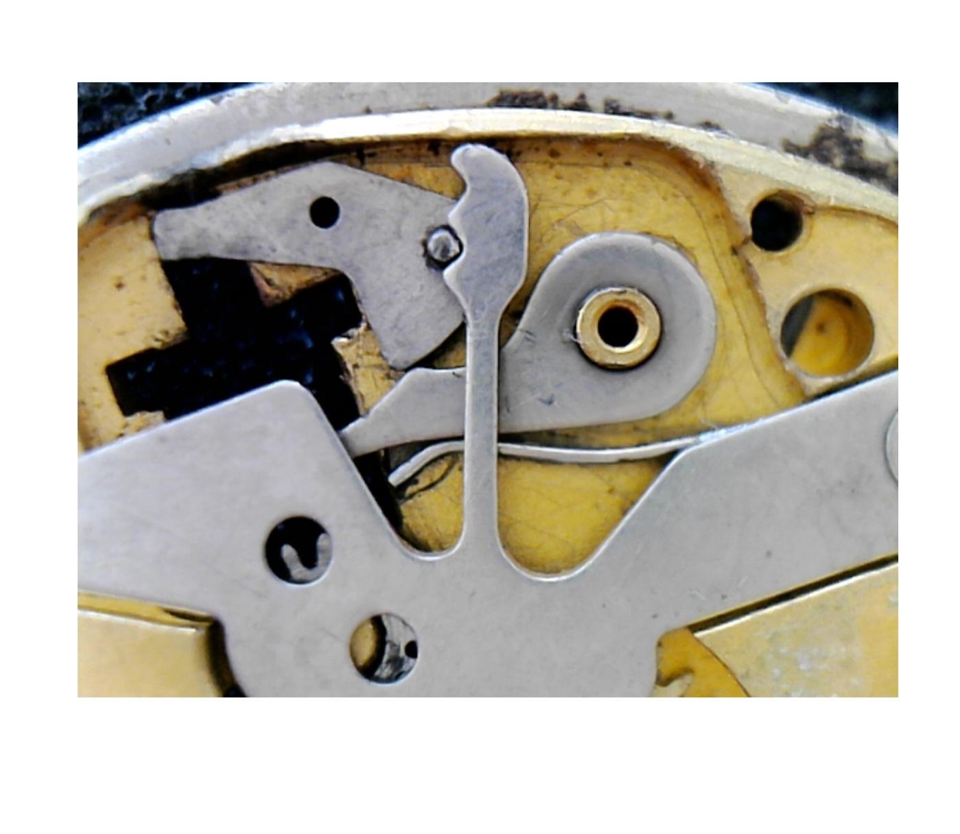

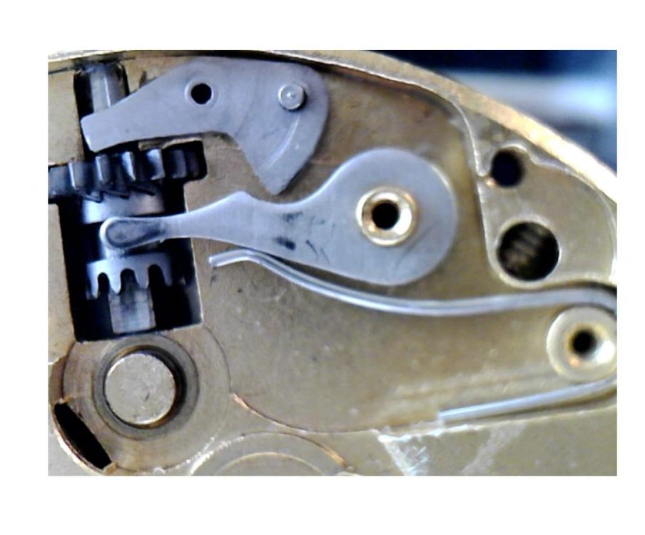

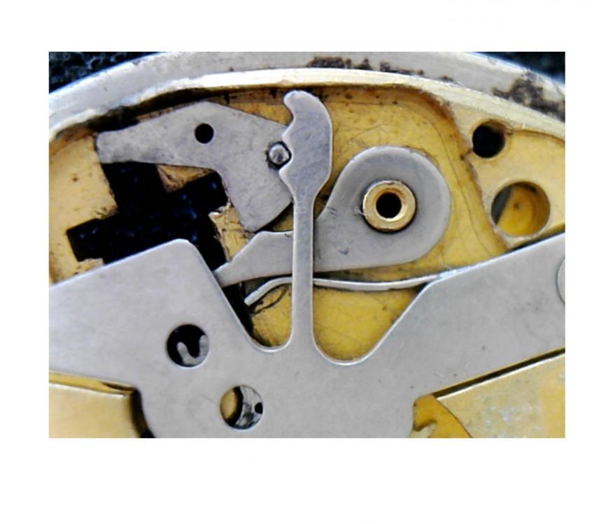

3/4's of the way through servicing a Smiths 27.CS with date & hacking and I have realised I didn't pay attention to the hacking mechanism during assemble and now I have no idea how it operates??
I can't see what interacts with the hacking assembly to move it forwards and backwards to engage with the balance wheel (which it is doing perfectly)
Also, does the return bar spring push against the tab for the hacking lever or hook behind it? Picture below.
Oh! Now I see. You were just resting the return bar spring on the setting lever while trying to figure out how it interacts with the hacking lever. At first glance I thought you placed it on the setting lever pin rather than below the return bar. I now understand the problem. I guess my pictures won't help at all because they don't show the interaction of the return bar spring and the hacking lever.
Thanks for taking the time to reply John.
Indeed, just resting the spring there before assembly.
Yes, just need to know the orientation of the spring with the hacking tab & what is actuating the hacking lever under the mainplate as it is moving correctly even without the return bar spring in-place.
Thanks
Thanks
The tail of the hacking lever needs to be compressed against the main plate, just as you show in your photo. It is easy for the spring to ride up over the hacking lever, so you must carefully insert it. You may find that it still rides up, but the cover plate will help to push it downward. There is a semicircular rebate where the spring sits which is stll accessible with a screwdriver once the cover plate is going down, in case you need to adjust the spring position. You may need to adjust the hack lever position by bending once assembled.

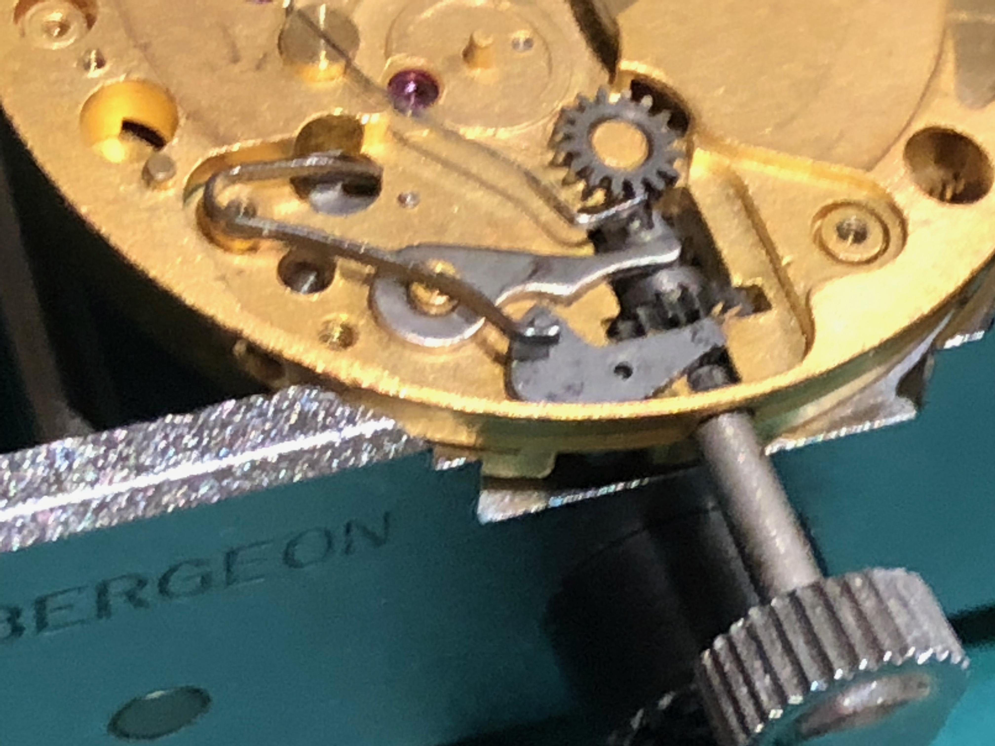

    • So I just wanted to say "thank you" again.  The angle is the key bit it seems and yes, it did basically just fall, or float, back into position when I got it lined up just right. I had meant to add that now that I see how it goes in, I totally see how it came out in the first place, and that whomever cloned the original movement didn't pay much attention to the fine details around the setting or how it interfaces with the balance cock or the "rings" on the regulator and/or stud carrier arms.
