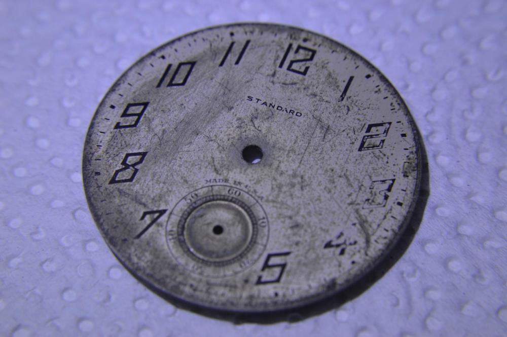

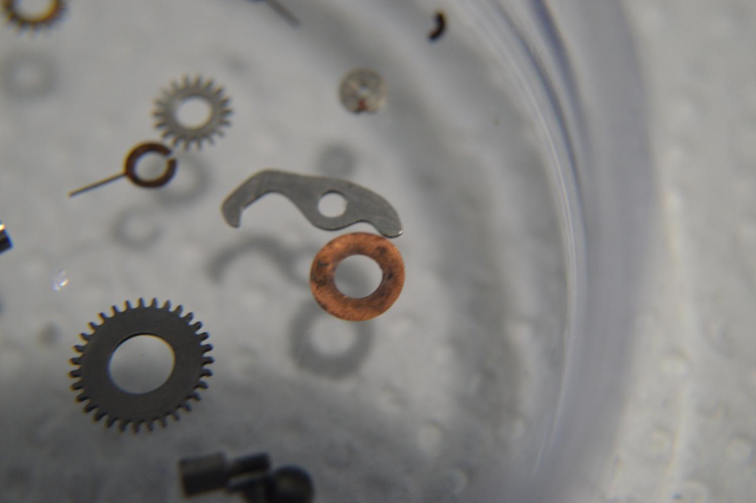

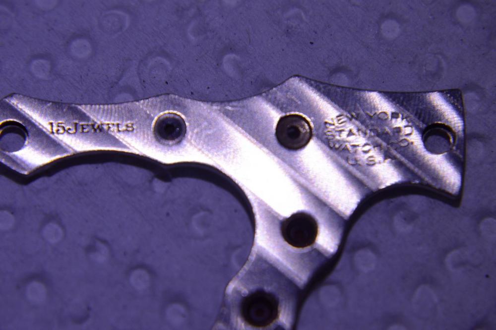

"After Thanksgiving" took longer than I thought. I have my before pictures. Looking at the parts again there isn't as much rust as I remember really, at least not on the steel parts. The lock washer is particularly well rusted though, and I'm afraid of what could happen if removing the rust either by hand or by soaking goes wrong. The brass parts seem to have fared worse. There is some rust on the "possibly nickel plated" bridge pieces but I think this is from the winding wheel and the ratchet wheel. I apologize for the picture quality, I'm working with a macro attachment to my zoom lens and a flashlight held in my other hand for higher shutter speeds. Not the best of setups.

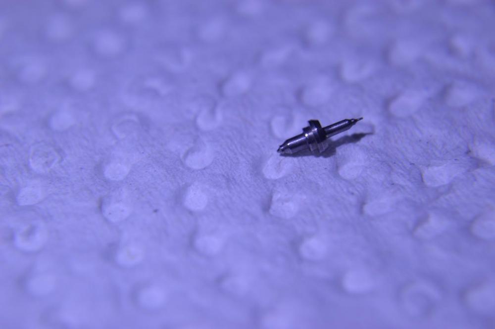

Two things I forgot to add earlier, sorry: That "59030" on that one plate, could that be the real serial number? I haven't seen any more of these watches disassembled to know. The other I think I know the answer to, but here goes anyway: Any chance that balance staff isn't broken but just "shaped like that"? I realize probably not, but it seldom hurts to ask. :)
