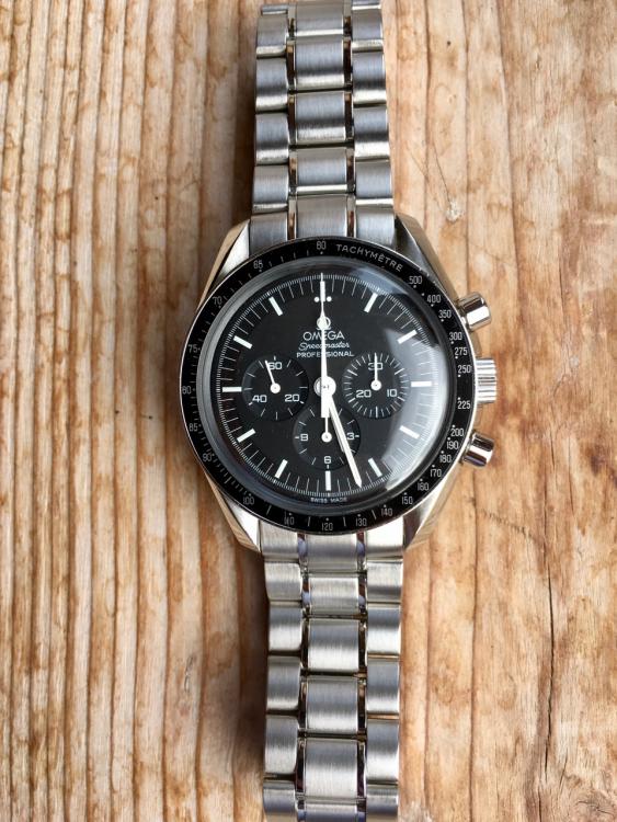

  3. it's the flight rated configuration because I'm a huge fan of spaceflight.
