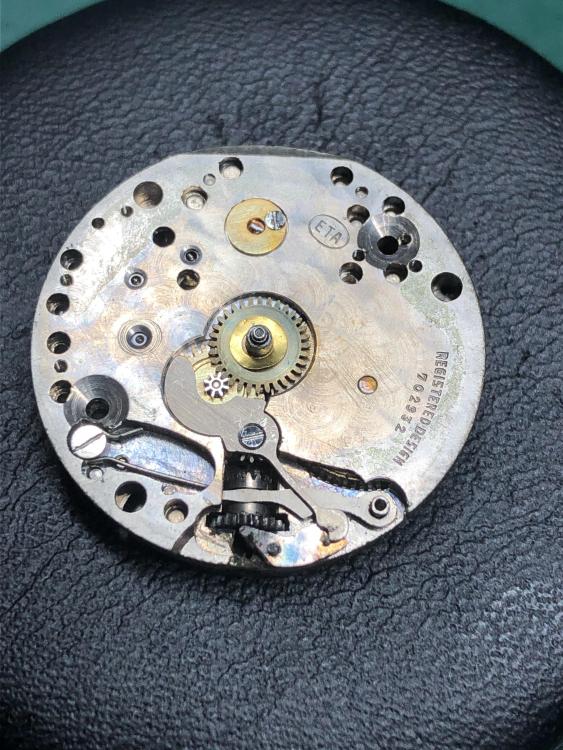

  5. Hello, Another first for me. I'm attempting to repair a friend's antique watch, and not until after cleaning did I notice a bent tooth on the barrel. The original mainspring had snapped and I wondered if any damage had occurred when this happened, but on inspection, the jewel holes all look fine, it's just this tooth shown in the photos that concerns me now. So my question/dilemma is, do I attempt to straighten it, and if so, what would be the best technique to do this without causing further damage or snapping the tooth off? I'm very much doubting that leaving it alone will be an option as I'm sure that the watch will stop when the centre wheel pinion meshes with it, though I've not actually reassembled the train yet. I guess my biggest hope would be to get a replacement barrel. I'm pretty sure the movement is from c.1928 as it has a gold hallmarked case to date it. And although I also know it's an early ETA movement, I am unable to identify the calibre (see photo). Again, if anybody recognises it, that would be fantastic. Many thanks, Adam
