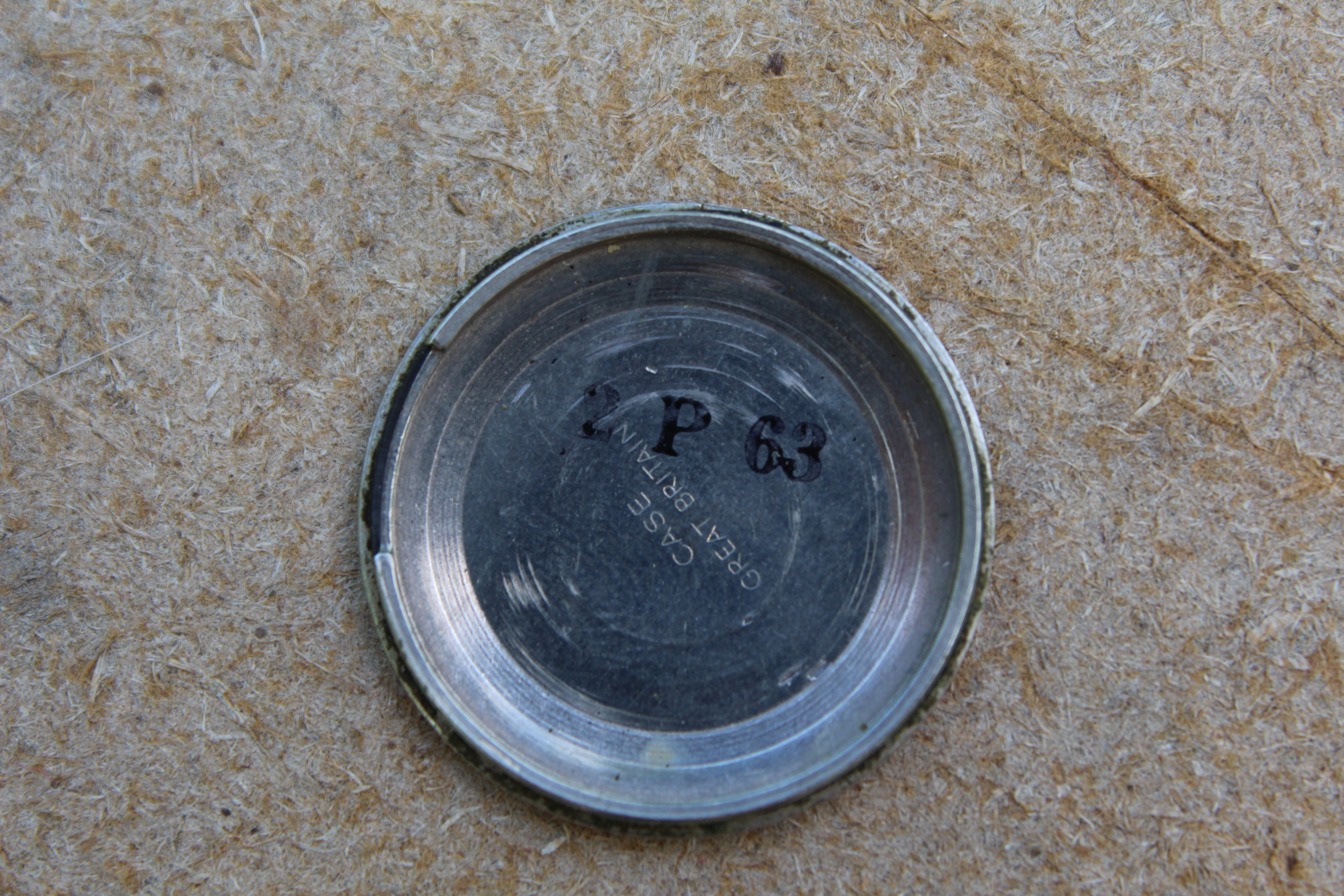

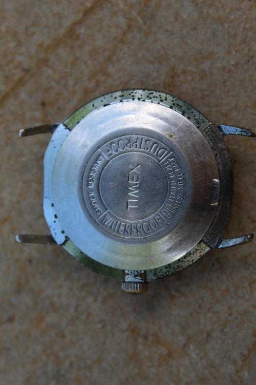

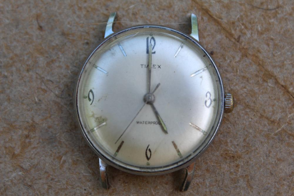

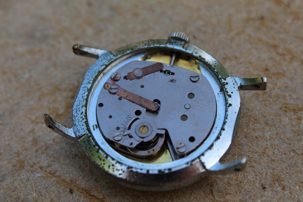

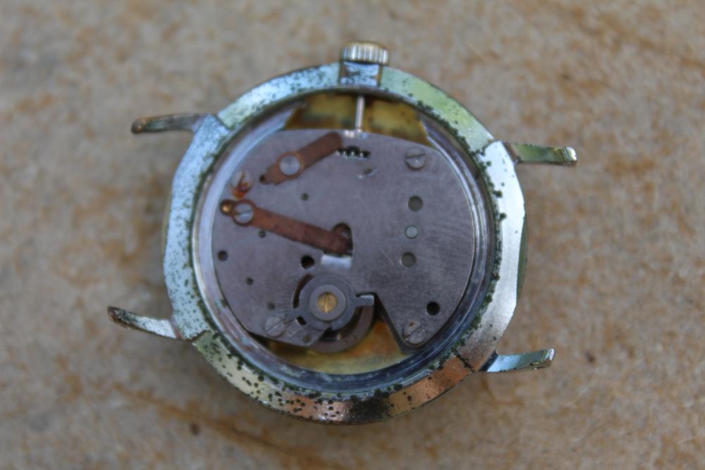

Hello I found what I think is a 1963 Timex Windup at the flea market today for $1. I've always wanted to learn more about watches, ever since I was a kid I was drawn to them. I've never tried to work on a watch but I did study Mechanical Engineering at Georgia Tech so I have somewhat of a mechanical backbone. I really have no idea where to start and I know its very easy to destroy these watches when prying into them. So where should I start? Hoping y'all can tell me a little about the watch that I found and hopefully point into a direction to restore it. I would also be interested in books about watch repair and threads on here that could help. Thanks folks!IMG_7504.thumb.JPG.23afe3d25916a2d3f2bc70b97c33e9d3.JPG
Start with another watch. Most Timex are basically not serviceable, with riveted parts, etc. Although your does not seem to be bad as my Asian Q&D, the truly disposable mechanical watch (pictures on request).
Could not agree more, not a good watch to get started on, they were not designed to be dismantled.
It is possible to take them apart (I have done one before, stripping everything down except the parts riveted together), but you will find it difficult to put back together. On the one I worked on (see pic) all wheels were on the same plate (with no separate bridges so all wheels have to be perfectly aligned- not ideal for a novice)

If you still want to go ahead with this Timex, here's what you can try.
1. remove the stem. If i'm not mistaken the stem is held in by a metal gate which needs to be raised before the stem can come out. You can see it better looking at it edgewise.
2. Remove the hands and dial. The dial usually has tabs which are bent to hold it in place. If you're not the first in there the dial may be glued into place as the tabs usually break.
3. Loosen the screw on the balance pivot a quarter turn.
4. Dunk the whole thing in lighter fluid. If you have access to an ultrasonic cleaner so much better.
5. Dry the watch off.The watch will usually start running once it dries off a bit. May need a shake to start it off.
6. You will see tiny holes on both side of the movement which are actually the pivots of the wheels, you can lube this with some watch oil. Timex don't really need fancy oils.
7. Eyeball the balance pivots, you need to get some oil in the pivots... once done, tighten the screw on the balance pivot so that it moves smoothly with minimal endshake.
8. Replace dial and hands and stem. IIRC the stem 'gate has to be raised to get the stem back in, unlike other watches where its usually just push in.
9. Clean the case a bit and fit everything back together.
Most of the Timex I've come across would usually run with the above ... the ones where water has entered with ensuing rust damaged are not possible to repair.

You've got a model 22 movement there, and #anilv's instructions are a good start. I have a lot of TImex service documentation that I am sharing here -
Timex Documents
You should be able to find a lot relevant to your watch.
