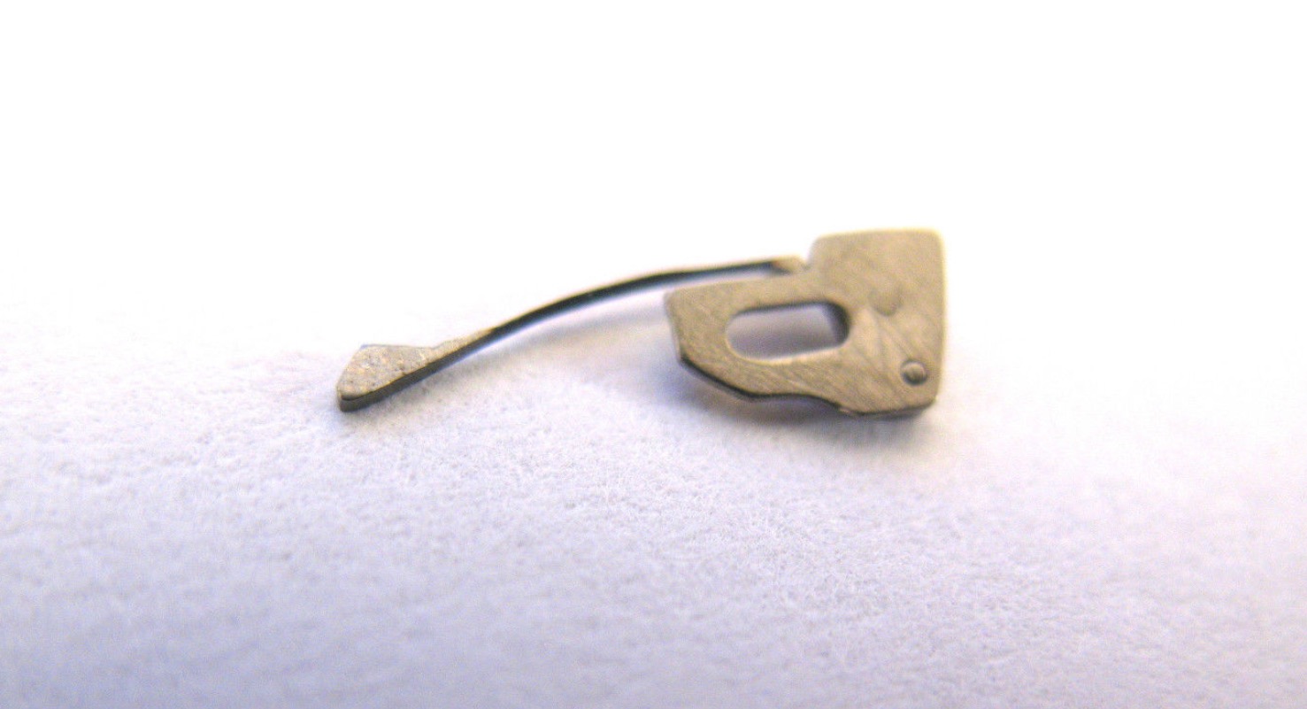

Polish it where the old part cracked as well. Get rid of the stress-raisers.
