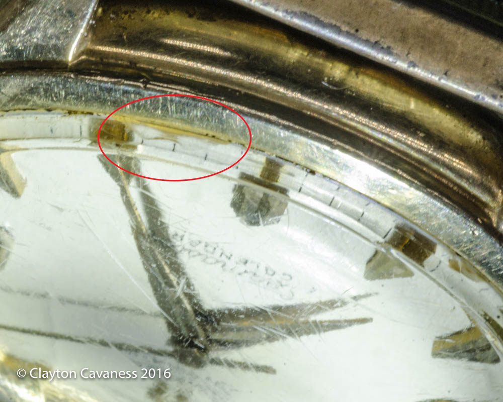

There is no omega symbol on the current crystal. The crystal does have cracks around the edge as in the photos below. I agree it deserves a good proper service.
Any help on locating a proper crystal would be appreciated. 20160802_Omega-Seamaster-502_003.jpg20160802_Omega-Seamaster-502_001.jpg20160802_Omega-Seamaster-502_002.jpg

Can you measure the crystal? If 29.6 x 4.3 could be the pz/px500 as listed by Ofrei.
[Edit: possibly not as these have a colored ring?]
I know I would probably need to remove the crystal to measure it precisely. I would rather not remove it at this time. the measurement below are as close as I could determine with the crystal still mounted on the case.
Diameter: 29.464mm
Height: 4.064mm
Also I can not find a pz/px500 on Orfei - did you mean their pz/px 5000? If so this was as close as I could find but it still does not list my 6275 number.
I was guessing the diameter might be 29.6 from all the researching I have done. I really wish I could find one I could match to the number on the case.
If you want a genuine Omega part, then Jules Borel lists it as PX5022
For some reason I can't paste a link right now, but if you search their material utilityfor the case number (drop the EX) then it comes up as CRY-1651... You then have to search their site for that part yo get the Omega number
This does have a coloured tension ring, As I believe all Seamasters from that era would have.
I would also measure first to be sure.
