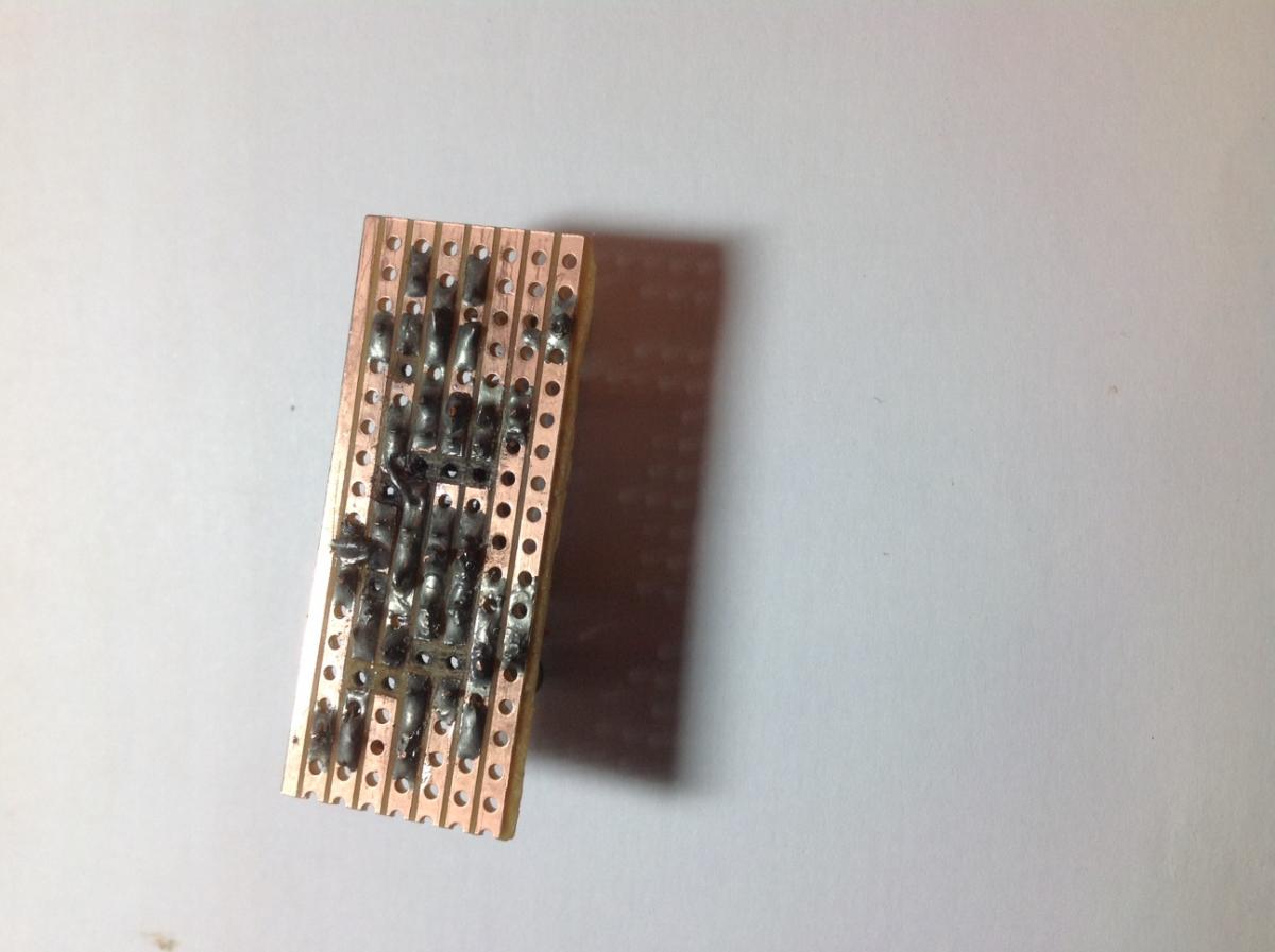

Ok here we go. I get my scrap bit of Vero board and clean it up a bit finishing with a wipe with alcohol.
Then I study Stefans latest drawing indicating where the breaks are to be made.  If there was a lot I would use my Dremel with an etching bit but on this little one I just cut the breaks with a scalpel.
Next I flip the board over and mark all the breaks on the no strip side this is easier for me to get my head around when putting on the components.
I used a DIL socket rather than soldering the chip directly so I have placed that into position and soldered it in first.  This gives me a point of orientation for all the other components.
As one of the smallest red bridges is under the DIL socket I decided to create a solder bridge.
And that’s the DIL socket in place.
Now using the DIL socket as a starting point for working out the positioning of the components refer to Stefans diagram and start methodically soldering everything in place.  I started with the red wire bridges and then moved on to the resistors and finished with the capacitors.
Continually check the tracks with a loupe to ensure there are no short circuits, a tiny bit of solder can bridge between tracks. I run the scalpel down each one and then test out with a meter just to be sure.

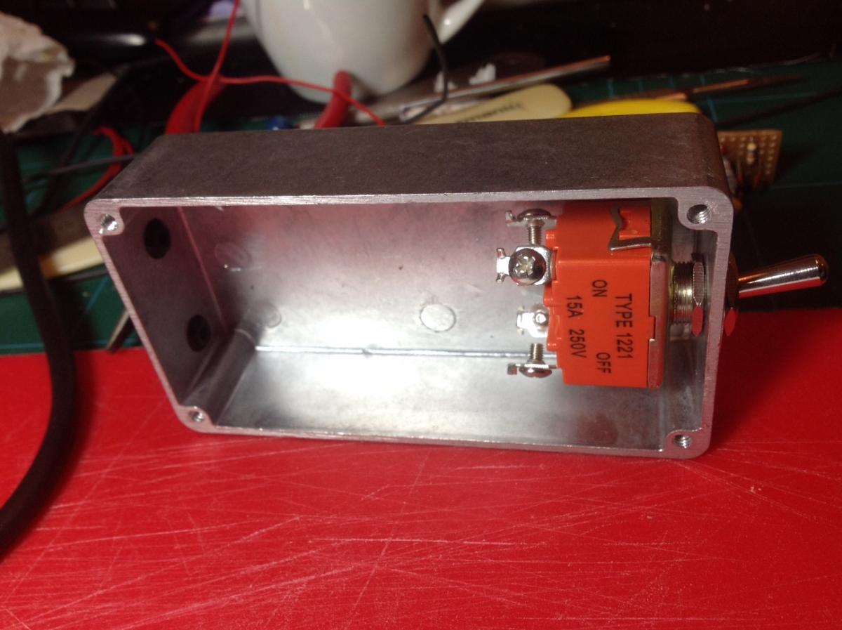

So that’s the basic board together.  Next I drilled the enclosure – I used an aluminium one.
I decided not to use Jack sockets on the box so there are two rubber grommets at one end and a switch at the other.  Through one I will lead a shielded cable for the Piezo and through the other the shielded cable for the Jack that goes to the computer Mic socket.  I will use the nut on the inside of the switch to get the ground to the box basically just tightening it on top of the earth wire.

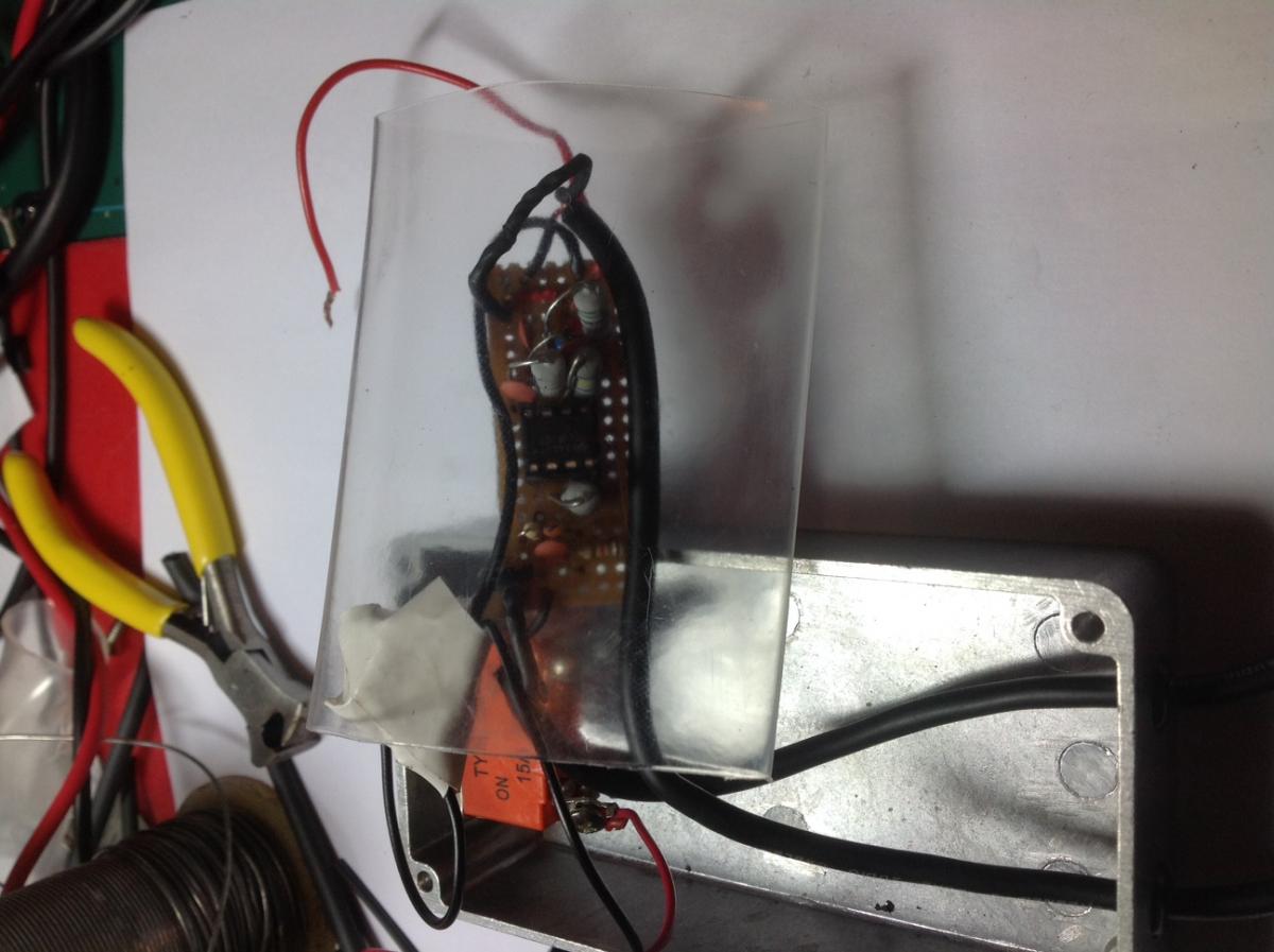

So next we have the wires through the grommets and my shielded cable has a double core so I used the red wire as my central wire cut off the other wire and used the shielding as the ground.  This is done for the Jack plug wire and the Piezo wire. (The red wire in the pic hanging loose attaches to the switch pole and is the positive feed from the battery).  I have a last check on the wiring with my meter looking to make sure all is grounded ok and it is.

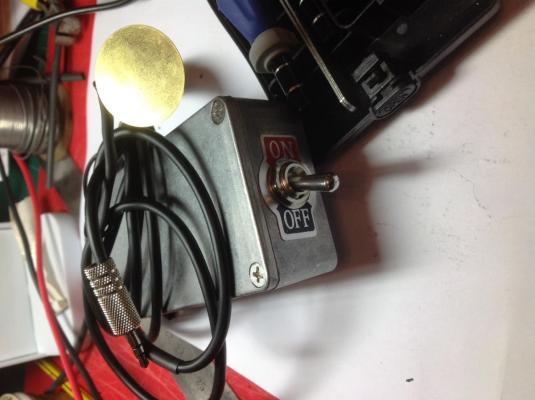

Time to shrink the wrapper with my wifes heat gun for her craft embossing.  Then to fit it all into the case.
On with the lid and that is that – now to test it.
